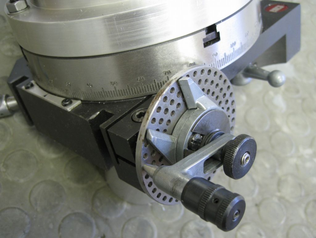

      This is a view of the stock table, with index disc etc.

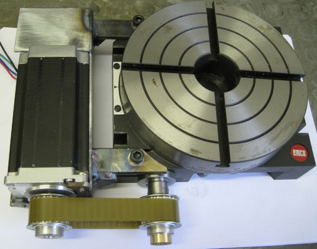

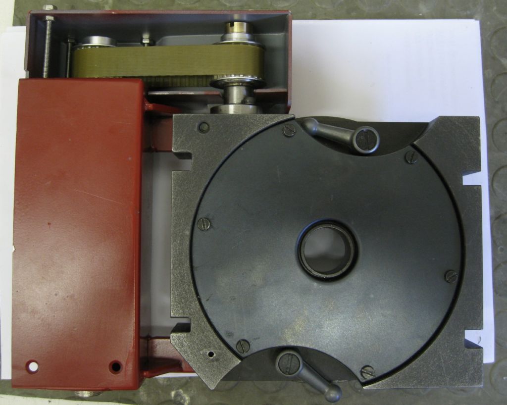

      The Worm stub external to the table is short and of not a very practical shape to attach the stepper – I decide to go for belt drive as even with a NEMA23 stepper, if the stepper shaft were aligned with the worm drive, the stepper body would protrude about 16mm below the underside of the table's base.
      That makes it difficult when placing the table on the bench, mill table, etc – spacers are needed and so on. I made an adaptor for the pulley, which includes a shaft preload to remove worm shaft end-play.
      And made attachments for the stepper to the body of the table's base.
      And painted it all up – view of fitment from underside.

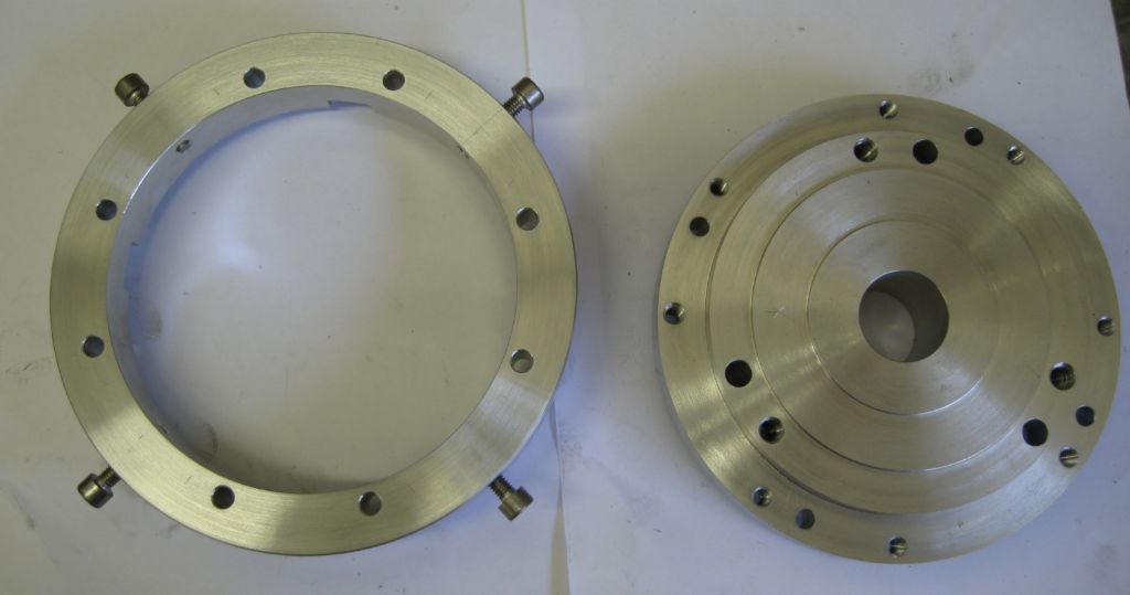

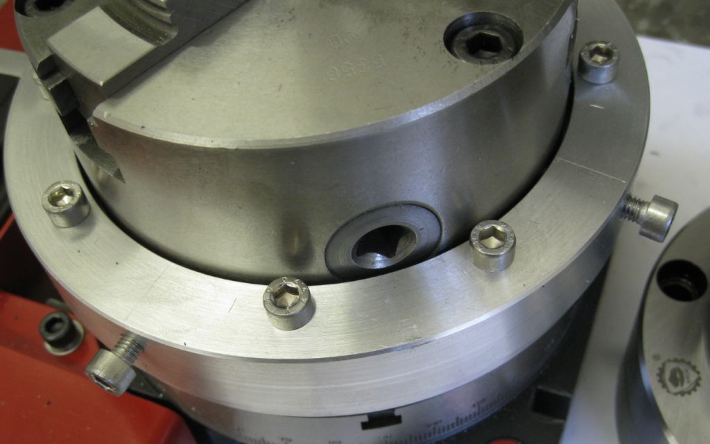

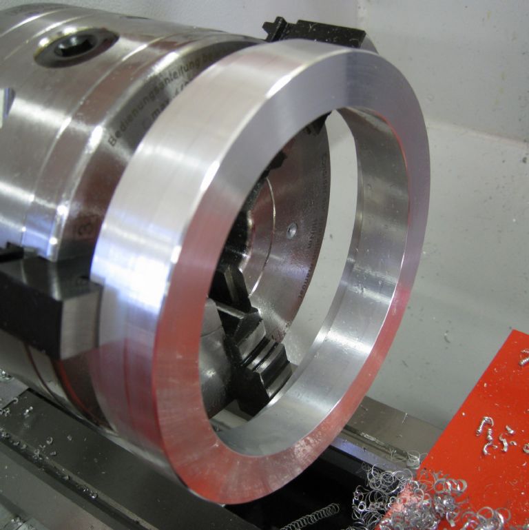

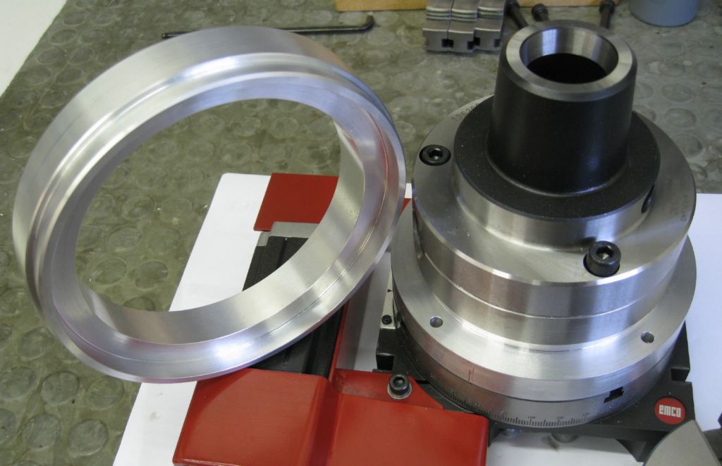

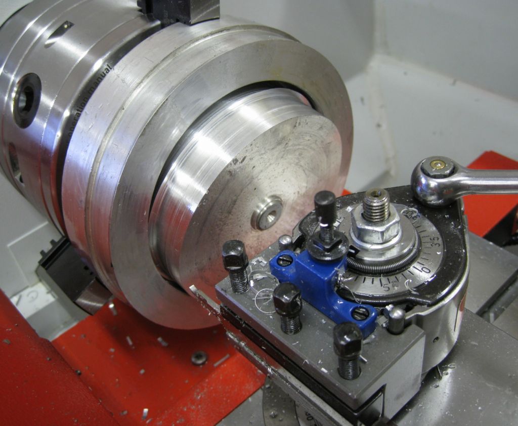

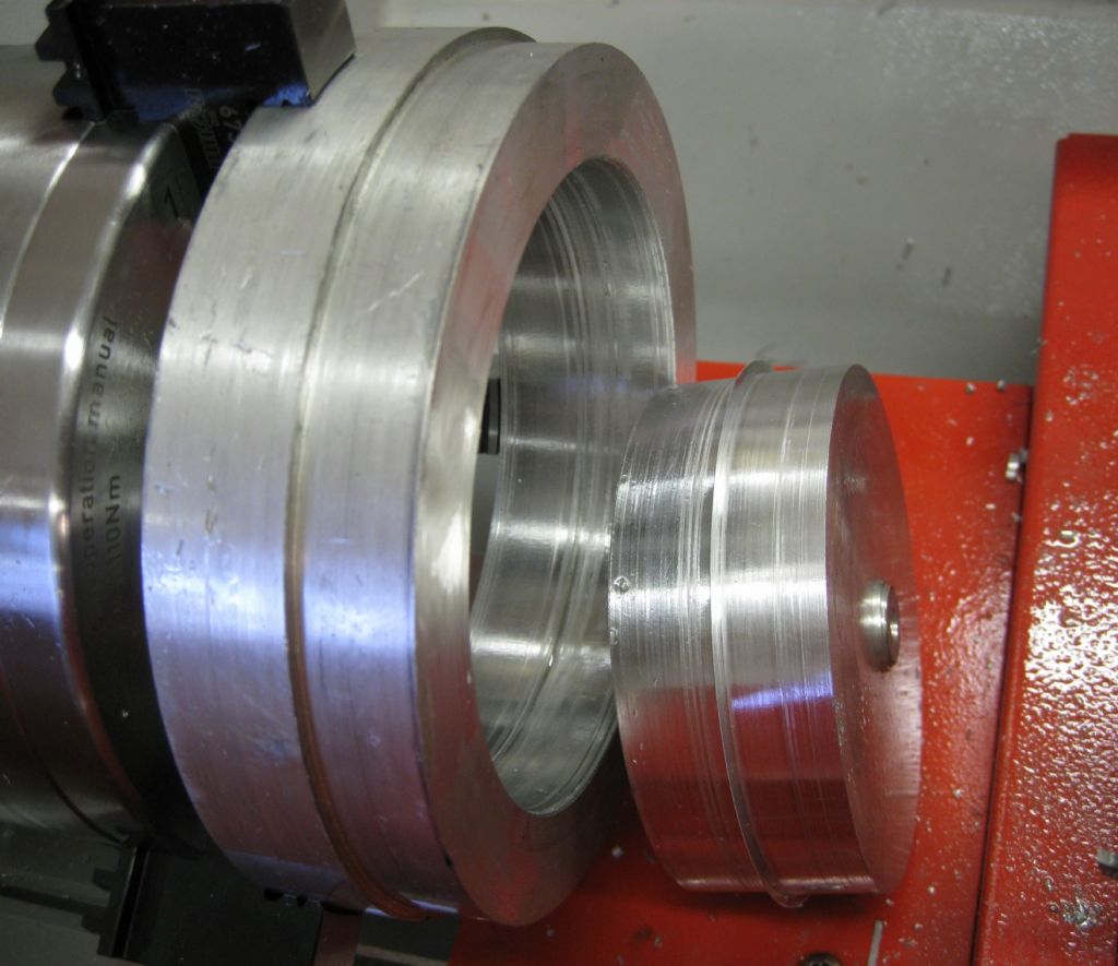

      Then the Grip-True style adjustment. First the three jaw rear-bolt chuck was drilled through and recessed for cap-screws from the front, with 1mm clearance holes. Then the backplate machined to fit the chuck recess with 1mm clearance. Then a ring was made that bolts to the backplate – the chuck sits within the ring and 4 cap-screw adjusters protrude from the sides of the ring, against the outer of the chuck body, allowing centering adjustment with the chuck body bolts just nipped up.
      The ring is 165mm OD with the centre hole 1mm larger than the chucks ( the 3-jaw and the 5C are the same diameter body and mounting hole positions) The hole is a126mm, and the ring is 38mm thick. This was made from a large chuck of aluminium, trepanning a chunck out the center to prevent swarf from taking over workshop space.
      The the ring was machined up:
      And all holes drilled – left is the ring, right the backplate

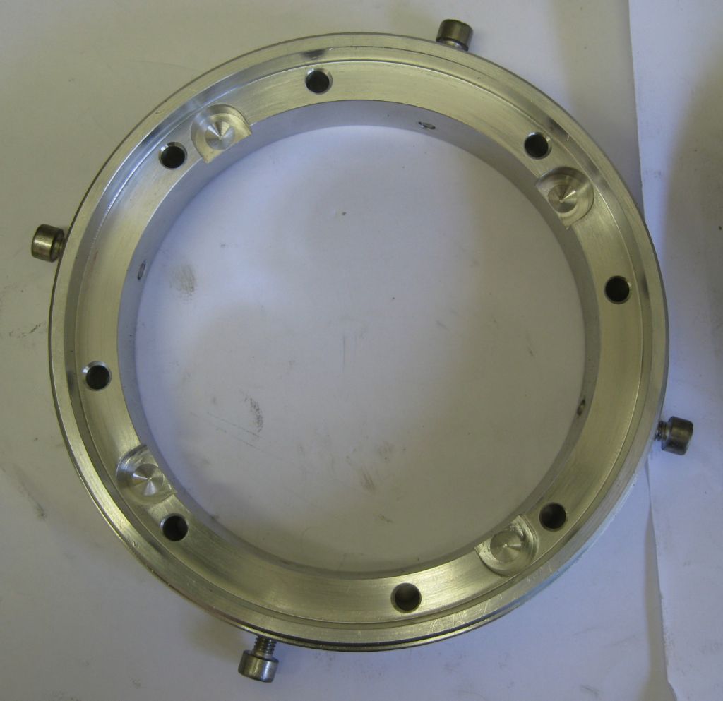

      Underside of ring – the 4 relieved half-moons are to clear the backplate mounting bolts.

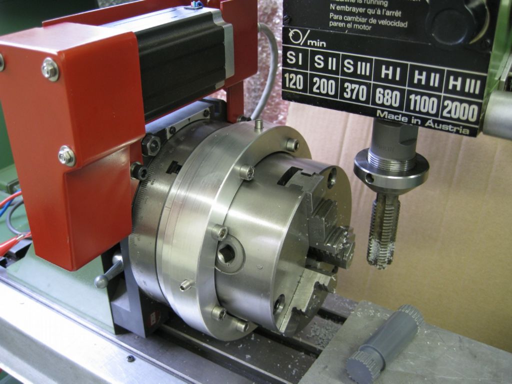

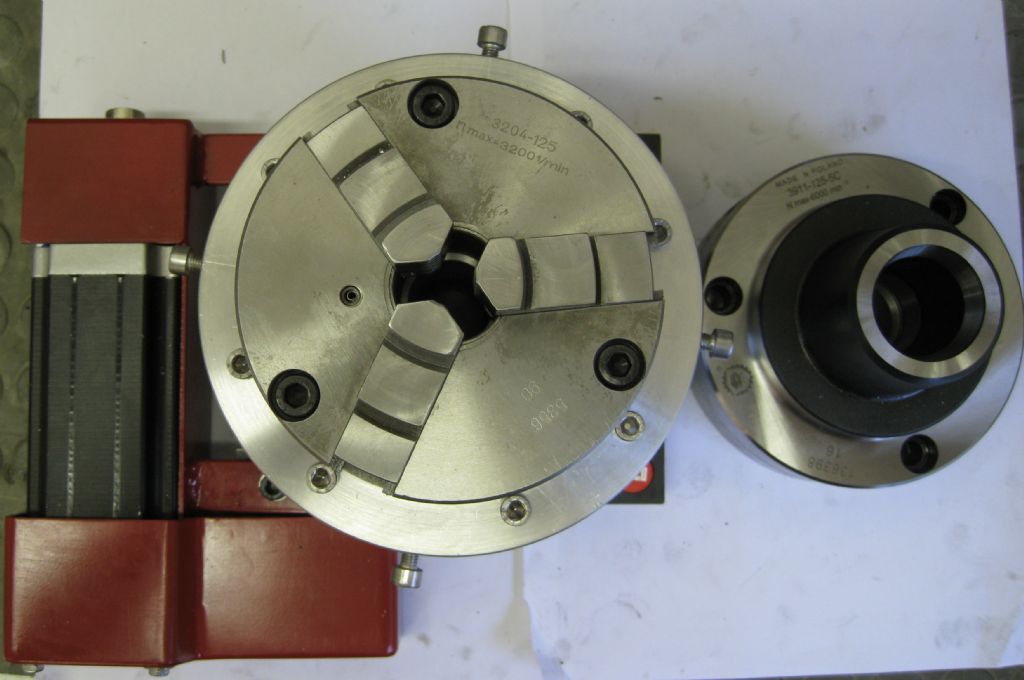

      This is the table assembled with the 3-Jaw chuck fitted.
      A side-ish view:
      And it works a treat! very easy to set a workpiece in the chuck to 0.005mm.
      Now to spin it and see what happens..

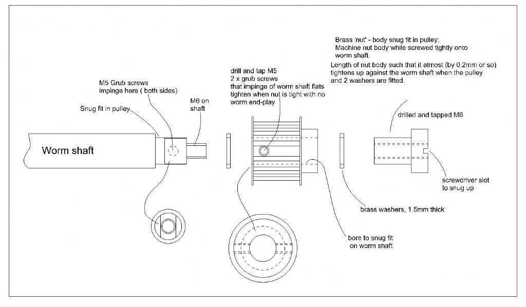

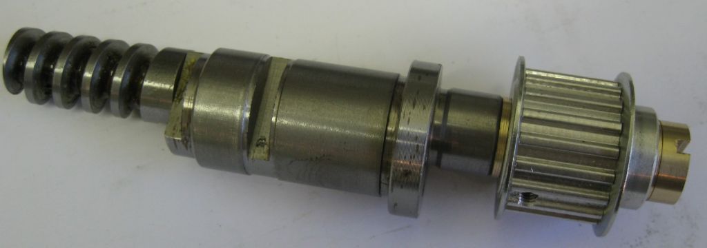

                    Joseph – Could you be persuaded to share the details of your pre-load pulley/spindle adaptor please.
                    #378234
                    Joseph Noci 1
                      @josephnoci1
                      Rod, I can try – maybe better to send you some PDF sketches since image resolution in the post is poor – but here it is …
                      And the assembled shaft again:
                      Hope it helps…If short, let me know and I will describe it more
                      Joe

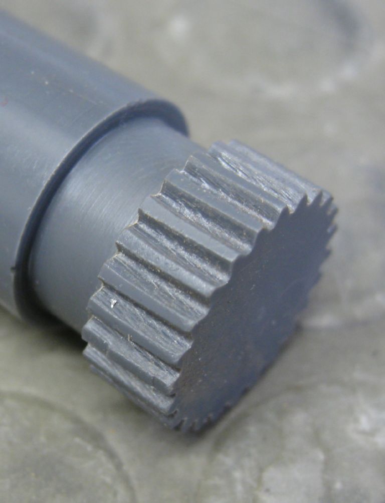

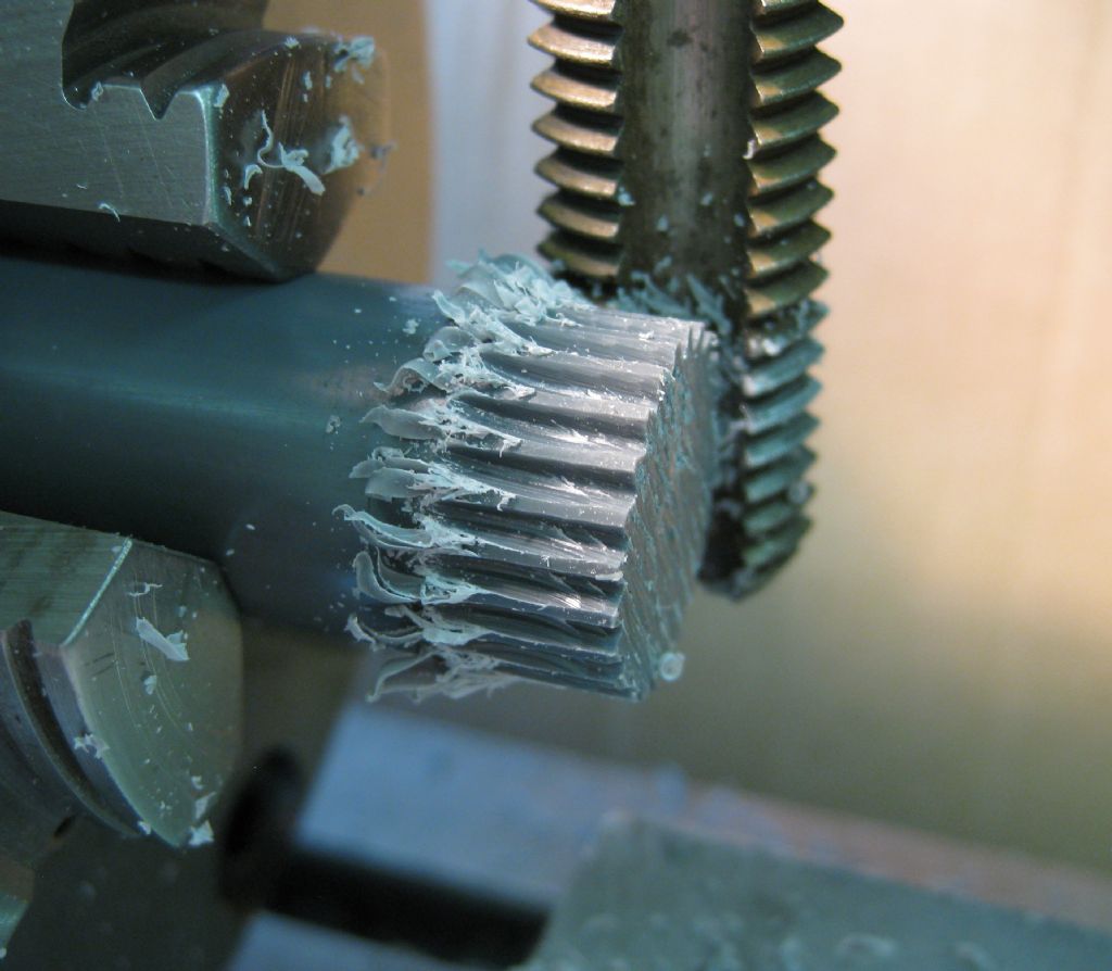

                          Well, I got the table done, the software ready to test, the electronics all hashed together and dumped in a plastic tray, so off to the workshop..
                          Mounted the rotary table on the angle plate, and that on the EMCO FP2 mill table, with a piece of 20mm diameter PVC in the centered chuck. As mentioned previously, I have no need for gear cutting with what I hobby about, so this is all a bit of mind-messing. So, to test I need a hob and the closet I have is a Big British Tap – a 3/4 Whitworth tap. This has 10 TPI, so 2.54mm pitch. That puts near enough 24 teeth ( on the pitch circle) around the 20mm plastic rod. And so off we go…

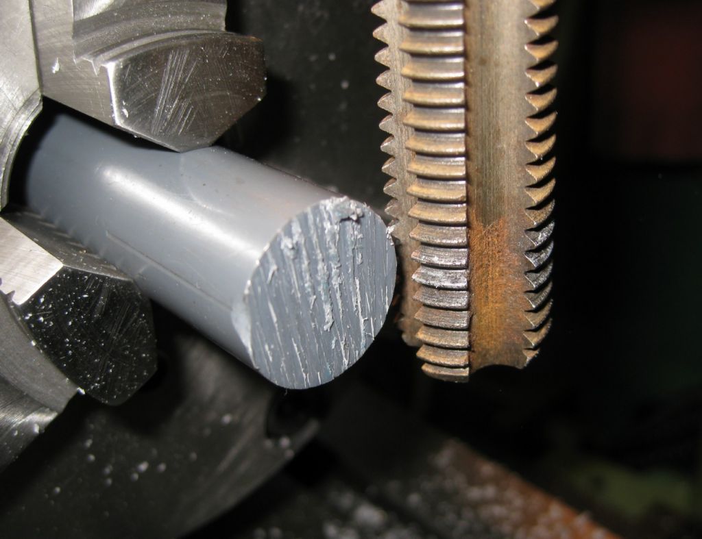

                          A VERY Blunt TAP – did not cut so much as bludgeon the material out the way…

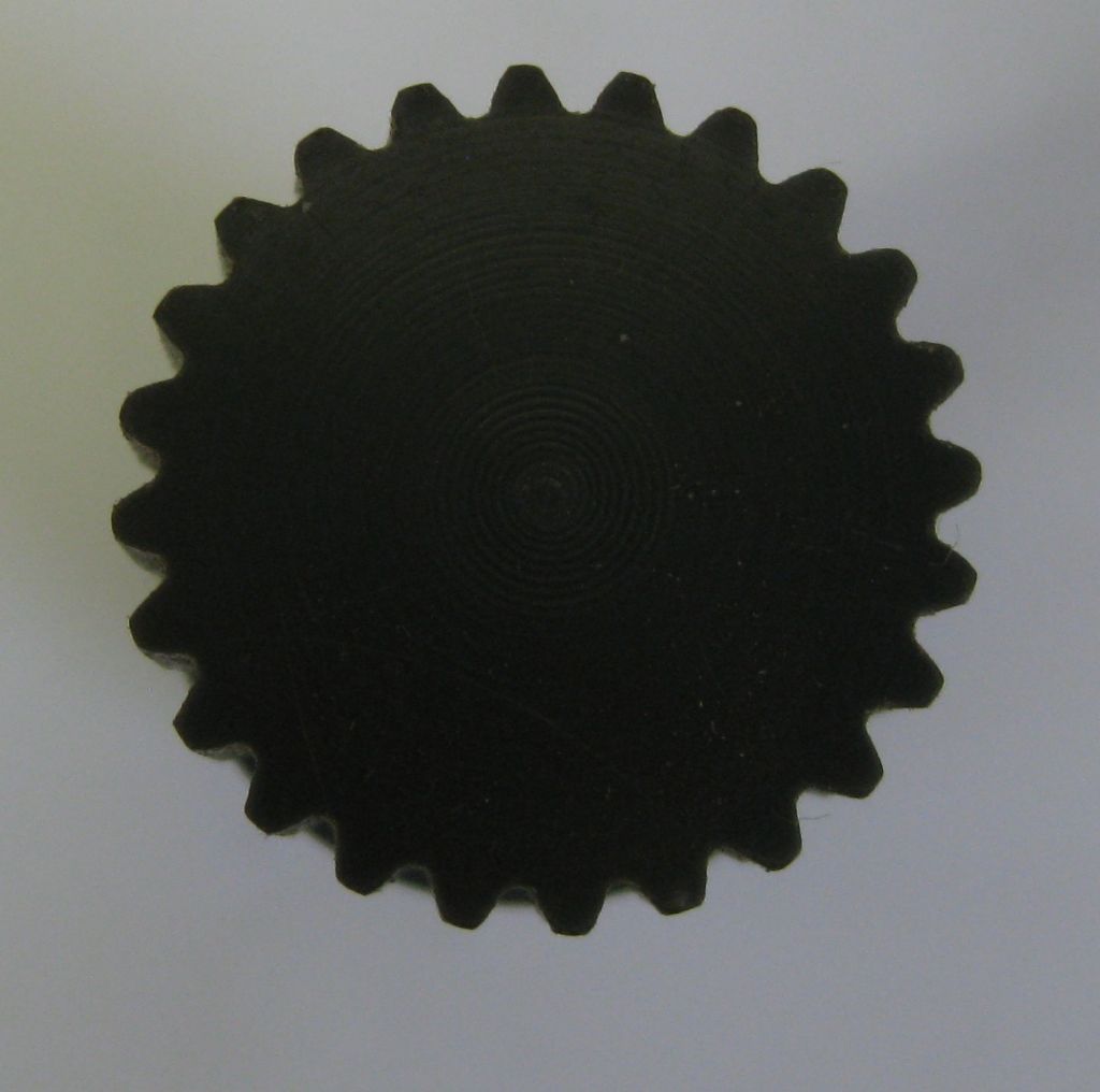

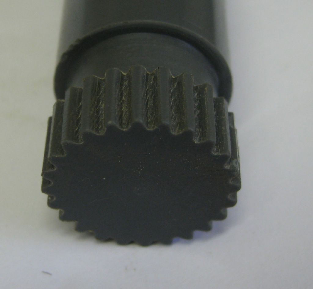

                          The 'cleaned' up 'gear'
                          valleys are very rough – As I said , the 'hob' is terrible..
                          Further views of gear: End-on

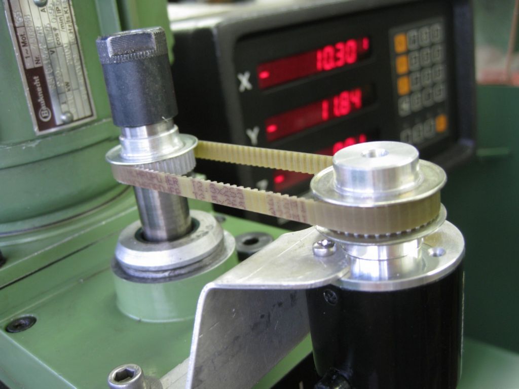

                          The temporary mount of the spindle rotary encoder

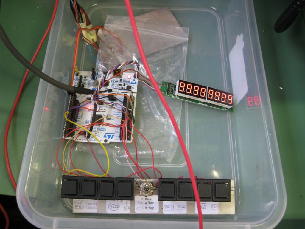

                          The electronics in crude test format..
                          And a video of it working – not great, but neither is the hob…
                          So the software seems to work well but some more work is needed on the stepper side – The stepper torque is, as expected, a little on the low side for the smaller diameter gears, with hob speeds greater than 250RPM. At 300 RPM the stepper stalls, albeit at 30VDC supply voltage – I need to push the supply up to 50V, or maybe even 70volts and hope that helps. The NEMA23 stepper is a little small..

                              Erm! Joe. how does the worm drive come out of the casting please??
                              #378653
                              Joseph Noci 1
                                @josephnoci1
                                Hi Rod,
                                looking at the first picture in my post, right on top-
                                Half hidden behind the index disc, at the 10 o'clock position, is an M6 Cap screw. Loosen that up so it is slack. That clamps the worm in place.
                                Then next to that cap screw is the square slot cut into the casting side – where the base mounting bolt goes through into the T slot of the table you mount onto –
                                Inside that slot, near the bottom of the slot is a hole inside of which is a slotted head set screw- that is used to set the end stop on the worm body when you rotate the worm body to eliminate play between the worm and worm wheel.
                                Loosen that screw out 8 or so turns. Then rotate the worm body anticlock and pull it out the casting. You will see where the set screw impinges within a slot in the worm body. You can see the slot in the larger body diameter here, toward the worm end of the body.
                                let me know if you do not manage.
                                Joe

                                  Life saver Joe. It was perfectly camouflaged with crud. Now out and polished. The need for your backlash nut makes becomes apparent.
