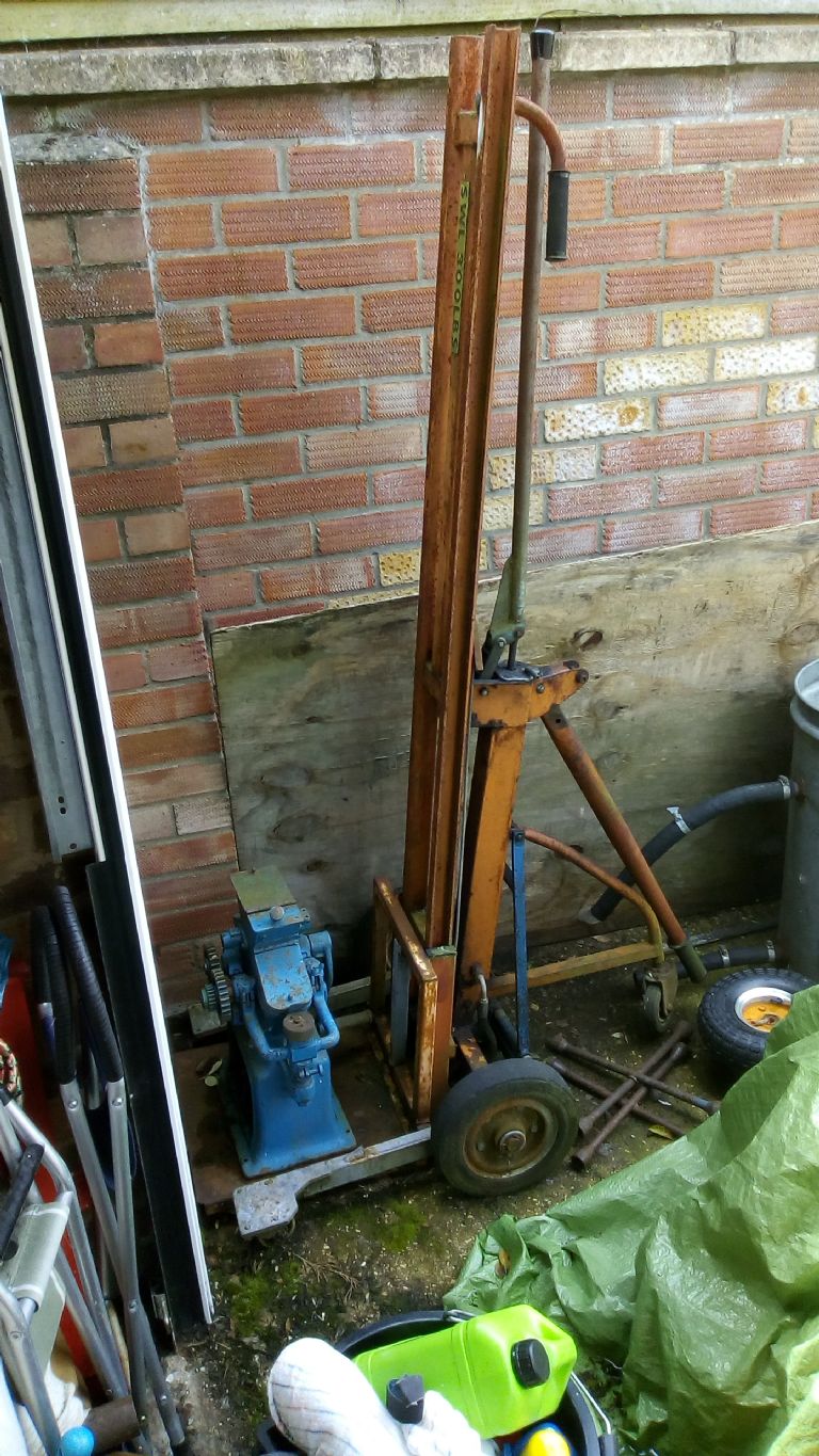

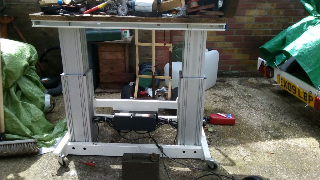

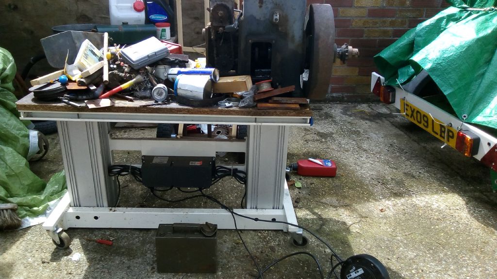

                                Gentlemen,
                                Here are pictures of two pieces of equipment I use to aid lifting.
                                The first is a table which at its lowest 610 mm of the ground and it its highest is 960 mm, I used to support a Class 2 Change Station which got scrapped.
                                The second is a hydraulic elevator which can lift 150 kg's up to about 5ft.

                                          larry Phelan
                                            @larryphelan54019
                                            Hi Martin,
                                            Your no 2 picture is more what I have in mind since I need to lift from floor level to workbench height.
