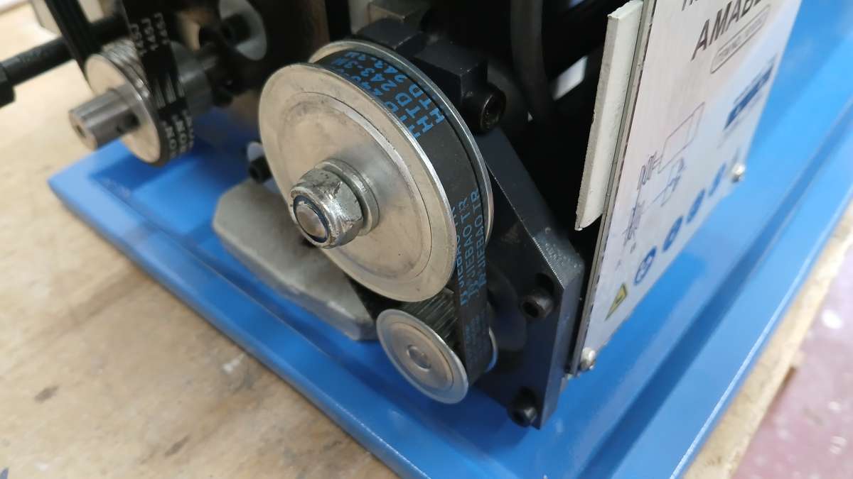

            If you keep clicking the FN button then the pitch (lead screw) comes up just after the two pulse settings which are the same as I have on the 210E.
            As I said take the cover off the end of the headstock and look at the bottom right which is the stepper motor and that is belted to the leadscrew . A quick count or measure should give enough to work out the ratio
            You then need to look at the lead screw and check what pitch that is, hopefully some will be exposed on the right side of the carriage before the spring cover starts. If not just pull the cover to one side and measure over 10 turns and divide that measurement by 10 to get the leadscrew pitch.
            20250624_143035

                  paulg 1
                    @paulg
                    Thank you for asking, Jason.
                    So, I have asked Amadeal to contact the supplier so they can send default settings. I’m hoping to hear from them in a day or so. I’m surprised, with the settings being so easy to access, that a list of default setting is not supplied.
                    The ratio between spindle and stepper pulleys is 2:1 the stepper having 20 teeth and the spindle pulley having 40.
                    The Leadscrew pitch is 2mm.
                    Entering the setting on the digital panel, the leadscrew is set to 2mm. I set this to 1mm and it brought the pitch to within .25/.3mm over 10mm, which is still very poor. I was careful to maintain pressure on the carriage hand wheel, to minimise backlash.
                    This leaves the encoder and stepper pulses as methods of adjusting?

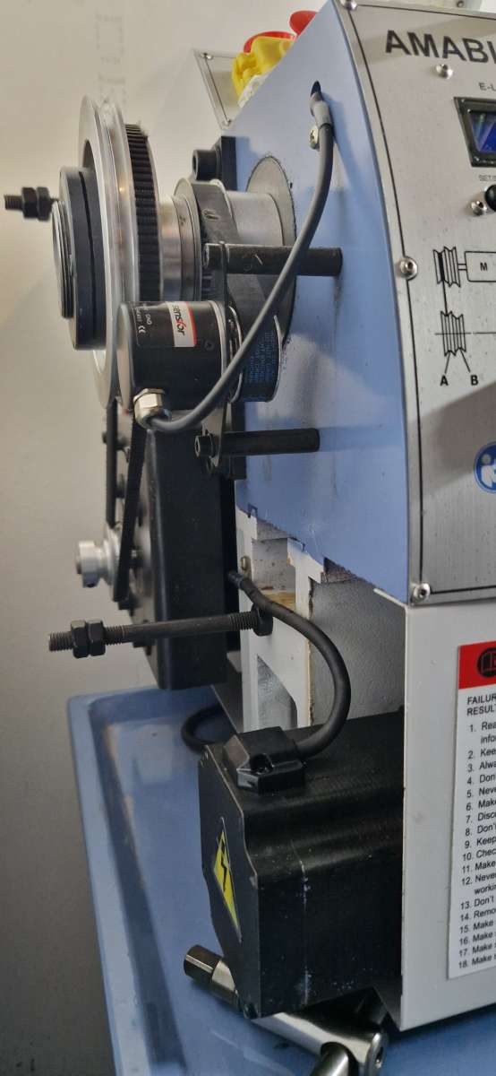

                        paulg 1
                          @paulg
                          Jason,
                          20250714_204312
                          The setup is very different.
                          Amadeal will be in touch in a couple of days and then I’ll decide what to do.
                          #807235
                            Yes as the change gear 250 machines have a basic gearbox where the stepper is now located the leadscrew is shorter so the stepper is mounted the other way round so it’s pully lines up with the one on the shorter leadscrew.
                            Similar 2:1 between stepper and leadscrew . I will look at the encoder bullies tomorrow and let you know what they are but my pulses are set the same as yours

                                I have a suspicion it is something else but need to get a couple of things confirmed first. I read Paul’s last post quickly on the phone last night but having read it again there are a couple of points.
                                Firstly the spindle is not mechanically linked to the stepper. The lathe spindle drives the encoder (small round item in your photo) The stepper (big black item bottom front) drives the leadscrew. Can you confirm if the stepper to leadscrew ratio is 1:1, 2:1 or something else. Don’t worry if you can’t easily see it, there is another way to check my theory.
                                Secondly your comments seem to suggest you are turning the diameter down to a length and not getting the expected result. Are you using the feed lever which is the short one that goes both up and down for along/across or are you using the longer lever that engages the half nuts?

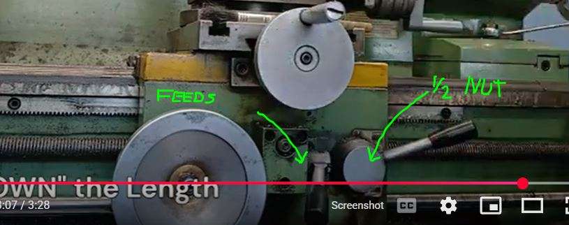

                                      Btw, I’ve been using the longitudinal/ crossfeed lever, not the long lever. I reserved this for screw cutting
                                      I feel that is where your problem lies.
                                      Based on the way the gear train 250, 280 and 290 machines work then the lead screw also acts as a feed shaft, You should be familiar with industrial machines that have more than one shaft across the front – a lead screw, a plain feedshaft with a keyway and a control shaft.
                                      The “feed lever” on the front of the machine takes the drive from the keyway and through a set of gears and either moves the carriage via a pinion that engages with the rack on the front of the bed or by another set of gears drives the cross slide lead screw. In both cases the thread and therefore pitch of the leadscrew does not really come into play and those internal apron gears will reduce or increase the number of handwehel turns relative to the feed slots rotation, usually giving a finer feed per spindle rev when facing to turning*.
                                      For the Auto turning (lengthways) to work correctly the Leadscrew thread needs to be used so the half nuts need to be engaged, backlash taken out by using the electronic feed to move the carrieage, tool position set and then the cut made.
                                      * I suspect this is why you first got the incorrect movement as the feed shaft driven gears within the apron move the carriage at a different rate to what a leadscrew would move it. So the 2mm pitch that was set at the factory may well be right. Reducing the pitch setting actually just reduced the error.
                                      My suggestion would be to check that the pitch is set correctly is to reset the leadscrew pitch to 2.00mm in the settings. Engage the half nuts and move the carriage to the left a little. And take a measrement of it’s position from a fixed point. Better still if you have a plunger type indicator then move the carriage upto that and set the dial to zero. But make sure you are only moving the carriage to the left which eliminates any backlash.
                                      Then use the FN key to select “automatic turning” and follow the prompts to set a known distance say 10mm or 12.7mm if using imperial measuring tools and to “stop” at the end not return. Then start the spindle turning and click run. The carriage will move to the left and stop at the set distance. Measure how much it has moved and report back. If all is OK I’ll explain how to make cuts using teh feeds, if not we can look again at the numbers.
                                      This should give you an idea of what to engage and what buttons to press. As I was using an imperial gauge I set the distance to 12.7mm (0.500″) and got five turns of the dial at 0.100″ each.

                                            Good to know it is all working and that the machine was fine.
                                            I’ll put something together in the morning about using the feed lever.
                                            #807430
                                              Hopefully this will give you a good idea of how to use the feed lever for general turning.
                                              I show the setting up of the ELS – Function, feed rate, direction, etc. Once the spindle and leadscrew are rotating I use the 210 machine’s halfnut lever but you will be using the feed lever. Engage lever to get things moving, back to neutral to stop the carriage or cross slide and then wind back to the start and put on another cut and off you go again.
                                              Speed can be changed at anytime on the fly as can direction. Though if using a high feed and high revs I would suggest pressing “RUN” again to stop the screw, change direction and then “RUN” again to get the screw turning the other way. This can also be used to return the carriage/cross slide back to the start but is a slower way of doing it than disengaging the lever and winding back by hand.
                                              When finished or if you want to check the dimension of the part just wind the knob to zero. To start again with the same settings just wind up the knob.
                                              At the end I have used my lathe to show the feed lever in action and the way I remember which way to move it. I have a separate drive shaft but that is like the slot in your leadscrew that is going round out of sight under the telescopic cover.
                                              * The displayed feed rate per rev will not apply when using the feed levers. It could be worked out but best to go by feel, start with a low rate and then wind it up to find what suits the job in hand.
                                              One other thing if the screw is rotating slowly you may need to feel the lever into position as it may take a while for the slot to come round. You can see I was having a job with the half nuts but was also watching the camera and did not have both hands available at all times add this to a slow spindle and fine feed and it looks like it is hard to engage but is fine in normal use.
