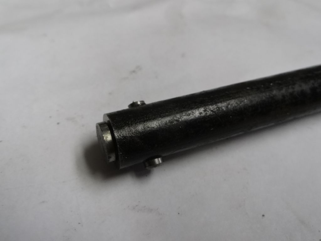

        Using a 750mm length of 1/2" gas pipe and some 8mm studding I set up an experiment for a real world test. The results showed 'Bunkum' to be the winner. Unfortunately Michael Gilligan (on top critical form after his holiday) pointed out that I'd compressed the rod rather than stretching it. I was busted!
        Here's the second attempt, this time – I hope – doing it right.

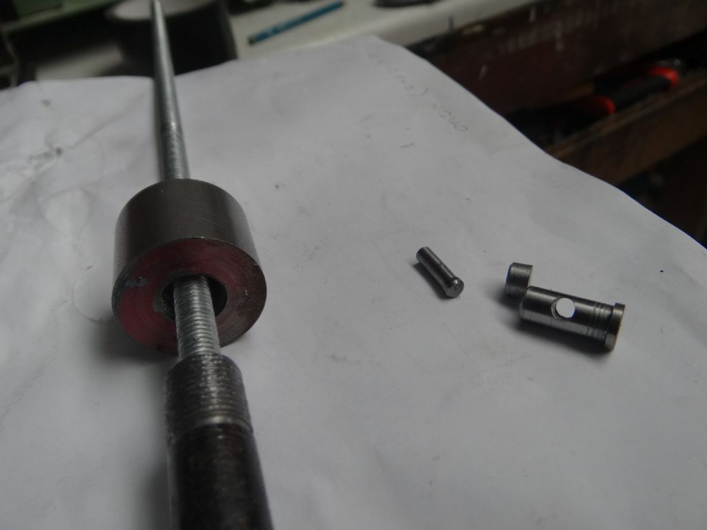

        I put an M13.7 x 1.25 thread on the end of the pipe. Then I turned and threaded a blind collar to screw on to the pipe. (Metric thread on an imperial diameter, yay!) Then I drilled and tapped a hole through the collar to take the M8 studding.
        I blocked the other end of the pipe with a top-hat pinned in place, plus a greased steel bearing pad. The parts can be seen on the right in the photo above. The pin is 4.5mm diameter mild steel. The pin is bent because the photo was taken after the experiment. The hole in the top hat is off centre due to bad workmanship.

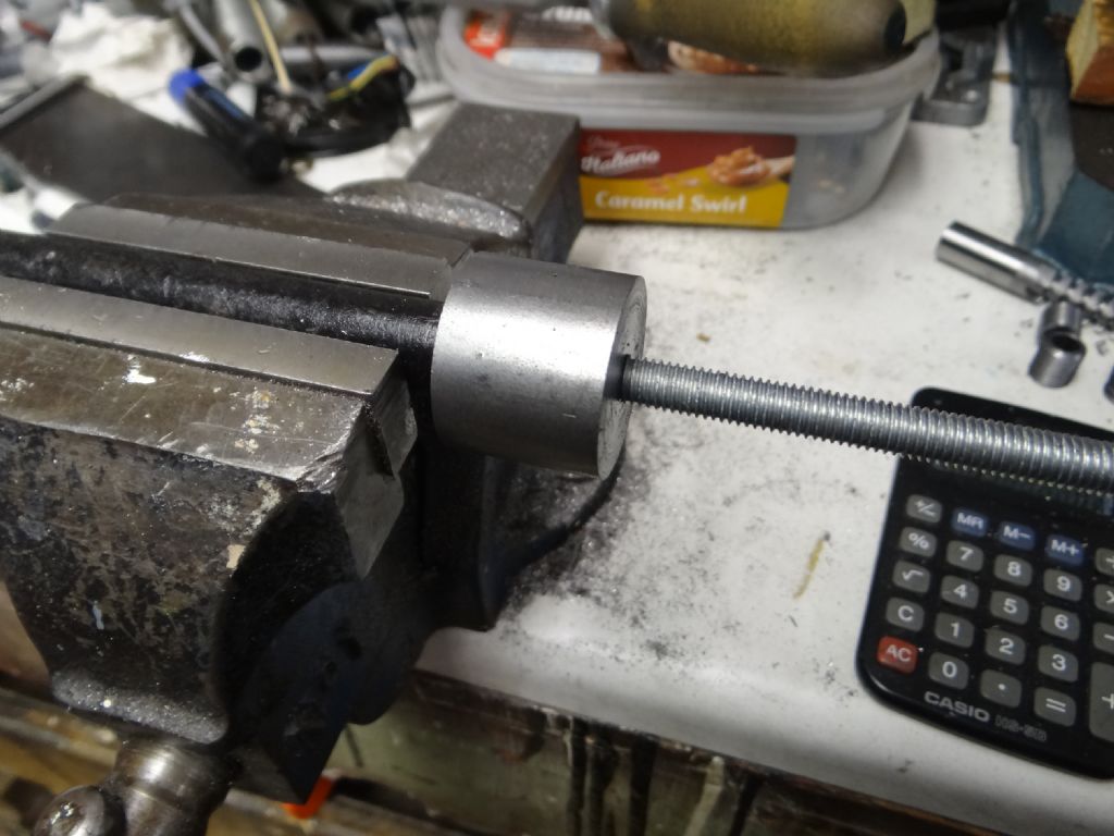

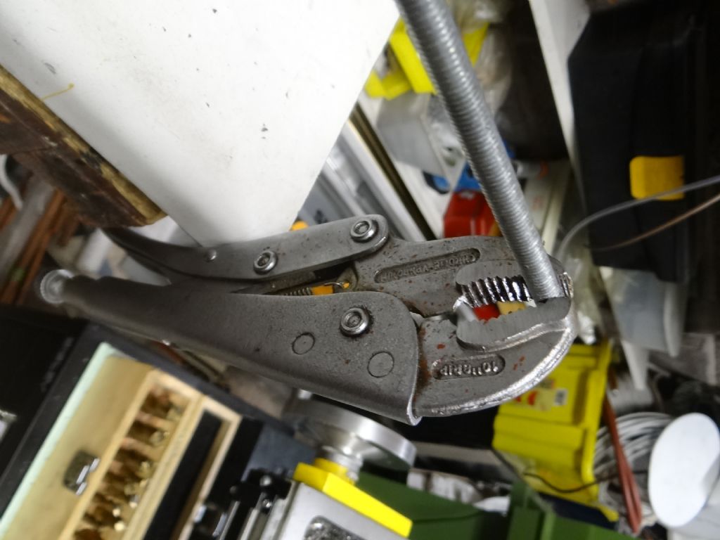

        I cut flats on the end of the studding and used a mole wrench to tighten it thus tensioning the pipe.

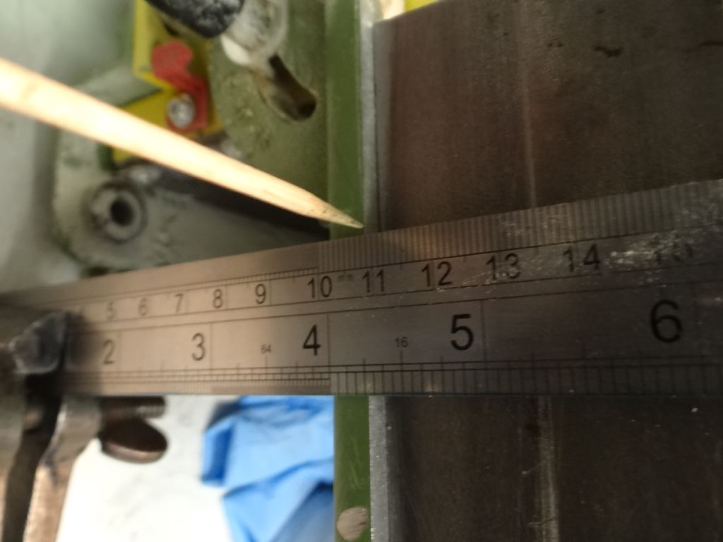

        Just like last time I stuck a pointer to the end of the pipe to measure movement.
        Then with one end of the pipe clamped in my vice I was able to tension the pipe by tightening the studding. During the test a kilogram of old springs were hung on the end of the pipe.
        The results were 'quite interesting'.
        Firstly, tightening the studding doesn't move the pointer much; it dropped a mm or two and after that more tightening didn't make much difference. (Apart from a few interesting 'metal complaining' noises)
