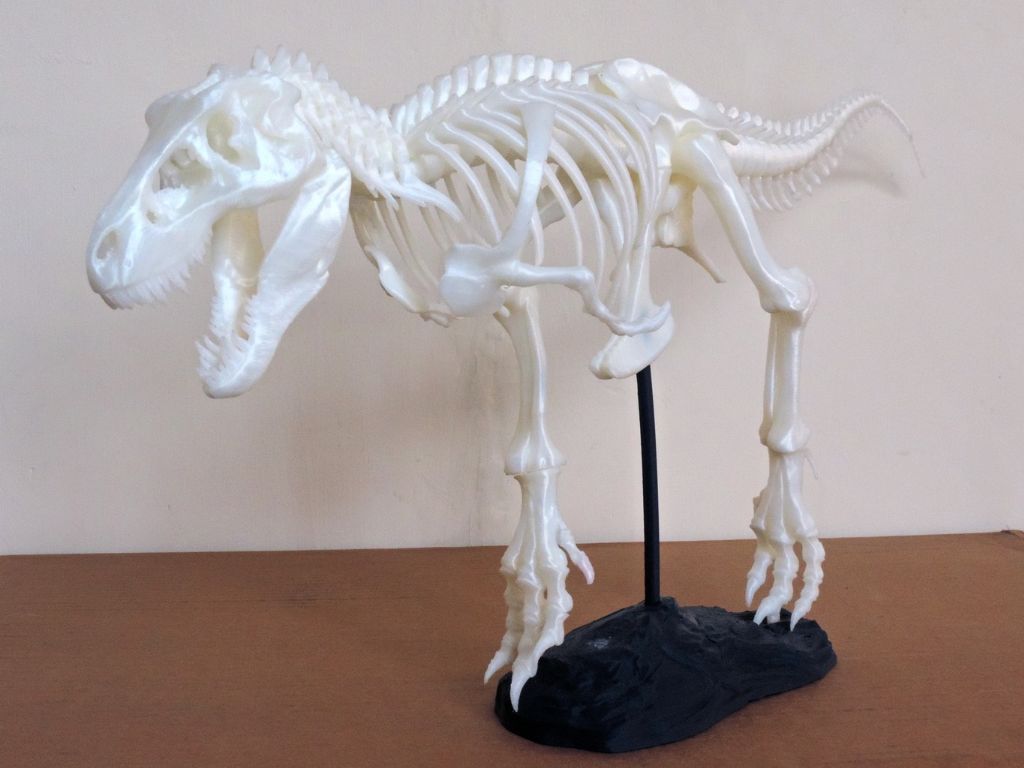

              Is there a prize for identifying the skull? The teeth remind me of my mother-in-law…

                        The skull is from Ultimaker's T-Rex. I have printed the full skeleton, it's about 18" long and , quite honestly, looks amazing. It's also noticeable how much better designed it is than 99% of things on Thingiverse – it actually does clip together (although the central support pillar is 15mm, too short as designed).

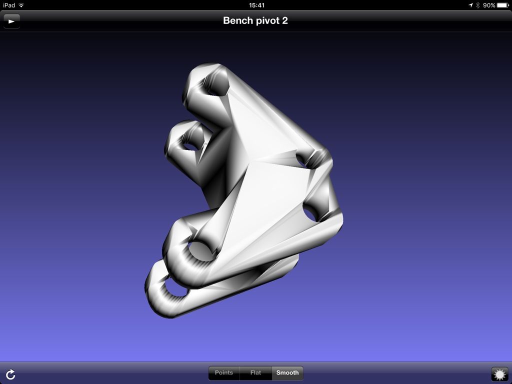

                        #302226
                          For info. …
                          The STL files will open in the MeshLab App on iPad … but the rendering isn't quite right.
                          No … I don't know whose 'fault' this is.

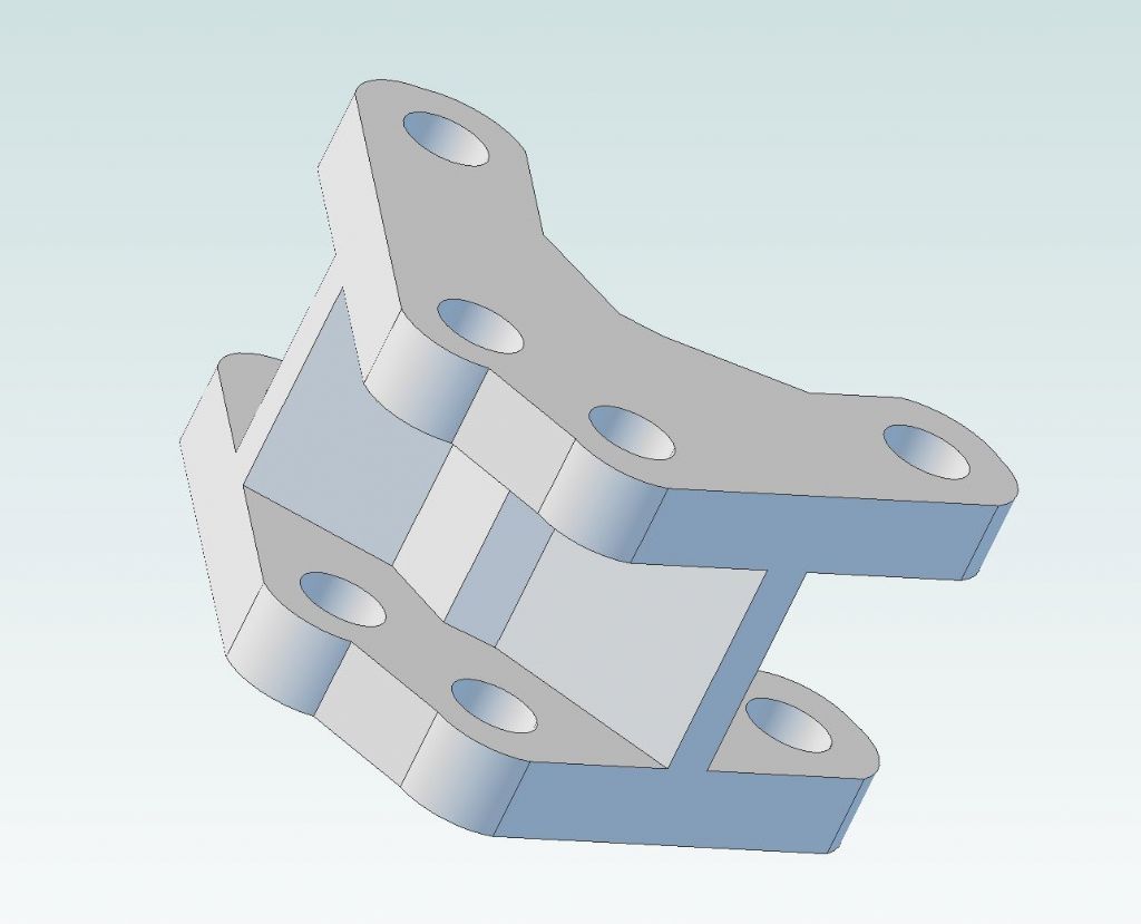

                            Journeyman
                              @journeyman
                              Seems to work in Geomagic Design (soon to be Alibre again apparently).
                              I still can't work out a way to see the insides of hollow items though.
                              #302236
                                You could try setting the opacity of the part to a lower level
                                #302241
                                  May be because that's two parts in the same space, not a single part. (Bench Lamp pivot and Bench pivot 2)
                                  Edit: no it isn't, silly me.
                                  Renders OK in FreeCAD.
                                  Edited By SillyOldDuffer on 12/06/2017 16:42:16
                                  #302244
                                  Journeyman
                                    @journeyman
                                    Posted by JasonB on 12/06/2017 16:33:40:
                                    Works for some bits but not others. The pivot above just reacts as a normal Alibre drawing and becomes semi-transparent. The arms which have holes down the middle stay completely solid. I was only trying it to see if you could see the layers for the print or any honeycomb centre filling. I don't appear to be able to edit anything either but I think that is the way Alibre imports things (perhaps).
                                    #302247
                                      Posted by Journeyman on 12/06/2017 16:23:49:
                                      Try using Cura, it has X-ray and transparent modes.
                                      Or the STL viewer I linked to above.
                                      Edited By Neil Wyatt on 12/06/2017 17:15:12

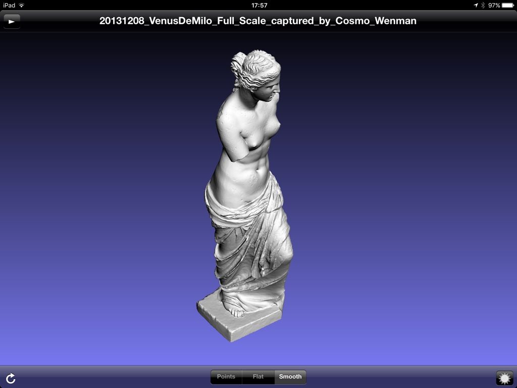

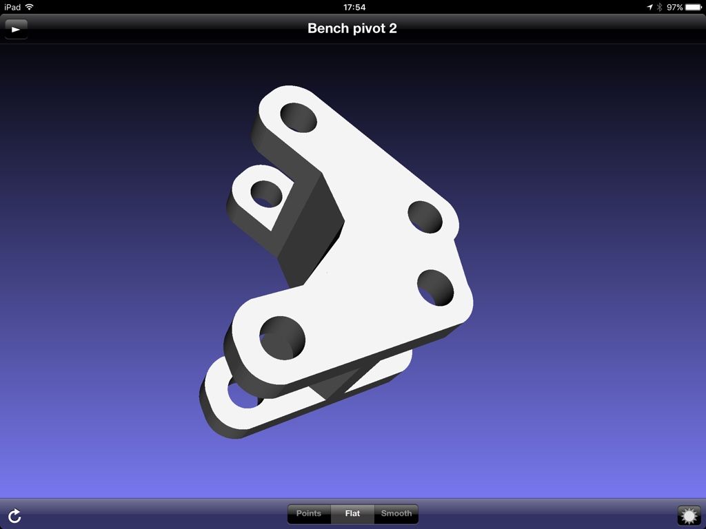

                                        It looks like you have some sort of smoothing switched on. By definition STL objects are composed entirely of flat triangular facets.
                                        #302258
                                          Posted by Neil Wyatt on 12/06/2017 17:13:16:
                                          Indeed I did, Neil
                                          … here's the same view, with flat rendering:
                                          Mind you … MeshLab does render some curves pretty well surprise
                                          [ Yes, this is an STL file ]

                                          Journeyman
                                            @journeyman
                                            Posted by Neil Wyatt on 12/06/2017 17:11:51:
                                            Ah yes, CURA makes it clear how it all works. Now all I need is a printersmiley

                                                  #302364
                                                    That looks useful, downloading now.
                                                    Here's the T-rex, sorry about the poor photo, but I couldn't be bothered to set up the photo booth to get a dark background!
