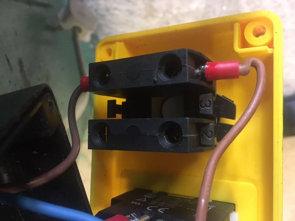

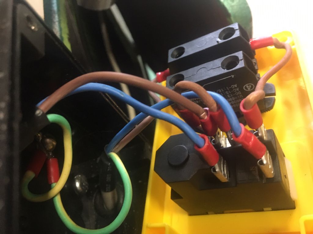

      Hello I'm looking for guidance on wiring e.stops in to a new electrical, circuit. I have a inkling but just wanted reassurance or putting right.
      I've got a kjd17 5 pin with a link on one of the terminals to the 5th pin. Supply in and supply out I get but where the separate link goes from the negative to A1, is this where I run E.Stops from taking the link of and running through every E.Stop and back to the terminal.?
      I'm wondering why it's the negative wire I would of thought it would be the live, but I suppose the negative is just the return of live

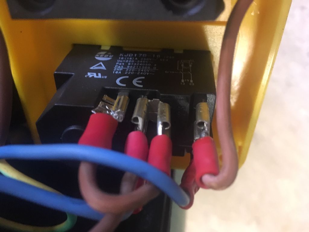

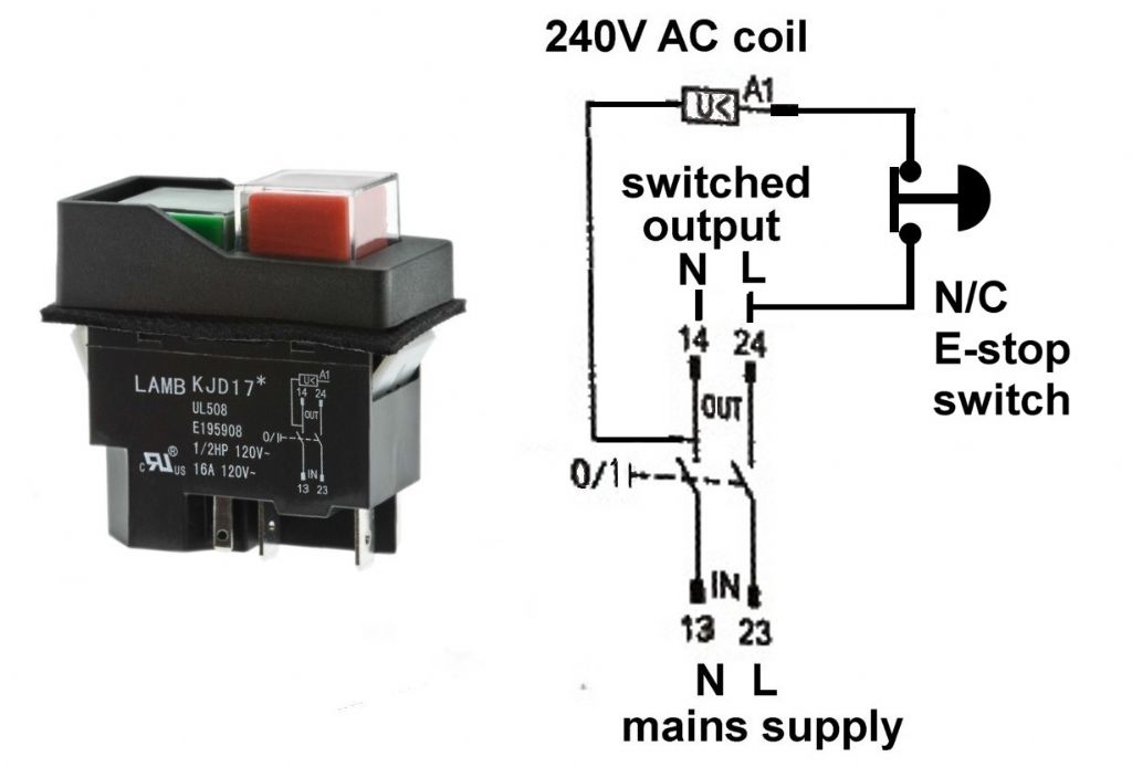

                  KJD17 E-stop wiring diagram

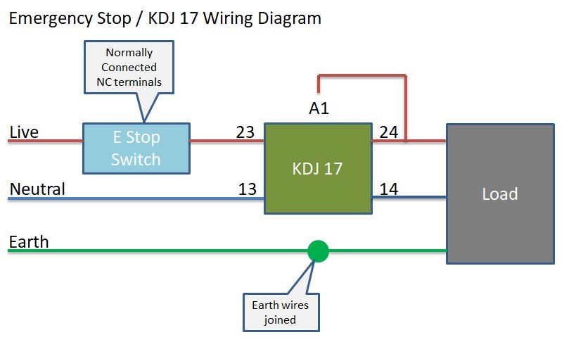

                            Assumes terminal post numbers are correct from the above information
                            The "hold on" relay is internally wired to Neutral, just needs a Live supply to A1
                            Edited By Andy Carruthers on 09/05/2019 13:34:36

                              Doesnt that diagram put the live on the wrong side ?
                              #408422
                              Andy Carruthers
                                @andycarruthers33275
                                The diagram reflects the wiring in the photos and correctly represents how the Emergency Stop Switch protects the KJD 17 and Load
                                Please PM if you think there is an issue, always willing to be educated

                                              Wired up with the e.stop in same box, reading the latest I'm running a .37kw motor so di I need to be concerned ?
                                              I now need to know how to wire up an additional e.stop, going of Robert's advice would I replace the link wire with an e.stp?

                                                  The reason I connected the switched live via the E-stop switch to A1 is
                                                  An accidental short between A1 and neutral or earth will blow the mains fuse
                                                  If you had live to terminal 13 and neutral to terminal 23
                                                  an accidental short between A1 and neutral or earth would energise the coil when the E-stop switch is open
                                                  assuming the mains supply is not protected by a residual current circuit breaker

                                                    Hi, I agree with John Swift1 diagram. The E-stops should only control the coil of the KJD17 and if you want more than one E-stop, then they should all be connected in series with the one shown. Protection of the KJD17 should be via a fuse or circuit breaker which feeds the supply to it, as suggested and non of the load current should go through the E-stops as Mike Poole said. One advantage of this is that the only way the motor will start is by pressing the start button and unless the KJD17 is or has been seriously overloaded, it is unlikely to fail and so if you get a power cut during use, every thing after the KJD17 will be in a safe mode when power is restored.
                                                    Regards Nick.
