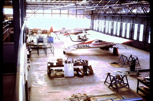

                                    Ian S C
                                      @iansc
                                      2012-08-29_0cessna 185 (640x426).jpgWhat part of the plane do you need 16 swg/.064" metal for? The skin of an average light aircraft is 2024-T3 Alclad ranging from .020" to .032". You would have to purchase it through an aircraft maintenance company. This is also the thickness used for making ribs, etc.
                                      Ian S C
                                      Edited By Ian S C on 22/04/2016 12:28:18

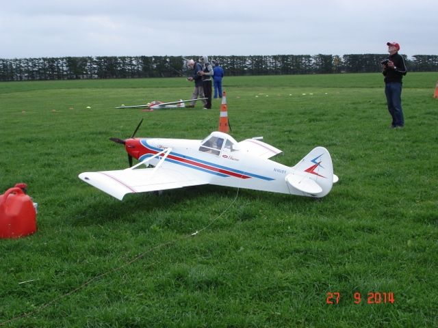

                                                  Ian S C
                                                    @iansc
                                                    dsc00940 (640x480).jpgOne popular launch method here in NZ is the aero tow, often using a model Pawnee, or similar aircraft. Another method used here is a winch. I imagine these methods are fairly universal. The only really big model I'v come across is a C-130 Hercules with 4 chainsaw motors, it require clearance from the tower at Christchurch airport even though it operates from a strip quite a few kilometres away. I,v seen at least one glider model with a retractable motor.
                                                    Ian S C
