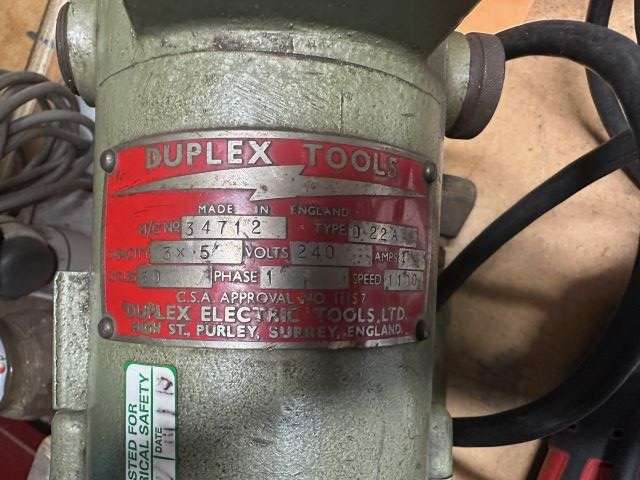

      I  have had a Dupex Toolpost Grinder for several years but never really needed to use it.
      I now need to very slightly reduce the diameter of a hardened 90 degree seatcutter.  I have  made and fitted guards for the wheel and the belts, ordered a new belt but am struggling to find a source for suitable grinding wheels.
      The wheels need to be 3″ diameter (or 75mm), 1/2″  thick and with a bore of 1/2″.  I have managed to source some 1/4″ thick wheels but cannot find any 1/2″ thick.
      A Midlands grinding wheel specialist can machine a 5″ one down to 3″ but will have a 2-3wk wait.  Does anyone have any ideas on sources or even have a spare wheel they have no use for.
      It is a Model D22A running at 1100rpm.  Capacity is given as 3″ x 1/2″.  Would I be correct in thinking that I could go smaller, say to 2″ diameter, safely.

        1100 RPM ? Do you mean 11,000 RPM ? As for size of wheel, smaller I would say yes but check the wheel speed rating ! It will reduce your cutting speed though this may not matter to much for a simple one off.

          The motor states 1100rpm.  Based on pulley diameters the spindle can run at 1500rpm max.  Supplier was DGS Abrasives.

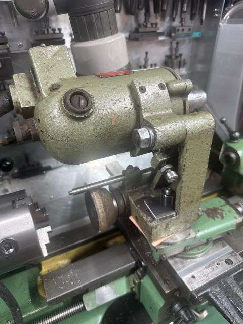

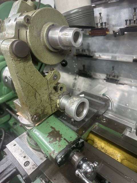

                        Colin Heseltine
                          @colinheseltine48622
                          The pictures below show the grinder mounted on lathe and also the motor plate.
                          Currently no guards or belt fitted.
                          ToolpostGrinder2res
                          ToolpostGrinder1res
                          ToolpostGrinder3rotateres

                            The speeds mentioned put me in the mind it is NOT a grinder ? Those speeds are more appropriate to a milling attachment. Or the pulleys have been changed ? Noel.

                                        If, as should be on a grinder, the motor is a fixed speed induction motor, then 1100rpm seems a strange speed for 50hz. Is it possibly a 6 pole motor intended for 60hz. Definitely too slow as it stands.

                                          It appears to be a brushed motor, note the brush holders. I have a wolf tpg and it is also a brushed motor. Angle grinders and small high speed grinders seem to be brushed.  Noel.

                                            You’re correct, I’d not noticed the brush-holders.

                                              For what it’s worth, this late in the thread, here’s some info. from an old Duplex brochure. Sorry, obviously no help with wheel availability …
                                              Model D22A.
                                              Plain wheels: Ext. 3″ X 1/2″ X 1/2″; Int. 1″ X 1/2″ X 5/16″ (‘standard vitrified’)
                                              Motor: Universal (DC or SP, commutator-type), 1/3 HP
                                              Speeds: 6,000, 16,000 RPM
                                              Unfortunately, the brochure pics don’t show the belt pulleys, but there doesn’t seem enough room in the belt guard for a large enough motor pulley to give the speed ratio required if the OP’s stated motor speed is correct.
                                              Later production models were fitted with fully enclosed induction motors. The commutator motors were not intended for continuous use, but their duty cycle was not stated. Spindle bearings are oil-mist lubricated – a few drops of oil required ‘every few working hours’.

                                                    The figures given by Kiwi are inline with what I fancy some, including me would expect. The speed rather than being 1100RPM  is probably X10, this would make sense. A ratio of 1: .55 or 1: 1.45 . Noel.

                                                      I have now collected the new 3″ dia grinding wheel and the new belt.  I have also purchased one of the cheap digital laser rpm counters.
                                                      Initial check of the motor gave speed of 15633 at the motor pulley.  This gave something like 26000 high speed for use with an internal grinding spindle and 7144 for the low speed for external grinding.  Ideally I need to take a number of speed readings and average them out.
                                                      I could possibly accept that whoever stamped the motor plate missed a zero off and it should read 11000, in which case this would give a low speed of 6490 and a top speed of 15155 with the current pulleys.
                                                      At least it looks as though I have suitable speeds for the size of grinding wheels I will be using.
