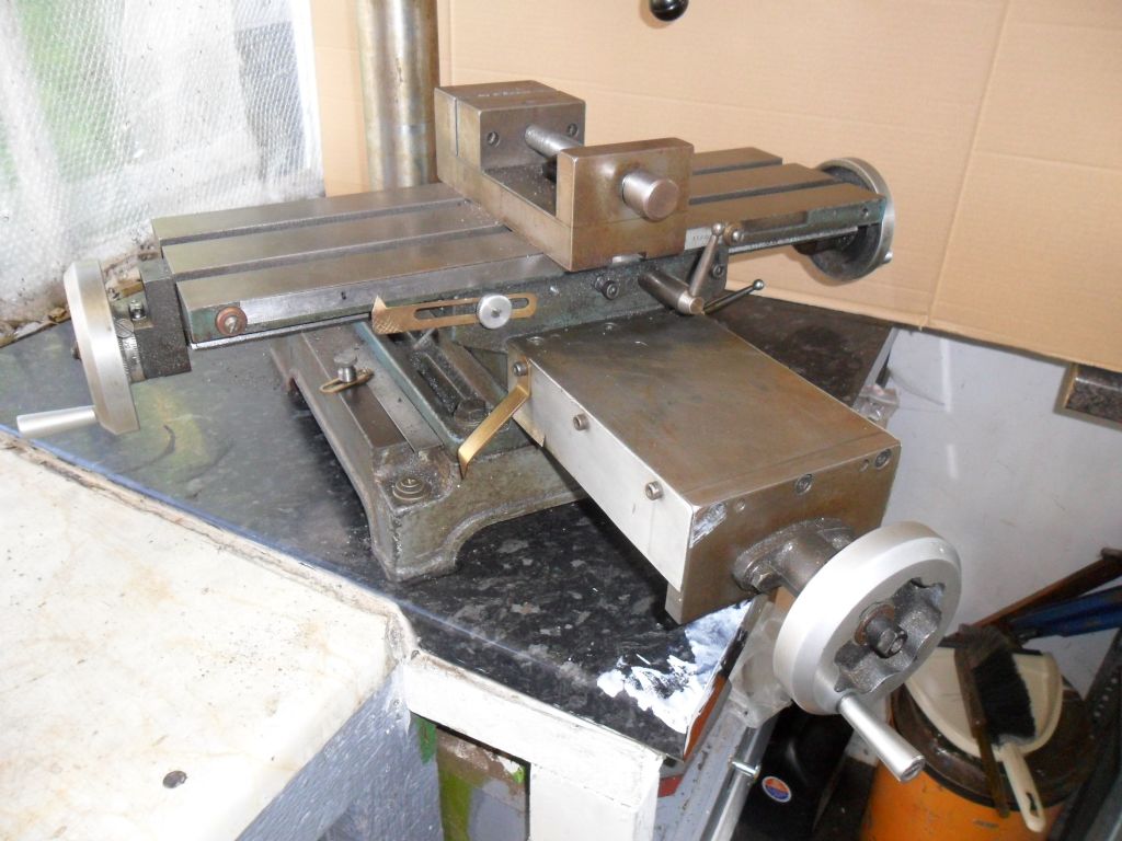

With regards to gib locks. You know you have gibs on most machine sliding axis, well a gib lock is usually a method of a handle or screw that locks or tightens up your gibs so that the axis is prevented from moving. So once you have found position for drilling your hole, tighten up the gib locks in both X & Y axis on the mill, and the part cannot move out of position as you drill.
