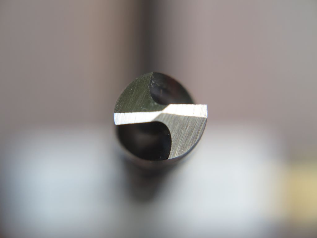

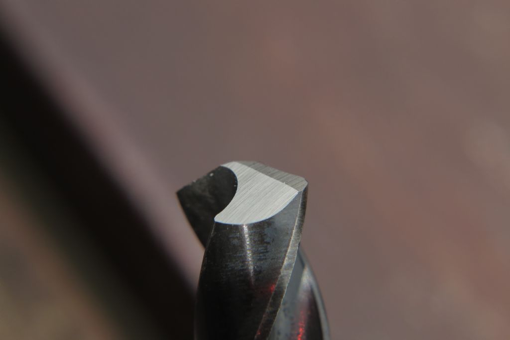

                              dbacaca5-9df8-4e28-a043-38ae8bd8086a.jpegI personally like the 4 facet method as it almost makes centre drills redundant. I made a couple of jigs to sharpen 3 to 6mm and another one to take up to 13 mm. The smaller ones I do on a DAG Brown jig. The two jigs for the cutter grinder are an adaption from article in MEW by Roland Gyllander from Sweden. 1995 I believe.811e7755-2daa-4e9c-b782-9489a8e1972d.jpeg

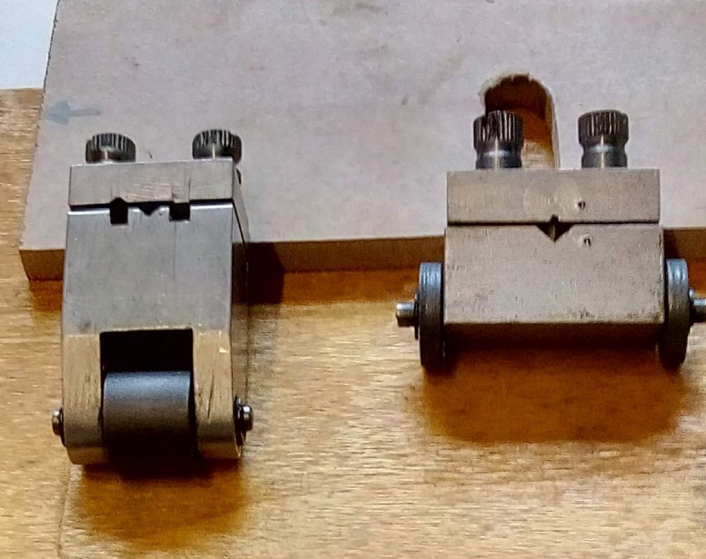

                                              Re small drill sharpening – I inherited these two items from my late brother (he was a competent model engineer), and I assume they are for sharpening small drills. OK insert in V, set projection to give appropriate angle and rub on oilstone / diamond lap. Rotate 180 & repeat.
                                              But that will only give you flat cutting edges with no relief surely? Is there a nack to doing this? I have seen articles on units such as the ' butterfly ' jig that allows you to tilt slightly to give the relief, but these do not seem to permit that easily.
                                              Also, any obvious reason why 2 different heights?
                                              ( I meant to put a rule in the photo but forget. They are both around 20 – 25mm across )
                                              I may be barking up the wrong tree totally, but if these are useful they would assist me greatly – so any input most gratefully received. Regards Mike

                                                I wonder if the items that Mike has inherited are intended for sharpening screwdrivers or gravers?
                                                I have an original "Wishbone" sharpener ( is the buttterfly one similar?) which I bought many years ago. It does work for small (sub 3mm) drills though it takes time and practice. The original "whetstone" was too coarse, in my view, and I use a fine diamond bench stone instead. The original loupe was rubbish and had to be replaced, so I don't have very much of the original kit. I tend to buy new drills now because time is short and the economics seem to have changed.
                                                Rod

                                                  I would imagine that if the drill bit was projecting the same amount in each jig you would be able to get 4 facets,

                                                      Posted by bernard towers on 09/01/2022 12:41:49:
                                                      Hadn't thought of that! Thanks fot the suggestion, i'll give it a try & report back.
                                                      ROD: Thanks for the comments. I have seen both terms used for the same physical unit.
                                                      It's unlikely that these were used for anything other than drills (but not impossible I suppose) as I know he did a lot of small hole drilling – he'd built many fine models over the years and was half way through a model of the Agenoria when he passed away. There's an awful lot of rivet holes in that one !
