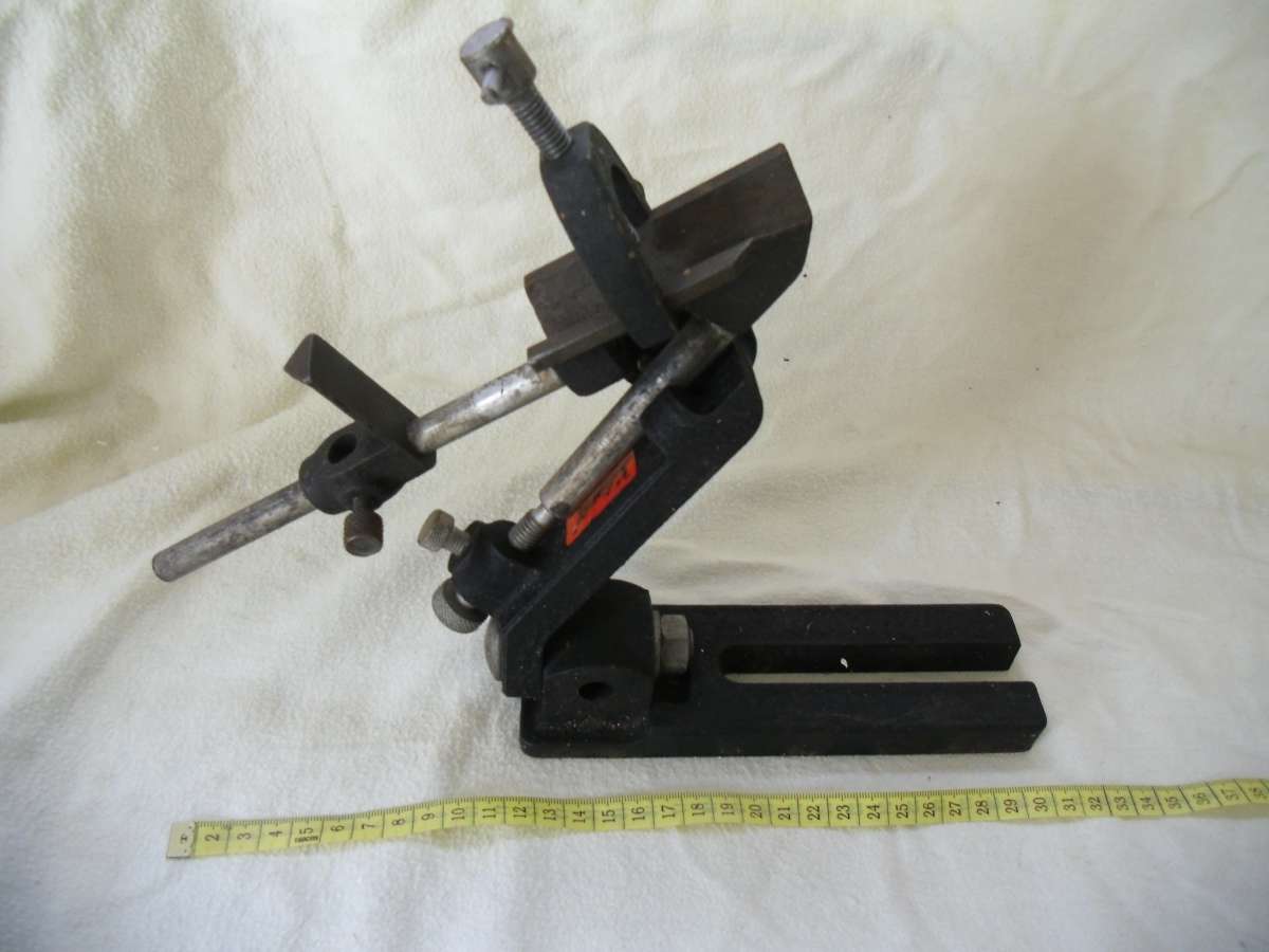

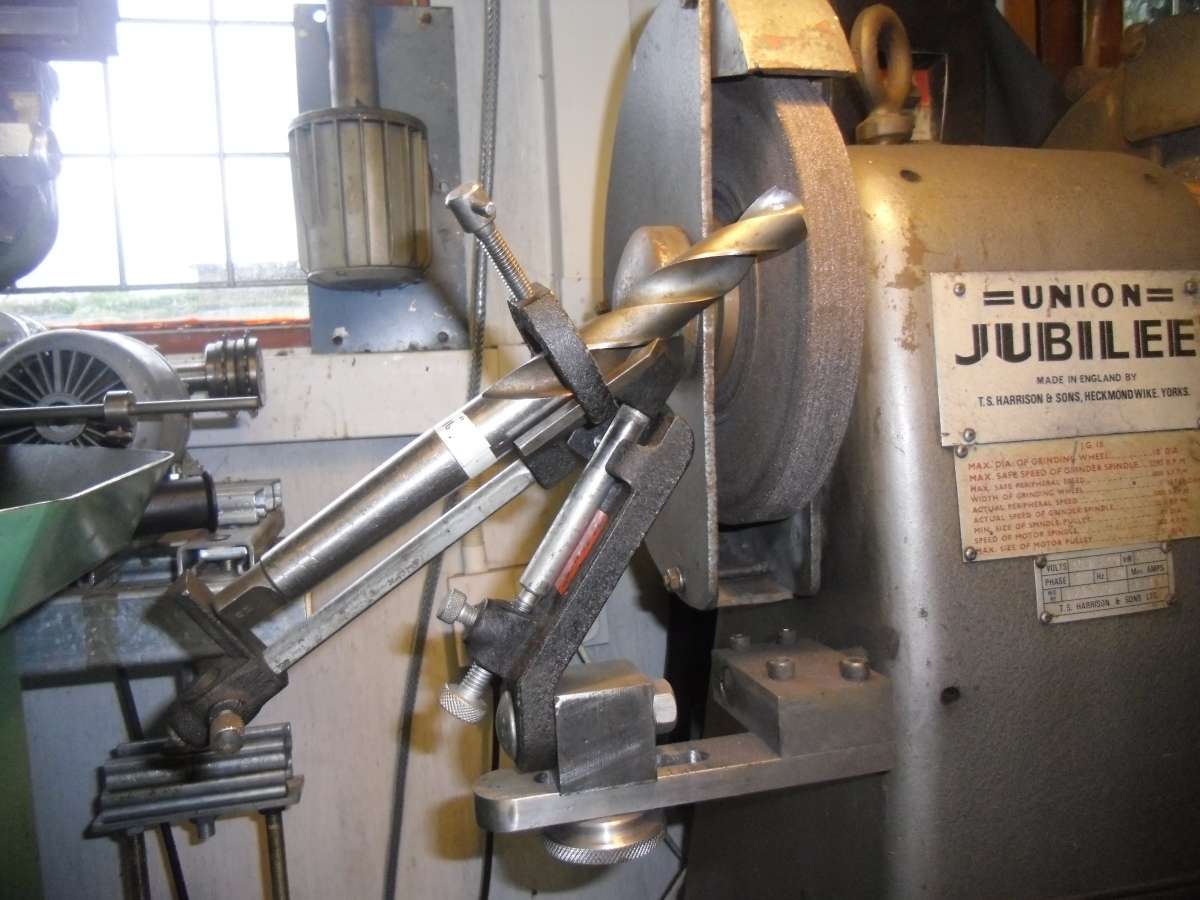

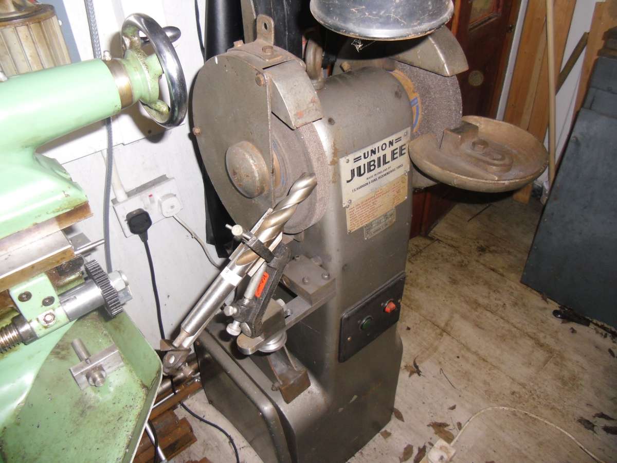

                  Chris Crew
                    @chriscrew66644
                    If you mean by the ‘swing type’ drill grinding jig it is of the die-cast ‘Picador’ type you will find it almost useless, insofar as it will not generate any backing-off of the cutting edge if just swung against the side or face of the grinding wheel and the drill will not cut. The rear knurled thumb-wheel screw and cup-washer, which form part of the back-rest, are not there just for initial setting up. When you have set up a drill bit for grinding put a mark on the thumb-wheel and a fixed point on the back-rest. As you stroke the drill across the side of the wheel advance the thumb-wheel about a quarter turn and then re-align the marks again for the second stroke. This will back-off the cutting edge and the re-sharpened drill will now cut.
                    If you can get hold of one, the ‘Reliance’ drill grinding jig, as once made by H.D. Murray & Co. of Ponders End is by far a better design, although they were quite crudely manufactured. This is because the drill bit is caused to ‘roll’ across the side of the grinding wheel and the cradle it lies in is off-set to the axis of the jig. This automatically generates the required backing-off of the cutting edge. I don’t know the availability of these jigs on the second-hand market, I don’t think that they have been made for many years now, but they came in three sizes. No.1 for 1/8″-1/2″, No.2 for 1/2″-1″, No.3 for 1″-2″ drill bits. Provided your grinder spindle has little of no end-float, and you exercise care and common sense, there should be no problem in grinding on the side of the wheel in fact most jigs are designed to be used this way.
                    The jig, as supplied, has a cast slotted bracket for mounting against the side of a wheel with No.1 jig shown in the first photograph. The 2nd & 3rd photographs show the No.2 size jig mounted on home-made bracket and holding a 15/16″ drill. In the second photograph you can detect the off-set of the cradle to the axis of swing.

                    Les Riley
                      @lesriley75593
                      I would second Chris’ post above. I have all three sizes of Reliance and have happily been producing perfect drill tips with them for many years. The Picador et al type really is rubbish!
                      Watch eBay and bide your time and you can get a smallest Reliance for around £30. The smallest is the most useful one for most folks work size.
