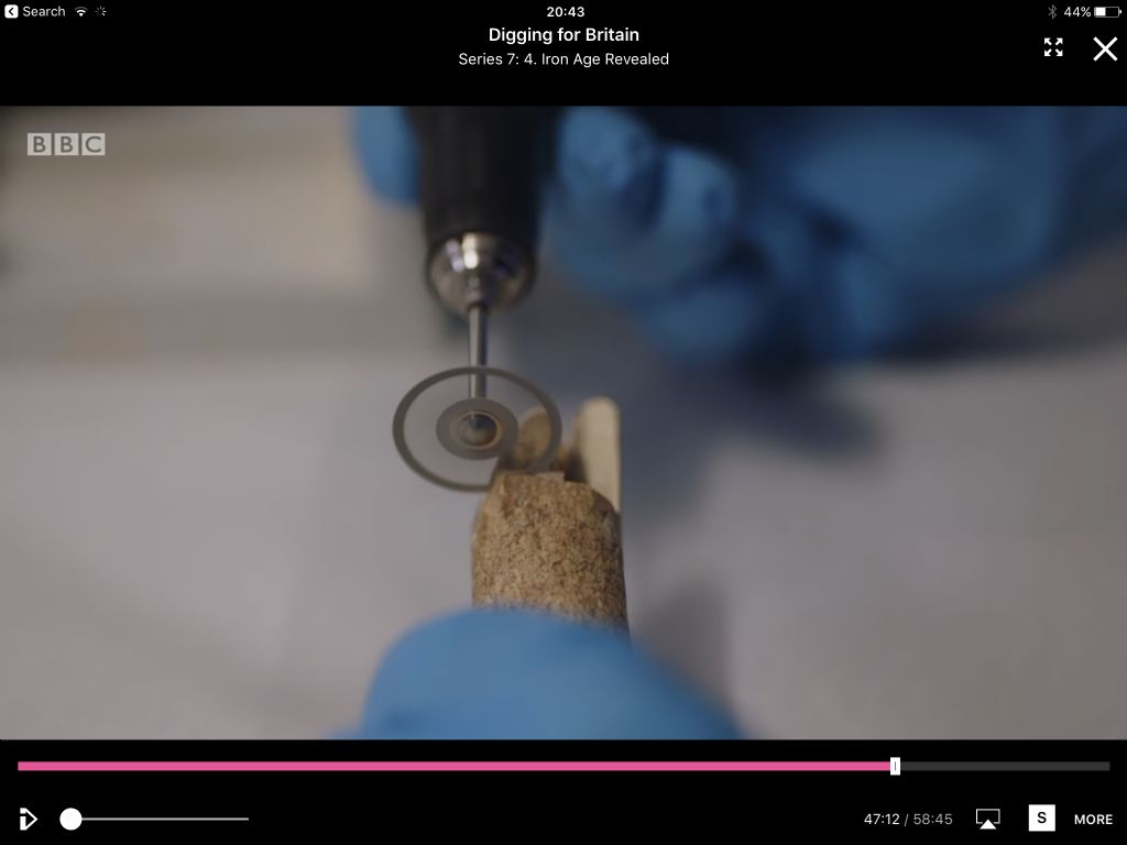

      Here's a screen grab from the latest epidode of "Digging for Britain" … featuring a [presumably] Diamond saw, on a transparent disc.
      Does anyone recognise it, please ?

          Could it be an optical illusion due to holes in the disk? Something like these dremel diamond cutters on amazon.

            Could it be one with holes but due to the speed it appears as though it is a clear material. If it was plastic any heat build up may effect the clear plastic and distort the disc.

              Thanks, gentlemen … I did wonder that.
              I have already written to Dr Madgwick, and will report back if/when he advises me.

                  Or try a lapidary shop, they use fine diamond discs to cut stones, rocks etc. They also cut composites which is why I got mine!!

                    The amount of "solid" around the edge looks a lot thinner than most of the drilled discs that are about would show when spun up but you may want to look at the dental ones such as this which only have a small amount of diamond coating around the edge

                      I think Jason is probably right, my brother in law was a dental technician at the local hospital. He once showed me around his workshop and I can remember seeing a small holder with a range of very thin small cutting discs, not the type you would normally see for sale.

                        Well folks … as you may have noticed, he was sectioning a tooth angel

                          Michael, have a google for Kerr diamond cutting discs

                            Some of their's are slotted, rather than being perforated with  big round holes … so the optical illusion would probably be more convincing.

                                  Helpful resonse from Dr Richard Madgwick :
                                  [quote]
                                  It's not actually transparent – it has spokes, but you can't see them. It's a flexible diamond wheel that dentists use. I get them from prestige dental and they're about £12 each I think.
