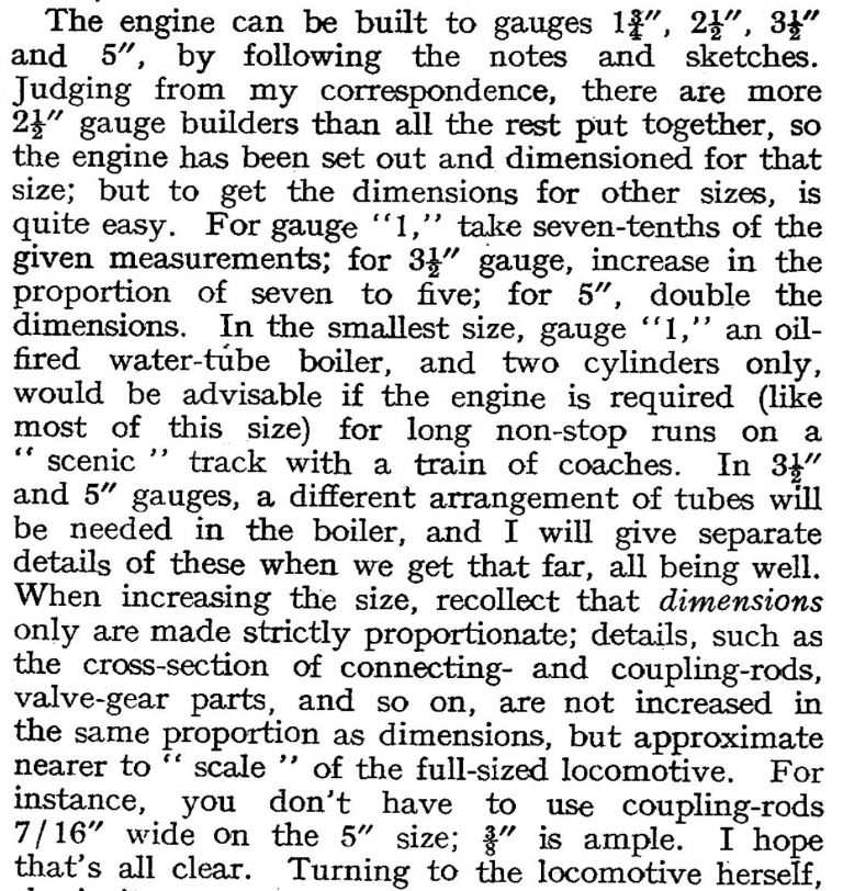

          Hi John, below is an extract from L.B.S.C. on his Olympiade notes from 1938.
          The coupling rods on this 2 1/2 engine are 7/32 x 1/8.
          Hope this will give you some idea.
          Regards Nick.
