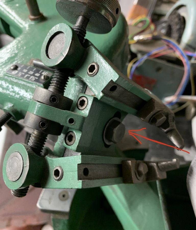

      Hi,
      Does anyone here use a Dormer 108 Drill Grinder?
      I have a machine that I have rebuilt, it works beautifully, expect the chisel angle is too high – all the other geometry is correct. I can’t see anything in the manual relating to adjusting the chisel angle – does anyone know how to do this please?
      Thank you 🙂

                  Thank you so much Mike, your manual has answered my question, problem solved! Mine is a Mk 1 machine, but a similar setup. In case anyone is looking for how to do this, slacken the bolt in front of the jaws:

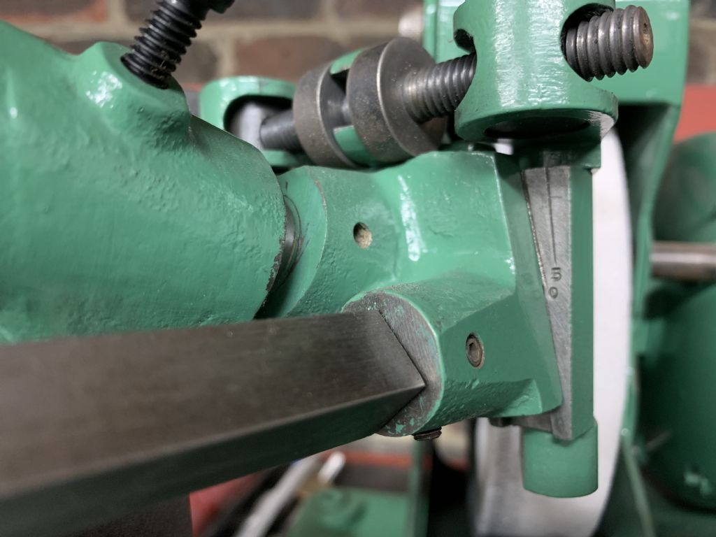

                  Then you can turn the clamp head to adjust the chisel angle. Once you adjust this, there is a graduated scale that is hidden when the head is straight:
