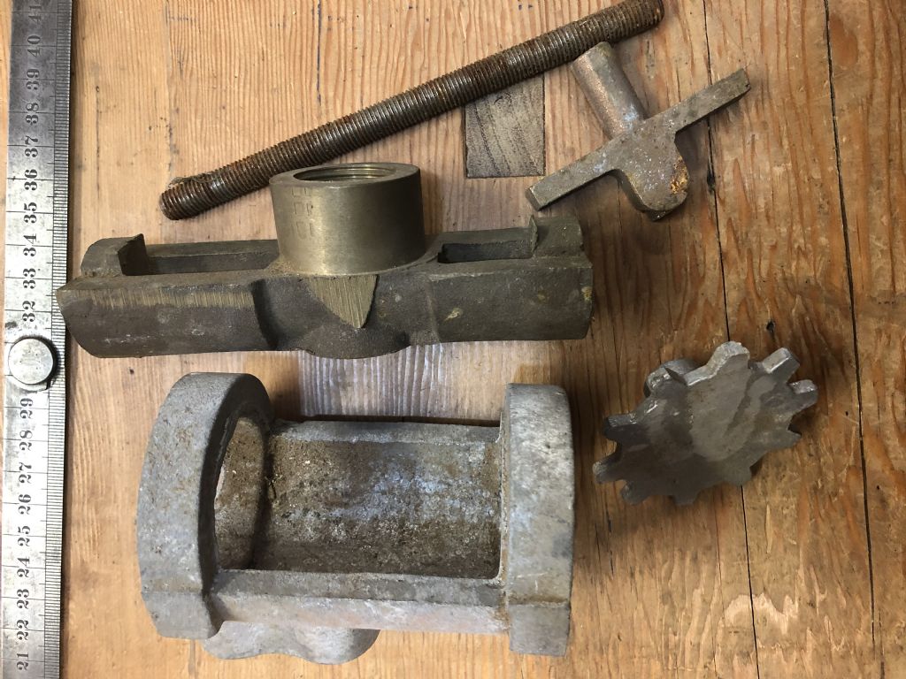

      Hi All,
      Have just rejoined after a long while not posting (but browsing) and not being able to log in.
      I think its called a Dore Boring Head but google brings up lots of images if you call it a Westbury boring head.
      I recently came a cross some casting kits at a sale (when buying and old pantograph) and it was unexpected to find a Stuart 10h kit along with a kit for the Dore boring and facing head.
      Main issue at the moment is that I have no construction plans for the boring head, just a box of casting. While I could probably cobble it together, it would be useful to know roughly what sizes things were meant to be. I have looked around for plans but not finding much available or and suggestions on how best to approach the machining as I dont think you can by replacement bits if something isn;t done right.
      I was pointed to Reeves model engineers who have plans for the westbury boring head but at $43 approx to post to me I figured that was just too much and so thought I might try ask here if anyone has made one or has some old plans they could share to help with the build. the kit is bottom right in the image.
      Cheers
      Steve

          Find the ME index online and try a search for the head. Fair chance it was a set of articles. Then you might be able to get someone to scan them for you.

                FWIW, the ali casting is about as tough as bluetack – fit a threaded steel bush for the tool locking screw.

                        John – thanks re the tip on the castings and the locking screw, I have a few old electronic copies of ME and have got one article by George Thomas on modifications he did, so I might consider doing some of what he had done.

                            Hi Bill,
                            Big thanks, files have come through and is exactly what I was looking for.
                            I also tried to set up an album. I was able to identify one more part (screw thread) that was in the box among the random bits. hope the image works this time.
                            Looks like I have the main parts needed. I can find the random grub screws and bolts. The screw has a little rust so will clean it up and see if I am happy with it. I might also fit a graduated dial.
                            Think those parts have been sitting the box for abut 50 years.

                              I believe there is a casting missing, the one which is fitted to the bed and supports the wheel adjustment wire when facing.

                                  Having looked through some more documents, it appears that this extra casting may have been available separately to those for the head itself.
                                  I've sent another three PDFs to a couple of folk privately, (Steve & John), one of which has a set of plans for the lathe bed bracket(s) for ML7/S7, ML10 & Boxford
