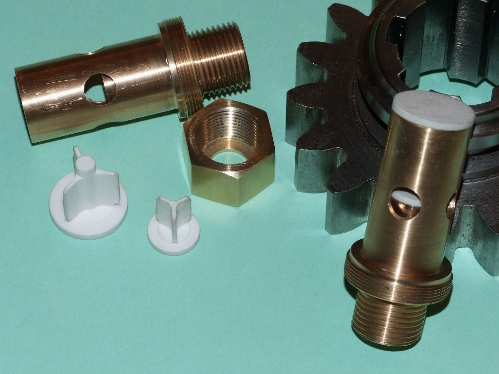

                                Hi again, I'm still hoping to get some information on how to use PTFE for piston valve heads. There seems to be a scarcity of information out there. I've heard of filled PTFE, the carbon filled material isn't much more expensive and may be better. Also flouroscint in mentioned but I don't know of a source where I can buy some small diameter. Anybody help please?
                                #614449
                                Anonymous
                                  I don't know about piston valves, but have machined a lot of PTFE. It's horrible stuff to machine; deflects away from the cutting tool and creeps badly. It is also poor at resisting loads. It is difficult to hold any sort of tolerance.
                                  I have also machined a lot of glass filled PTFE. This is much easier to machine, much less deflection and creep so easy to hold tolerances. I made the wing valves for my traction engine water pumps from glass filled PTFE, the white objects towards bottom left:

                                    Thanks Andrew, I found a place in the uk that sells 25% carbon filled PTFE for a reasonable price [about £21 per metre] but I don't know what they charge for shipping. Does that machine better? A thread about making piston rings from it say it does. The difficulty with all these is getting the small quantities we need.
                                    Edited By John Rutzen on 22/09/2022 11:02:36
                                    #614463
                                    Anonymous
                                      I've never machined carbon filled, but I would expect it to machine similarly to glass filled. I normally buy plastics from EDPlastics as they are local and will deliver for a nominal fee. I assume they will ship, but never tried it.
                                      Andrew
                                      EDPlastics

                                                    Hi John, sorry for the late reply. I've not been on the forum for a bit.
                                                    I make the PTFE valves a push fit in the bores. They will sort themselves out once they see steam.
                                                    It helps if you can make the PTFE heads as thin as possible as that helps negate the problems with the PTFE expanding. Those on my Helen Long are only 0.0625" thick and they still seal perfectly after all these years.
                                                    I've never used anything but the plain PTFE for valves or piston rings , indeed, never found the need to. The plain PTFE works fine for me.
