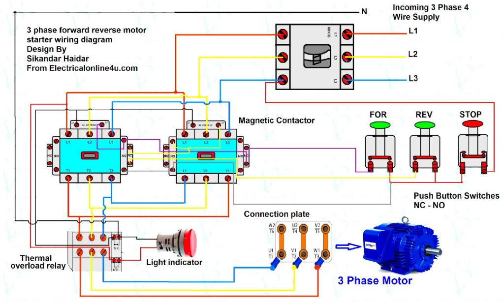

      have replaced the 3ph starter push button on/off switch on my Colchester lathe….
      the photo's would explain better but the main wires are no problem…all wires coded by me before disassembly and the switch box's )old and new) use the same wiring term numbers…..my problem is with the reverse switch……just 1 wire……
      not fired it up yet as don't want to burn anything out…….

              To reverse a 3 phase motor you just need to swap two phases of the supply, any two, it doesn't matter which two wires you swap.
              Robert.

                thanks R. Atkinson,,,,
                actually know that one but the reverse switch is wired thru the DOL…….giving the odd wire…

                    Hi clogs,
                    If you still can't post pictures on the forum with the help from neil's links the PM me and I will give you my email address so you can send pictures as attachments. If you can post the schematic as it is shoing the origin of the wire then it should be possible to work out where it should be connected. It could just have two of the three phases in and out and the third phase just bypassing it. it could also have the three phases in and out. If it has a centre off position it could be one of the previous ways plus two wires that cause the main starter to drop out in the centre off position. This would stop you from going straight from one direction to the other.
                    EDIT. I've just noticed John's post with the schematic that uses two cantactors, one for forward and one for reverse. Is yours like this or does it have a single contactor plus a reveresing switch ? (As opposed to a forward, a reverse and a stop button.)
