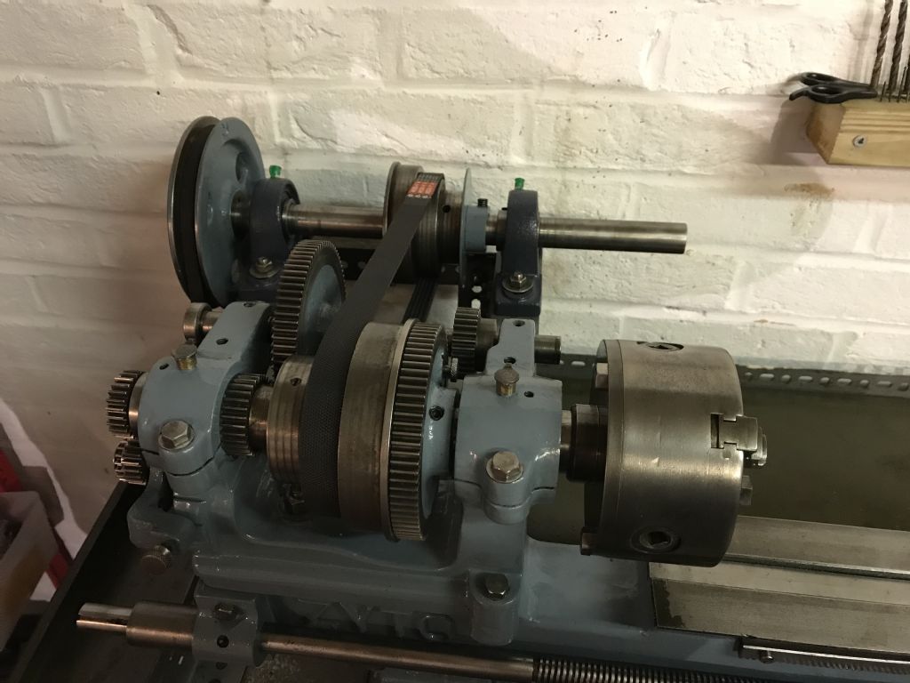

      I have an old Zyto lathe I am restoring which needs new headstock bearings.
      The headstock has oil feed holes at the top to lubricate the bearings which I guess I could fit drip feeders to if needed.
      The old bearings have holes lined up with the oil feeds to get the oil to the shaft surface.
      I have found Oilite "sintered" bronze bearings the exact imperial size I need.
      From what I have read I should not drill sintered bearings as it could seal the small holes existing by the design of sintered bearings.
      So my questions ……
      Will the oilite sintered bearings be OK for the load of an old small lathe headstock ?
      If I don't drill a hole and feed oil through the holes in the top, will the bearings soak and distribute the oil enough to give the required lubrication ?
      Many thanks in advance for your experienced advice

                      No, don't drill oil holes in sintered bearings. Oil dripped in from the top will spread throughout the honeycomb structure of the sintered particles.
                      Yes, sintered bronze bearing should be adequate for use in a small home-hobby lathe such as your Zyto.
                      Solid bronze bushings hand-scraped to finish may bear a bit more load and last a bit longer, but only a bit so not really worth agonizing over. Of course, solid bronze bushings are available from bearing suppliers in most of the same sizes sintered bushings come in, so it would be just as easy to replicate the original solid bronze bushings, which should have an oil hole drilled in the top as the original did.
                      Your choice.

                                  Jim Warren 1
                                    @jimwarren1
                                    Thanks very much for the replies.
                                    Based on all that has been said, I think I would prefer not to use Oilite bearings but after an extensive search I cannot find plain bronze bushes in the size I need.
                                    The size needed is 1” ID, 1-1/8” OD AND 1-1/4” long.
                                    Any ideas where I might find these ?

                                                    #381442
                                                    Jim Warren 1
                                                      @jimwarren1
                                                      Thanks again for all the replies about this.
                                                      I ended up using oilite bearings and I drilled a hole for an oil drip feed.
                                                      It is working well with no play.
                                                      Lets see how it lasts …. fingers crossed.
                                                      Here is the lathe so far
