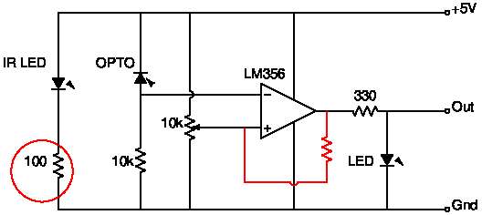

The Arduino IR Proximity detector can be improved too. It’s a simple beast, using an OpAmp rather than a Comparator. (Op Amps can be wired as comparators but their internals are optimised for linear applications. Comparators are optimised for digital work, and flip between ON/OFF rather faster. The performance of the module can be improved by adding a resistor shown in RED below. A touch of positive feedback helps protect against noise and trigger slow rising signals more consistently. (Can’t find my notes: to keep the modification simple the resistor was determined experimentally from a dash of theory, and I can’t see the real one without taking the clock apart. About 100k I guess.) To reduce beam power, the 100ohm resistor ringed in red was increased to 330.
Even better, if money is no object buy a purpose made beam break detector. They come with a built in comparator, beam form with a lens, and protected optics. They don’t have to be wide enough to straddle the pendulum; detect a narrow flag mounted on the rod, above or below the bob.

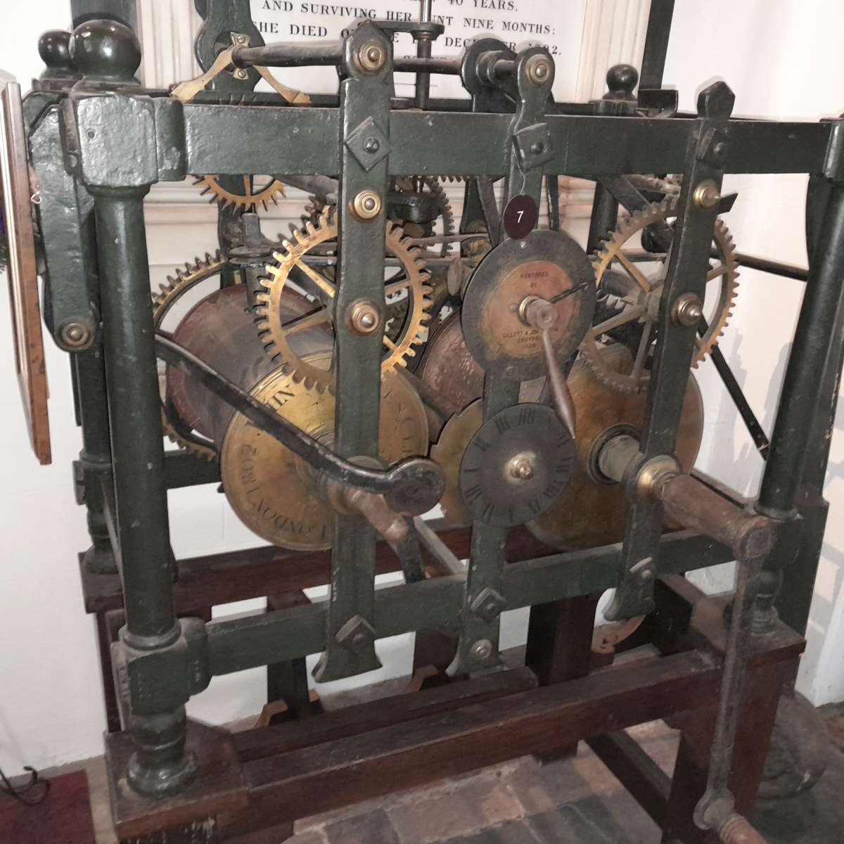

Having finally caught up with summertime and corrected the church clock this morning I am tempted to look into monitoring it. It would be interesting to see how much bellringing and other activities affected it. I’m more attuned to errors expressed as minutes per week.
Coincidentally we had a club member talk about his lantern clock last meeting and as he mentioned tower clocks in passing I popped into a local church yesterday to photograph their ex-clock now mothballed and on public view.
Pendulum was 4m.

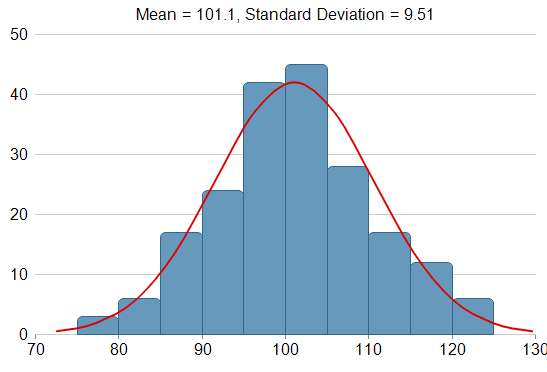

Standard Deviation is a good start, but I suggest you implement a Histogram. The easiest way is to analyse the log on a PC with software that does histograms. The idea is to count timings into, say 1uS, buckets and then look at the shape of the resulting curve. No reason apart from effort why you shouldn’t implement your own histogram on the ESP32. This reveals the Q of the pendulum, ideally a sharp peak, and distortions. These can be due to mechanical issues and noise and mangling due to sensor and computer problems. When measuring in the microsecond region, you should see noise, that is a broad histogram curve rather than a sharp one. Then hunt down the sources and reduce them – if possible! The goal is to sharpen the histogram.

I agree that a histogram would be a very good addition. A running standard deviation might also be good.

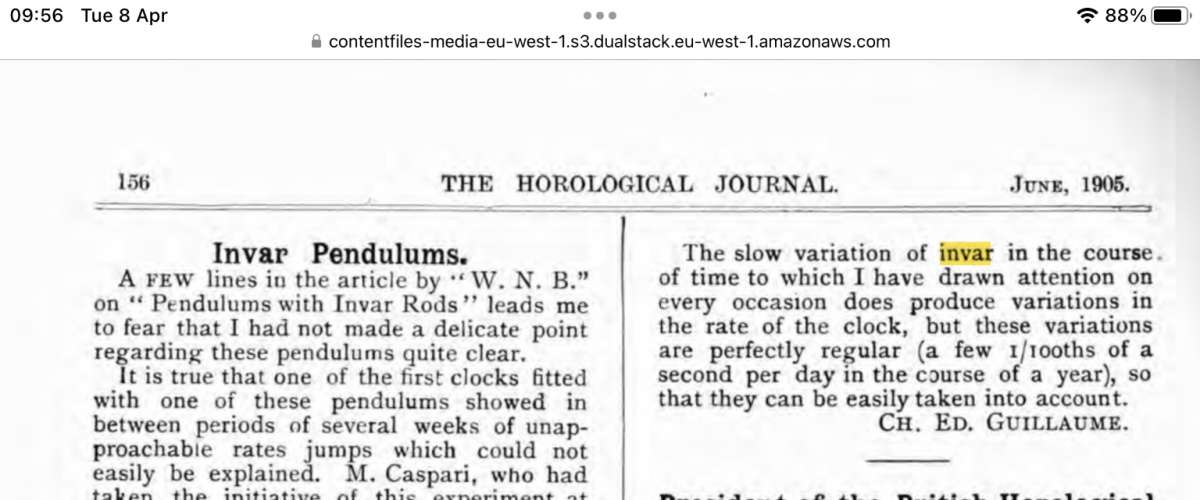

(By the way, I don’t believe that old “Invar spontaneously / intermittently changes length” notion that seems to be unquestioned here.)
Again, great work!
… (By the way, I don’t believe that old “Invar spontaneously / intermittently changes length” notion that seems to be unquestioned here.)
Again, great work!
It remains unquestioned because it was so thoroughly observed and documented.
One reference of many:
https://www.europhysicsnews.org/articles/epn/pdf/1991/08/epn19912208p150.pdf
The way this claim has been presented, here and elsewhere, is that an Invar pendulum rod, sitting unmolested at room temperature, etc., can discontinuously change its length for no practical environmental reason, i.e. “intermittently unstable”. This is what I don’t believe.
On the other hand, I have no doubt that Invar, like all metals, can and will change length under some force (e.g. gravity, etc.). Just not “spontaneously” unless the force was coincident.
From that paper (thank you), I presume you are pointing to “spontaneous volume magnetorestriction.” I’m not a materials scientist, and most of the figures and values in it are presented in atomic-scale units, e.g. “mRy” (Ry is the Rydberg energy; 1Ry ~= 13 electron Volts) and “mu_B” (Bohr magneton, a constant concerning the magnetic moment of an electron). This makes it hard to understand in the context of the more practical units of interest in this discussion. If you care to make a try, by all means proceed!
There is also the question in my mind as to how “spontaneous” transitions of individual atoms can result in “intermittent” or “spontaneous” changes in length at macroscopic scale without some outside force (e.g. perhaps a strong magnetic field) acting on essentially all atoms simultaneously.
Finally, at macroscopic rather than atomic scale, is such an effect even noticeable or distinguishable from other factors such as the residual temperature coefficient? In other words, is it more than just a scientific curiosity in the context of a practical pendulum?
I concede, SK
Unfortunately the literature isn’t accessible. Reading it would change what SK believes.
I define spontaneous as “Happening or arising without apparent external cause”. Nothing in our world sits unmolested, so maybe there is a cause! Sensors placed in a vacuum chamber detect all manner of goings on. So things can and do change ‘without apparent external cause’. We may be having a violent agreement! Semantics…

Michael quotes a letter written by Prof Guillame in 1905 not long after he invented Invar. In 1905 the evidence was still emerging. He wouldn’t have written that in 1915!
All relative though! Invar is still a good choice, it’s just that some Invar’s are better, and Carbon Fibre and Quartz are also competitive. They too have problems, though it only becomes apparent if one builds an exceptionally good clock. Unfortunately, no matter how well a pendulum clock is made, it is always possible to improve it!

On 8 April 2025 at 13:00 SillyOldDuffer Said:
… Michael quotes a letter written by Prof Guillame in 1905 not long after he invented Invar. In 1905 the evidence was still emerging. He wouldn’t have written that in 1915!All relative though! Invar is still a good choice, it’s just that some Invar’s are better …
Well-noted, Dave ^^^
For the sake of prompting further contemplation … here’s a more recent, and easily accessible, document from another field of endeavour:
