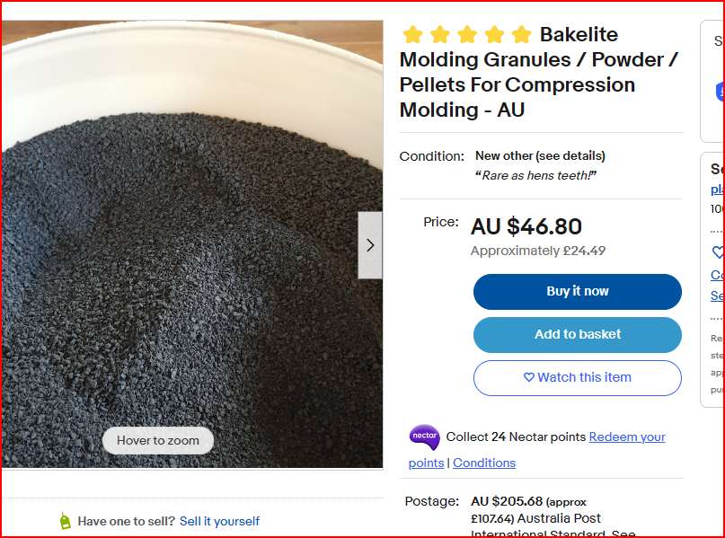

                  Kiwi, I remember doing bakelite moulding in my engineering practice training courses back in the 70s. The material was a dark gravelly powder which we poured out of bags into the moulds. I don’t recall that it needed much force on the mould-halves other than that needed to ensure the powder filled the moulds properly. I cannot remember the temperatures we used but do recall that virtually everyone on the course went home with an defect-free ashtray. So it wasn’t a difficult process !
                  A quick look at the web suggest the powder might still be available, as bakelite still has some advantages, possibly for electrical components, including relatively easy mouldability.
