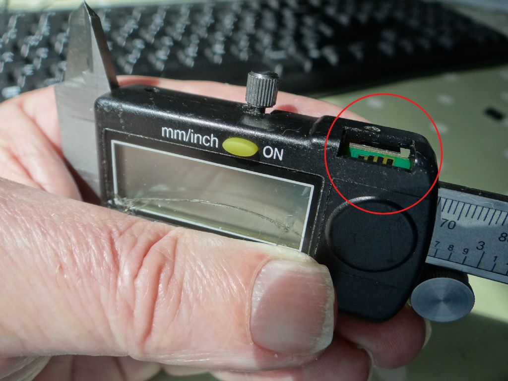

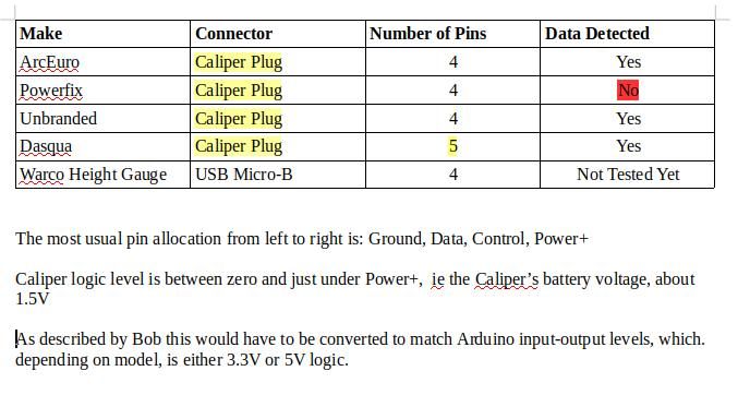

                                                    Poking my calipers with an oscilloscope revealed this:
                                                    The first problem to overcome is the connector, which I've described as a 'Caliper Plug'. I don't think it's a standard fitting so my first problem will be to make one! It has to fit into the rectangular hole ringed red in the photo, which is normally hidden under a cover.
                                                    Anyway, the table shows that one of my calipers won't play, but the other three probably will. The Dasqua has a 5 pin socket (ground on the left) and will need a different plug. Although the height gauge has a real USB socket, it's not computer compatible USB. I expect to find when I've had time to break out the USB connector that the signalling is the same as the other calipers. If so, then not a good idea to plug the height gauge into a computer because the higher voltage computer could damage the caliper and perhaps itself in the process.
