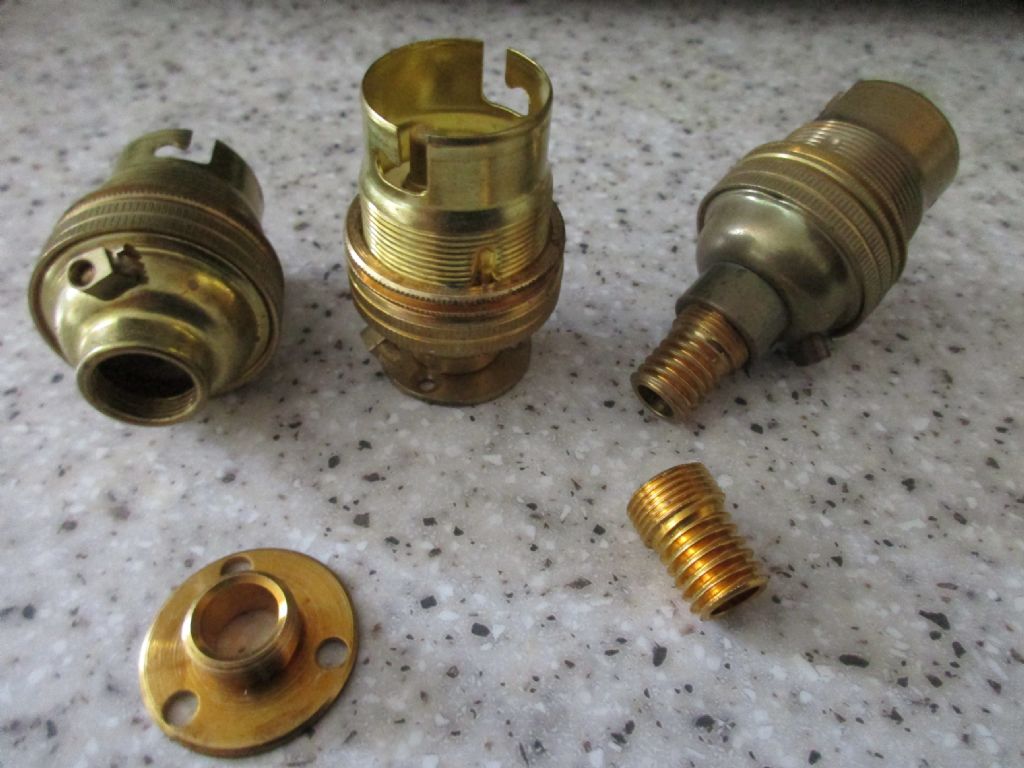

        Good morning,
        I've been sorting through some acquired taps and dies and came across a die with the engraving "3/8 x 26 BRASS", made by LAL ltd England. It's a conventional round split steel die.
        Too fine for BSF or UNF. Any suggestions what it's for?

          Brass thread is a standard thread form. originally used on brass tube wher ethe wall thickness was too thin for a coarse thread.

              Thank you,
              Any idea what sort of things would they have been used for?

                Posted by Bo'sun on 29/01/2021 10:38:36:
                Thank you,
                Light fittings and some plumbing items.
                #523472
                Nicholas Farr
                  @nicholasfarr14254
                  Hi Bo'sun, I guess you can use them for anything you like, but as Chris has said, light fittings are typical.
                  Regards Nick.

                    A thread system that used 26 tpi for all diameters. Thin walled brass tube, hence the name. A common thread in light fittings now is 10mmX 1.0 Noel
