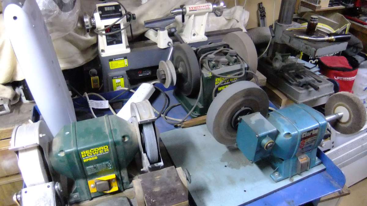

      I have an old Clarkes CBG 8 W dry and wet grinder. Currently, I use the dry side for scotchbrite style wheels for cleaning metal and the slow wet wheel is not being used.
      So my question is this will a diamond cup or bowl wheel be suitable to be run at about 135 RPM. They will fit all be it that I will need to make some parts to mount it.
      This is the type and size I am looking at.
      I can make an adjustable table for it. I will be looking at sharpening some of my lathe tools.
      #831102
      noel shelley
        @noelshelley55608
        NO  ! You  will quickly destroy the wheel at that speed. Diamond is fine for carbide but a white wheel for tool steel. In both cases run at their correct cutting speed. Noel.

                      My grinding table the heater is now set up somewhere else. The whole table/draw unit is on casters. I do have a spare motor which runs at 1250RPM which I could mount where the heater wasgrinders (1)
                                  Sorry. Yes I know why you wanted to use an existing grinder. I just wondered why others were advocating low speeds?
                                  I had a grinder like that. The inside was very poorly constructed, particularly the main shaft.
                                  I think You could probably remove the gearbox and mount a grindstone directly on the shaft?
