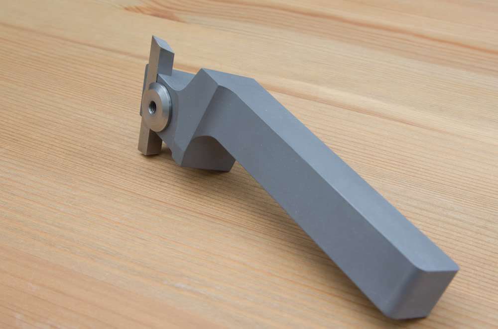

          Vic
            @vic
            I use mine a lot. I’m quite capable of grinding HSS tools but it’s so quick and easy for the Diamond tool and uses up small pieces of HSS.
            Having said that I mostly use my home made version. The commercial one only comes out if I need to use carbide for something tough. This is one of my home made ones.
            IMG_1296
            #780318
            Vic
              @vic
              I should have said that the commercial one takes round and square tool bits. My home made one only accepts square. Hence my comment above. I’ve used old broken carbide mills from work with the commercial tool.

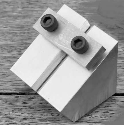

                                                  Vic
                                                    @vic
                                                    On Phil P Said:
                                                    However I am not too keen on using the supplied sharpening jig as it leaves a hollow topped tool due to the grinding wheel radius.
                                                    Phil P
                                                    No, nor was I. I made one similar to this and use it with a belt grinder.
                                                    IMG_3338
