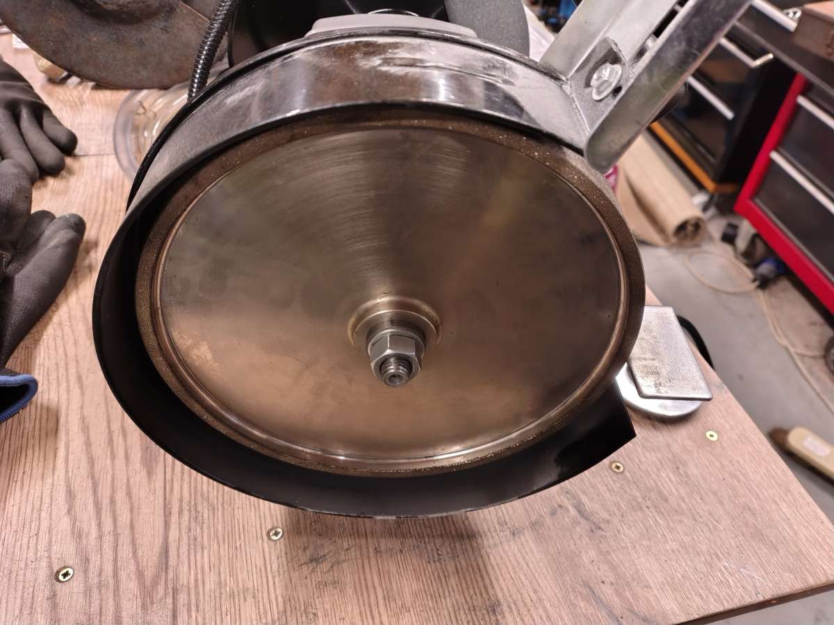

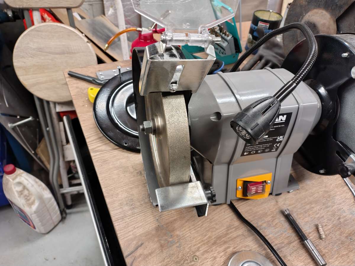

      Hello all
      A little while ago I asked members of their experiences with cheap diamond grinder wheels on a bench grinder. I had a few replies but no-one who actually had one so I decided to go ahead and buy one.
      Despite warnings not to buy a cheap chinese one, I did exactly that and bought an 8″ wheel from Temu for £34. It arrived in 3 days, all nicely packed. My first impression was ‘very heavy’. This is a solid steel (plated) item with diamond dust impregnated on the surface.
      When I went to fit it I found that it was a light press fit on the shaft. This is not desirable as I might want to change the wheels and tapping it on and off is not an option for me anyway. It also seemed like the bore had a very slight taper as it went part way on one way and would not fit the other. I eased the bore slightly with an expanding reamer so that I could fit by hand.
      On switching it on it was slightly hesitant to get going due to the weight of the wheel. My grinder is 500 watt brushless and is probably the minimum power you will need to spin this thing up. Before anyone comments on the dangers of it catching fire and  my insurance not paying, I am happy with that neither of these things are issues….
      Once running it runs true and very smooth. The flywheel effect ensures that, it just hums quietly.
      For grinding tools it is amazing. It removes steel, hss and carbide at an alarming rate. Quickly and efficiently. It removes metal so quickly it doesn’t seem to have time to get hot! It’s great for grinding drills as well as it is so smooth and vibration free.
      A great cheap addition to the workshop. I will add – this is only for grinding tools and nothing else.

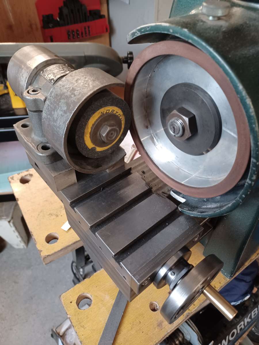

        I bought a diamond wheel for my Taylor Hobson  cutter grinder which I added a tool rest to rest turning tools etc and it worked well. It is a cup wheel from Arc Eurotrade 150mm dia with 3mm depth of diamond on an aluminium body. the wheel is a perfect fit on the arbour with no play and runs very true. It was perfect at first but I have added a cutter grinder to sharpen mills and drills etc and having used the wheel for grinding carbide cutters some steel part tools and the occasional piece of glass for the wife for her stained glass work and now it needed a bit of dressing to get it back to flat and cutting well. I bought a diamond dressing attachment for it, (which cost £100.0 ish on eBay), and after dressing it now again cuts as good as when I first received it.
        20250220_154229
        Dressing the wheel face.

            We have to remember that Peter’s wheel is vitrified and David’s is bonded and can be trued.

              Yes, my wheel cant be trued. It does however run much more true than a dressed stone wheel, or appears to, to my eyes. This is very noticeable when grinding drill bits freehand, I hardly seem to be touching the wheel and all the time it is removing material quickly, much more quickly than a normal grinding wheel.
              Another thing to consider is that there is no ‘dust’ from the wheel itself when grinding.

                  my wheel is 180 grit. On the face value that seems rather coarse, however when you think about it 600 grit would be so fine as to remove hardly any metal and would basically be polishing which is not what I want it for. I want it to remove metal. I have some broad fine grit diamond files that I use for finishing tools if required. However looking at the tools that I have sharpened I am happy with them, after all carbide tools are not sharp like HSS. I would touch up HSS tools as a matter of course.
                  Pete
