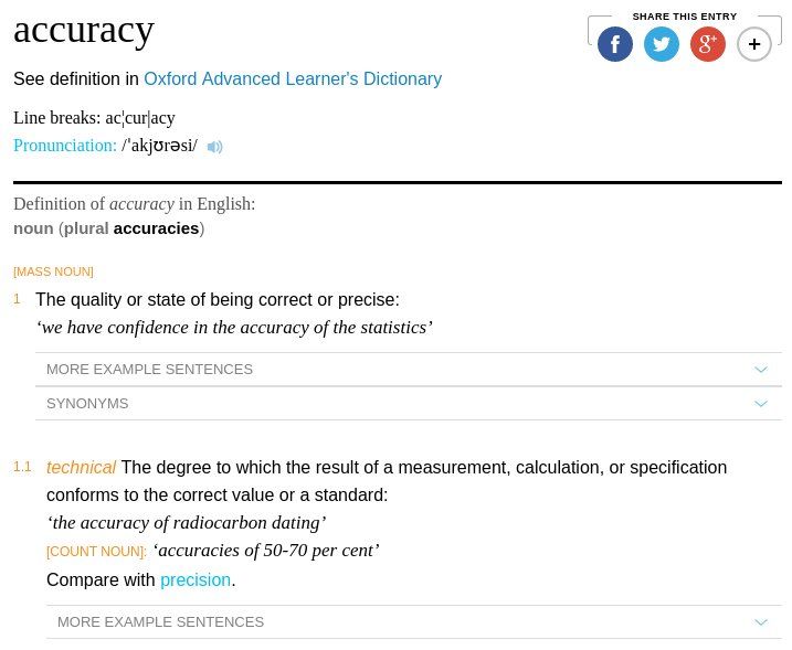

                                      As I am a Brit I get cheesed off with both pedantic use of the English language and certain august bodies choosing to alter the meanings of word to suite their own specific context – as do physicists with words like colour and flavour which is a little more excusable.
                                      This is what the oxford has to say about it – it would have far more in the actual dictionary but it's a fact that the 2 words can be interchangeable in certain contexts. They are both meaningless without further information anyway.
                                      I used to shoot precision 22 rifle. I might say that I can shoot 22 rifle with a high degree of accuracy.
                                      What I have just said about my 22 rifle shooting doesn't really mean anything unless more information is given.
                                      Precison 22 also needs more information. A bull in precision 22 rifle involves the equivalent of hitting a pin head at a certain distance.. Normal 22 or small bore as 22 is usually called uses a much larger bulls eye. The distance is the same.
                                      High degree of accuracy. I might say my 10 shot average is 98.8, which it was providing I used competition rounds. But that doesn't mean much either unless i say this was shooting precision small bore. The competition round was worth one extra bull over the ordinary ones. Another factor – bit like using Mitutoyo rather than something less thoroughly statistically checked. I can only think of one instance when I failed to get 100 with the other type of target. Shooting against the army using their guns that they kindly provided with miss set sites in order to try and beat us so my first 2 shoots were out of the bull.
                                      blushI'm not keen on Americanisms either. winkThey should leave our language alone.
                                      Edited By Ajohnw on 12/02/2016 23:50:01

                                          The OED may document English as she is spoke.
                                          That doesn't help much when we are trying to better understand a technical issue and using words in the narrow senses associated with a particular topic.
                                          Think of the 150 years of confusion because of how people interpreted Darwin's use of the word 'struggle' in the context of natural selection… (e.g. as a conflict between combatatnts rather than as individuals against the odds).
                                          I thought I'd google 'NPL Accuracy precision' and see if anything helpful appeared, and lo!
                                          http://www.npl.co.uk/upload/pdf/Accuracy%20and%20Precision.pdf
                                          (I honestly haven't seen this before).

                                                  It seems NPL have a lot to do with the inadequacy's of some model engineering items – all things can be called high precision and people can finish up with something that doesn't meet up with their expectations.
                                                  It's just another case of some specialised field trying to change the meanings of words in their field – jargon in other words. Something that is wide spread and should be discouraged as usually there is no need for it.
                                                  Numbers have precision. A/D and D/A's have precision, in that case there precision can not be better than +/- 1bit at what ever physical resolution they work at. The other errors relate to what ever reference they use. That can be all sorts of things including any of them being held at a closely controlled temperature. The same statement could also be stated using the word accuracy. The power of the English language – context. They also have linearity errors. In all cases where these 2 words are used it's the error in obtaining the figures that is the important aspect.
                                                  A could example of context is the word tap. I can turn a tap on, use a 1/2 bsw tap, tap a tree, tap a table or even tap dance. Just like accuracy and precision the word is meaningless without further information and once the information is available the meaning is clear.
                                                  Precision small bore has a related message as well. The quality of the bullets. A score of 100 would be a fluke with standard rounds but would be possible with the normal targets. Some one might look at the precision targets and say that's not the same as hitting a pin head due to the size of the bull. Some one would then have to explain that outward scoring is used – touch a line and lower score is used. The other form is inward scoring. One target has 10 small ones on each sheet because a bullet might pass through the same hole or it might have missed the target completely. The other form has single large target. The bullet might tear the target as it goes through it. Precision uses a gauge, a magnifying glass with a bullet end sticking out of it. An approved person has to make the decision. Bit like using a mic really. Some people will get more precise actual real readings from them. The word accurate could also be used.

                                                      You can't blame NPL.
                                                      This meaning was codified in international standards in 1994 with ISO 5725-1:1994.
                                                      For anyone with insomnia, this is chapter and verse on all the terms associated with metrology. I suggest taking paracetamol BFORE reading it:
                                                      /www.bipm.org/utils/common/documents/jcgm/JCGM_200_2008.pdf
                                                      BIPM is the Bureau International des Poids et Mesures
                                                      Edited By Neil Wyatt on 13/02/2016 11:08:44
