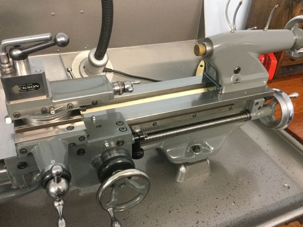

      Since buying my Super 7 earlier this year I have occasionally noticed that the tailstock makes a noise when I slide it along the bed, the culprit being a speck of hard metal usually found at the end of a scored line on a sliding surface of the tailstock and when I dig it out with a scribe normal sliding is resumed.
      My question then is, is there a die or a special light that might highlight such pieces of embedded material to aid their detection?
      Colin

          Doesn't sound good, nor normal. Have you been machining something like cast iron that generates small hard particles? Or using diamond files or other abrasives on the lathe? If so, the only cure is a thorough cleaning, with maybe a partial dismantling.
          You can also put a felt wiper along the leading edge of the tailstock base to stop particles getting under the base. Hemingway sells a kit for this. But a piece of felt from the hardware store sold for putting on the bottoms of table legs etc will do the job, with a sheetmetal holder and a couple of screws tapped into the base.
          I don't know of any dye or light that might help. Usually, the human fingertips can feel particles as small as one thou or so. Use the tip of the ring finger of your left hand (if you are right handed) as it will be less calloused and more sensitive than the index finger or the more-used right hand. (Old toolmaker's trick.)

                  +1 for adding a wiper to the tailstock. I fitted one to my Super 7 several years ago, and as Brian says, with the felt well oiled and the bed clean, the tailstock simply glides along the bed.

                    I've now put a tailstock wiper on my to-do list but my original question on how to detect such things remains and I wonder if the light from a laser aimed at low angle to the surface being inspected would refract off a rubbed bright embedded piece of metal and perhaps show some pieces I can't see or find, and show in an instance how clean or contaminated a surface might be?
