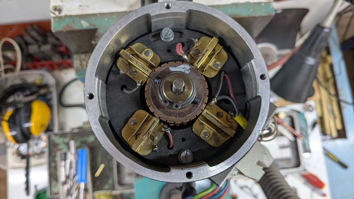

                    I’ve taken a more detailed look at things, which I should have done before my original post. First thing is that I’ve been reminded again of the excellent build quality. There is a tachometer built in to the top of the motor, which is a DC brushed type. The tachometer is a type I’ve not seen before, a spindle commutator with four brushes wired to output wires labelled T1 and T2.

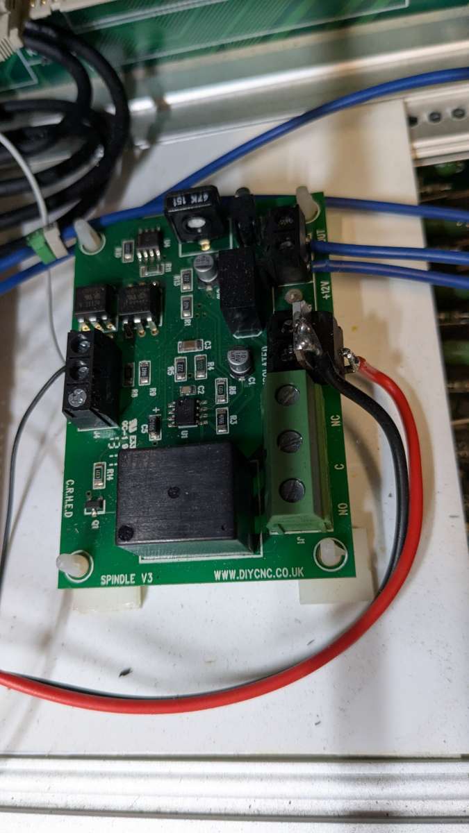

                    I’ve also discovered that that a small spindle control board has been retro-fitted as part of the parallel port conversion. It’s a DIYCNC Spindle V3, which supplies 0-10V to the Sprint drive. I bought one of these when I was converting my Orac- I didn’t use it at the time, so although I still suspect component failure on the Sprint board, I might as well fit the unused one anyway as a process of elimination.

                      <p style=”text-align: left;”>That’s an opto isolated control which suggests that the motor drive unit does have a live chassis. Beware!</p>

                            Hmm the TRIAC diagrams I found had AC spindle motors.
                            How are the brushes on bothe the tachogenerator and the motor?
                            Rather than risk damaging your spare board if ther is a fault in the motor, you coud try running it off a dC supply and measure the output of the tachogenerator at various speeds.

                              Thanks Robert. The tacho brushes show little wear, no dust or other debris. I’ll look at the motor brushes later, but I’d have thought that a problem there would cause a drop in revs, not racing flat out. I don’t have any equipment for tacho/motor testing, and I think it’s beyond my limited expertise anyway.
