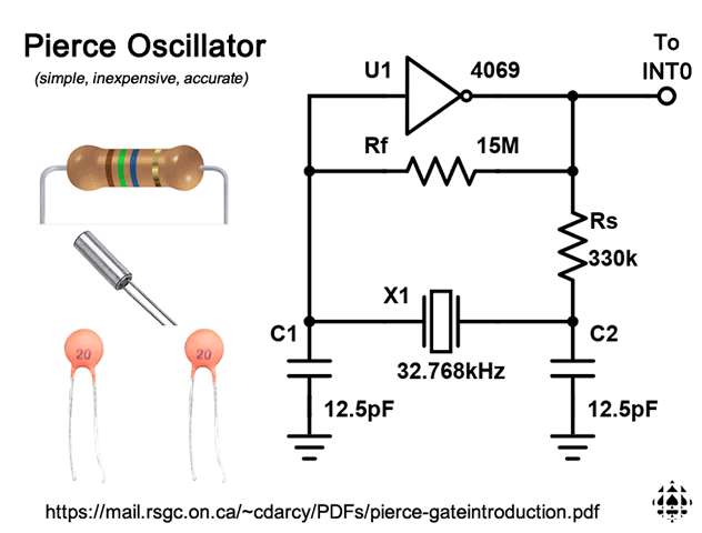

        #779272
          On Steve Rowbotham Said:
          Whilst you [Joe] suggested the oscillator looked fine based on the AC coupled waveform I posted a few posts back, the fact is that both OSC pins have a bias of 1.6V, with a 0.22V pk-pk 8MHz on OSC OUT and 0.36V pk-pk 8MHz on OSC IN – is this OK to drive the CPU clock?
          Almost certainly yes.
          Building on Joe’s answer, the crystal doesn’t produce a signal on it’s own, it’s only the frequency determining part of an oscillator circuit.  A transistor or logic gate inside the chip provides the power.   A circuit like this example, other configurations available:
          PierceOscillatorInt0
          The computer’s clock is driven by the output of inverter U1, not by the crystal. The output in this diagram is labelled ‘To INT0’.   Although the oscillator’s output will be close to a square waveform, it’s usual to clean it up and buffer the oscillator by feeding the signal through a second inverter.
          U1, Rf and Rs are inside the chip.  Only C1, X1 and C2 are outside on the printed circuit board.  That the crystal has a signal on it at all indicates the oscillator is running, therefore the crystal isn’t the problem.

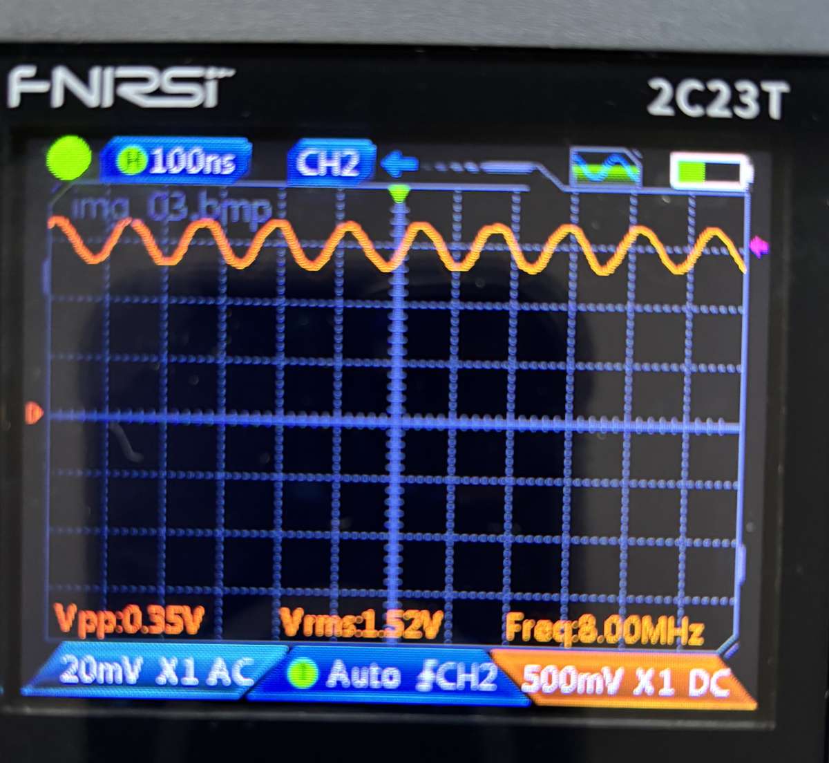

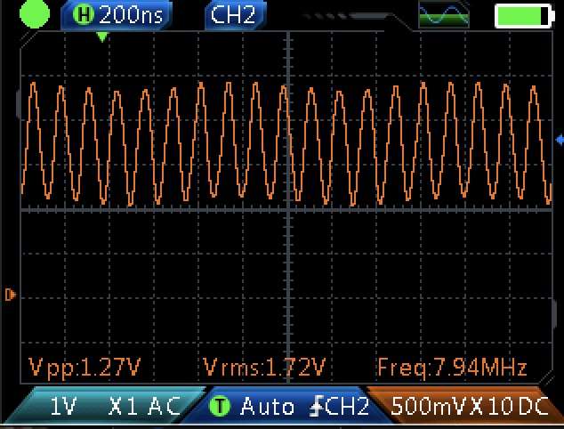

              #779377
              Steve Rowbotham
                @steverowbotham77083
                Robert, both scope & probe were set to x1 for the below trace. Scaling is set to 0.5V per div and 0v is set at the centre line, so you can see the 0.35V pk-pk oscillation on 1.6V DC bias. The oscillation amplitude is small, hence why I questioned if OK.
                IMG_3079
                #779416
                Robert Atkinson 2
                  @robertatkinson2
                  Try setting the probe to x10. This reduces the electrical loading on the circuit.
                  350mV is too low The calculated voltages shown on the ‘scope don’t make sense. The RMS value is less than the pk-pk.
                  Robert.

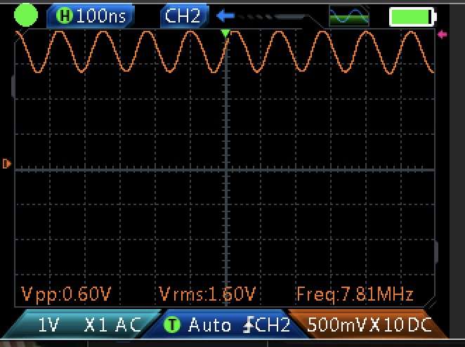

                  #779443
                  Steve Rowbotham
                    Robert, this is the result with x10 (on scope & probe), Vpp increased to 600mV.

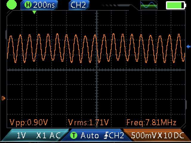

                    #779449
                    Robert Atkinson 2
                      @robertatkinson2
                      That still seem a bit low.
                      What is the signal on the other pin connected to the crystal.
                      Robert.

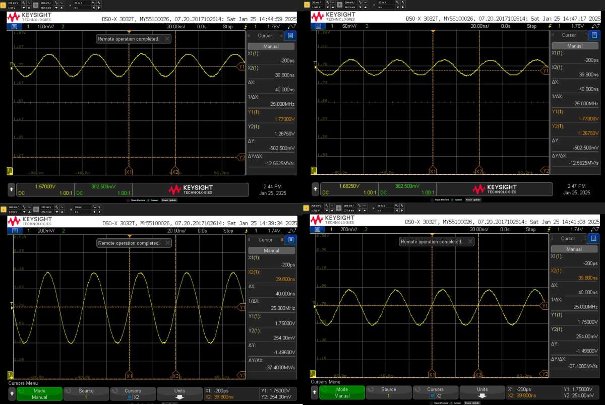

                        #779890
                        Joseph Noci 1
                          @josephnoci1
                          Steve – nothing wrong with your signals or levels. I suspect the ‘lower’ than normal per Roberts definitions is a trait of your ‘scope and probes – I recognise that scope – absolute voltage levels are not precise…If the probes are the set that came with that scope, they do add to the loss in signal levels.
                          Here are some scope captures with HP 500Mhz probes with a probe capacitance of 7pf, scope input impedance in x10 = 1meg ohm.
                          traces are in x10 and x1 modes, on a stm32f401 running @ 25MHz.
                          Left images are on pin 5 (oscIN), right on pin 6 (oscOUT)
                          Top pair are x1, bottom are x10
                          The Y1 cursor is more or less in the centre of the AC waveform, and the DC offset is typically 1.75volts.
                          For the x1 traces – oscIN = 120mv pp and oscOUT = 50mv pp.
                          for the x10 traces – oscIN = 800mv pp and oscOUT = 400mv pp.
                          These sorts of voltage are very typical of most general purpose microprocessors. Even the ATMEL-328p on the arduino mini boards shows similar waveform levels.
                          STM_Oscillator
                          #779896
                          Steve Rowbotham
                            Thanks for this Joseph, very useful reference info for those that follow, and yes the probe is the one that came with the device. Time to buy a new DRO readout, this time to be powered from a spike & surge protected mains supply.

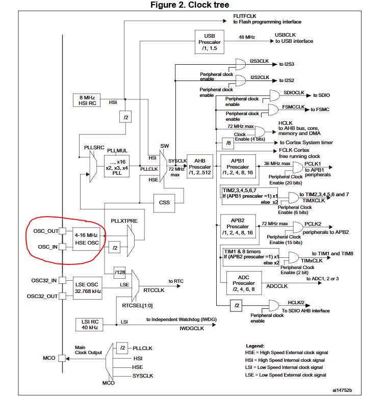

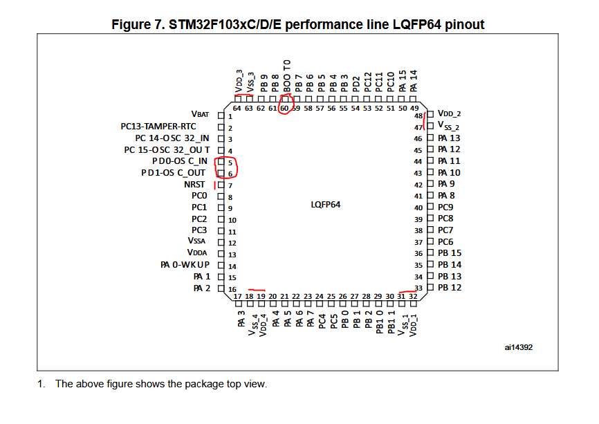

                              #780051
                                Again building on Joe’s comments, I looked at the CPU pin-out to see which, if any, pins could stop the CPU.  Only 4, I think, NRST, OSC-CIN OSC-COUT, and BOOT0.  All discussed already.  We know OSC-CIN OSC-COUT are OK.    A fault on NRST would have the CPU permanently resetting itself, never doing anything useful.  A fault on BOOT0, as Joe describes, would have the CPU trying to boot from the wrong memory, again never starting.
                                Power failure is off the agenda I think.  The chip has 4 power feeds so plenty of redundancy.
                                stmpinout
                                A diagram in the datasheet shows how complicated the clock is.  ST describe it as a ‘clock tree’.
                                I’ve red-ringed the oscillator but it’s only the beginning!  The 8Mhz crystal oscillator is multiplied by a Phase Locked Loop to produce the actual clock at up to 72MHz.   Thus a fault in the PLL would kill the CPU, and, because it’s buried inside, there is no way of fixing it.   Cure: replace CPU, probably cheaper to replace the whole board.
                                clocktreeMany reasons why a chip might fail prematurely.
                                Manufacturing Faults.  They’re made by growing a giant ultra-pure crystal which is carefully doped to semi-conduct.  The chemistry is high-tech.   Then the crystal is mechanically cut into extremely thin slices, that are carefully polished, zero dirt.  Another high-tech process.   The slices are masked and photographically etched with hundreds of CPUs on each slice, accuracy in the nanometre region.  Yet another high-tech process!  Then individual CPUs are cut from the slice and mounted in a chip with wires spot-welded to the pins with micrometre precision.  More high tech.
                                Only at this point can the chip be tested. All being well, each of those high tech production stages will be ‘good enough’.  In practice, a proportion will be faulty.  And some will be faulty in a way that might fail years later – cracks, impurities causing corrosion etc.
                                Hot chips in a circuit don’t last long, especially if they are corroding inside due to a manufacturing fault.
                                Solar radiation: as the chip is tightly packed with components, they can be damaged by high-energy particles.  The same particles can cause cancer by crashing through our DNA, so cells replicate incorrectly.  Rare, but it happens.
                                Pins soaked by condensation is more likely.  Condensation is far from pure, especially in a grubby workshop. It’s acid, oxygenated, dirty and conductive.  If all the pins are shorted together and/or to earth by condensation, untold damage can be done inside the chip.
                                Spikes on the mains aren’t unusual.  Static electricity very unlikely, but…
                                There are other possibilities.
                                All this adds up in my mind to, ‘if it ain’t an easy obvious fix, replace the board’.
