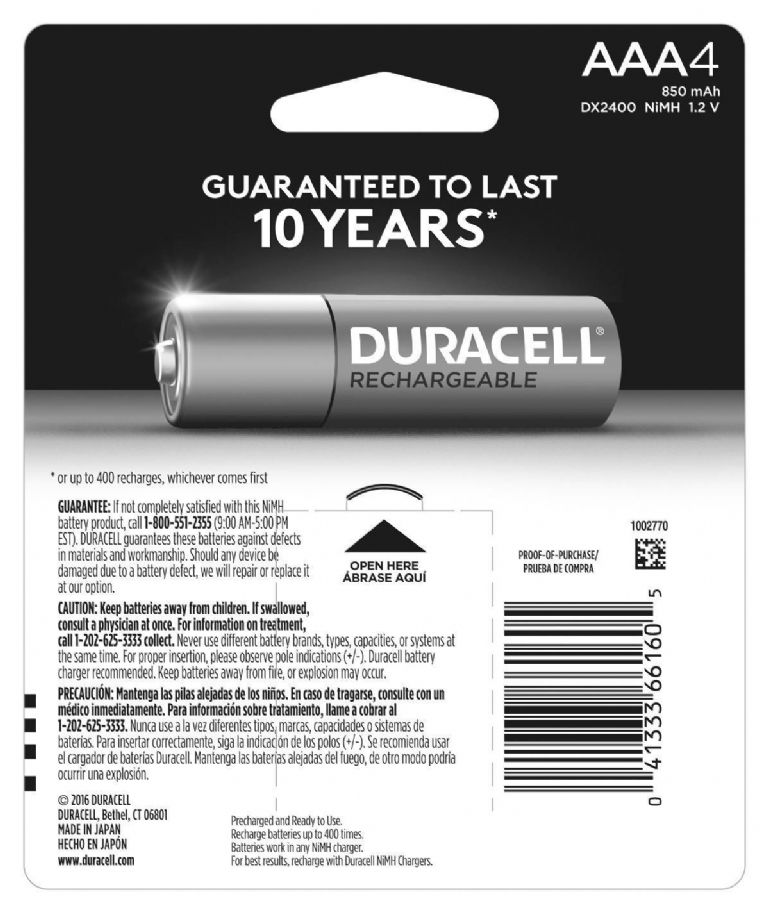

                                    #462952
                                      Thanks, Joe … If you say so, I am inclined to believe it .
                                      That said; I have yet to check how the discharge curves compare with the trusty SR44
                                      #462961
                                      Joseph Noci 1
                                        @josephnoci1
                                        Posted by Michael Gilligan on 07/04/2020 11:59:46:
                                        Well, not sure yet that I believe it…
                                        At least one of the advertised cells achieves this through trickery – a DC-DC built in to the cell, the latter appears evidently to be 3.6V chemistry. The DC-DC converts to 1.5V, and also seems to be the 'charger' when charging the cell from 5V ( a USB port, it would appear).
                                        The advertised 1.5V rechargeable DURACELL's – I have failed to find an image of the cell, or a blister pack image of 'cells' actually showing the depicted 1.5V on the cell itself! Also, non of the MANY vendors of this specific cell have any in stock! Phantomware?
                                        Anyway, assuming life is good, and the so called 1.5V rechargeables all use an integral DC-DC, maybe with all the fanfare regarding the caliper's noise sensitivity, the cell won't work anyway – perhaps the DC-DC noise will be an issue?
                                        Regardless, I was just stirring a little – As Michael asked – show me a 1.5v rechargeable cell where the native chemistry results in a direct nominal 1.5v .
                                        Joe
                                        #462966
                                          Well … The Duracells are certainly off my list of candidates
                                          Here’s the back of the package:
                                          #462980
                                          Anonymous
                                            SoD: Ok as far as it goes. thumbs up But I'd expect the problem to be due to noise direct from the DC-DC converter, not external pickup.
                                            Andrew
                                            #462981
                                            Joseph Noci 1
                                              @josephnoci1
                                              That 'advertising' for you! Blatantly stating 1.5V but not letting one see the truth…!
                                              Joe
                                              #462995
                                                Hidden in plain sight, Joe
                                                The photo is grabbed from the link that you provided.
