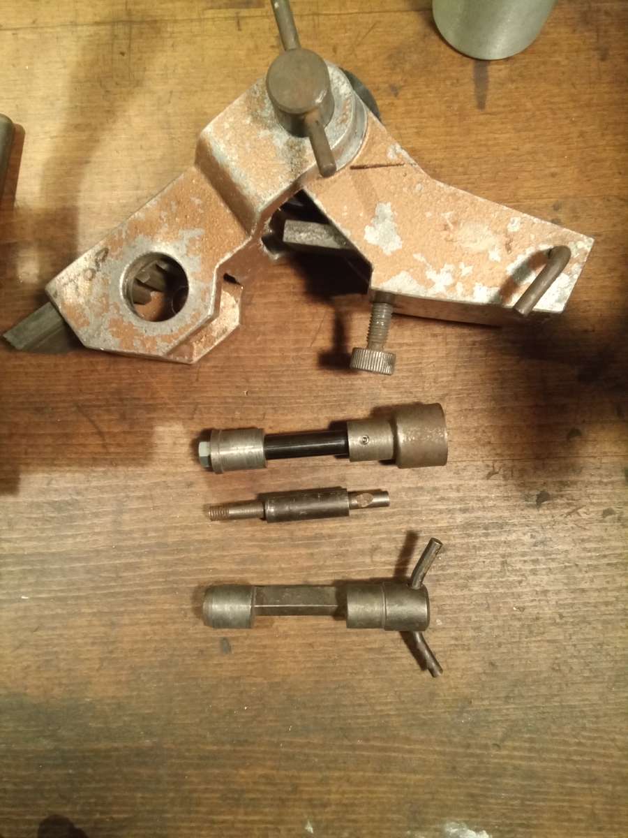

      I bought a CZ bender today  https://www.model-engineer.co.uk/wp-content/uploads/sites/4/images/member_albums/93892/558708.jpg and its missing a few bits.
      I think 7, 9, 14 are missing.  I can work out what 14 is like. But could do with some ideas what 7 and 9 are like. Is there anyone who will give me some hints/ dimensions please?

          9 and 10 are just a pair of collars to fit the top and bottom mandrel holes in the frame so that you can use 4, 5 and 6:
          20250908_195902
          Mine were missing too so I made the above (I didn’t have the article you link to, so just had to guess what it was like) – I could give you the dimensions tomorrow, but you’re probably better off making them to fit your parts.
          I have to say, despite the suggestions in the article, I’ve always found this thing incredibly difficult to use – a shame, because it seems like it would be a useful bit of kit, given adequate instructions.

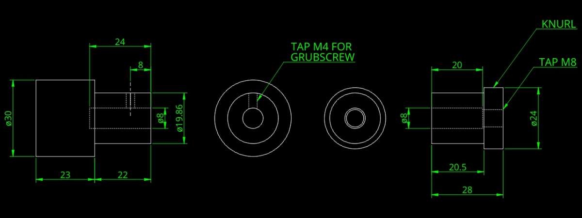

                This is what I made to replace parts 9 and 10 (approximately – I used a separate nut on the end of part 10, possibly because I was just using up a bar end. The 19.86mm dimension is for a nominal 20, I suppose):
                CZ_BENDER_PARTS
                Part 14 is whatever size you want it to be for the pipe diameter and desired radius you’re using.
