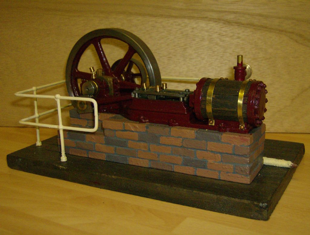

            Tom Walshaw used to stick the lagging strips to thin material (such as an old cotton hanky) to keep them in line. I just glue them on one at a time with superglue.
            back of the model
            Perhaps not the neatest job, but they haven't moved when run on steam. 1/12 scale, so about 1 1/8" diameter at the flanges.

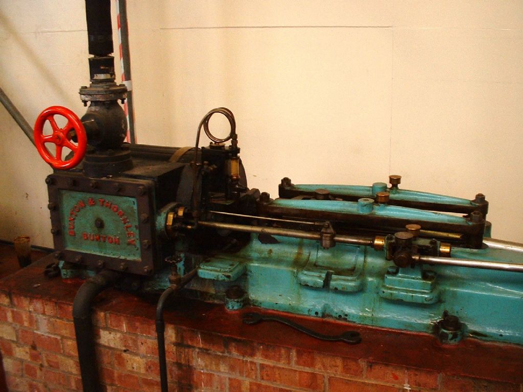

                              Tom Walsahw insisted that most lagging material was a waste of time in small szies, but balsa (if kept dry) was good.
                              In answer to the question, I just glued my strips direct to the cylinder with no other lagging. Naughty, but it worked.
                              The original has wooden lagging (note my model isn't accurately to scale… more sort of inspired by!)
                              The original again

                                Has anybody else used superglue to glue the lagging to the cylinder ? I would not have thought it would tolerate the heat very well.
                                #196120
                                  'Service temperature' is typically about 82 degrees C, but I don't run that engine on steam for long periods – I've only steamed it 2 or 3 times, it usually runs on air. The brass strips would stop the strips falling off, the glue just held them neatly in place while I fixed the strips, I suppose.
