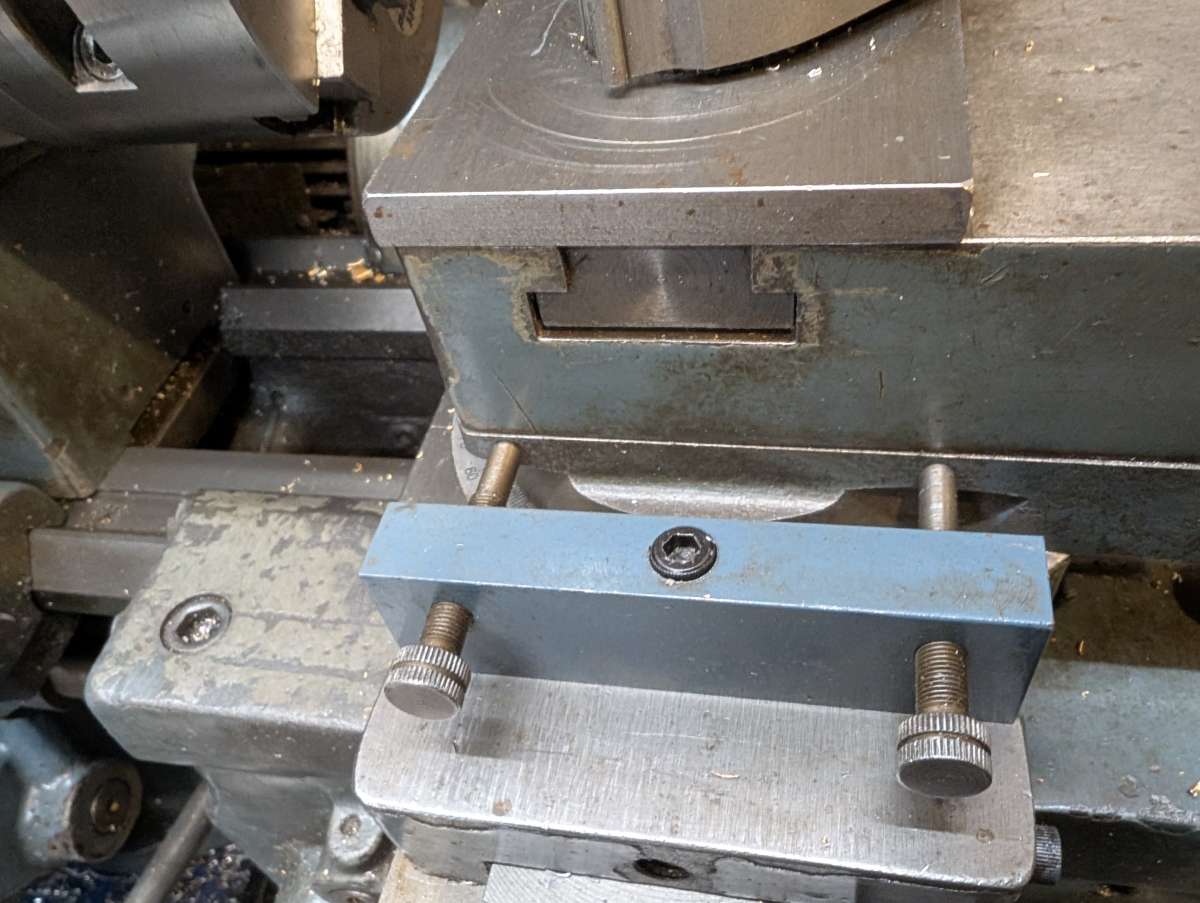

                    On the taper turning side, any advice on setting the top slide accurately would be welcome. I think I’d be struggling to reproduce the same taper setting exactly now I’ve set the top slide back to a normal position for parallel turning. Using one of the plugs (I made a couple of extra plug blanks with the original two so could stick one of these in a collet) as a pattern would be a problem because of their size.

                      To set the topside you can use a parallel bar in the chuck, a dial gauge mounted on the toolpost, and some trigonometry to work out how much the dial should move over a given distance of slide travel. Setting the topslide to reproduce the existing parts is not so easy.

                            When ever I have needed matching tapers, the internal and external tapers have been made without altering the angular setting of the Top Slide.
                            But for smaller sizes, a boring bar cannot be used, obviously.
                            What ever setting of the top Slide is used to produce the taper on the D bit will be reproduced in the drain cock body.
                            Probably, as long as the tapers match the exact angle will not matter too much, whether 7 or 8 degrees.

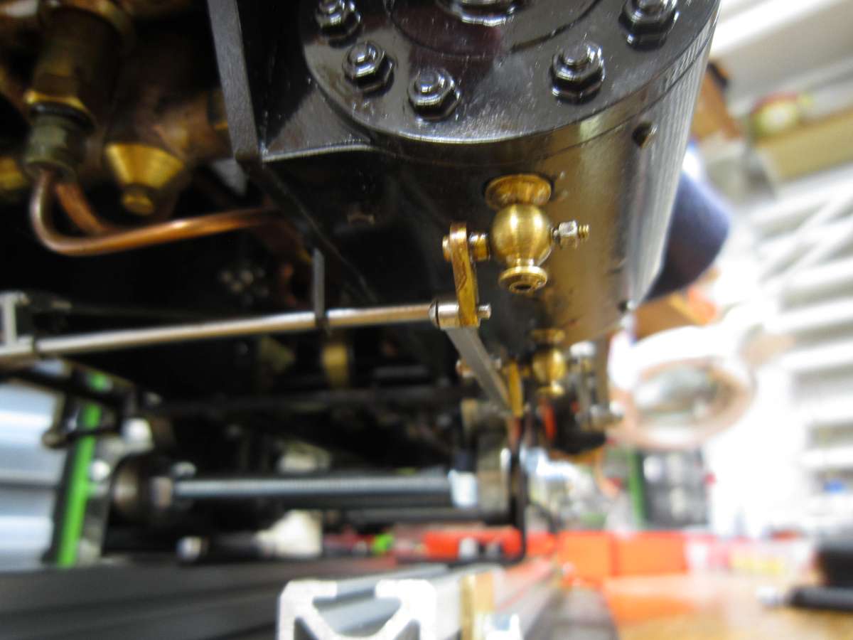

                                              One my latest locomotive, a 3.5-gauge Juliet, I made the draincocks as described by Kozo in his book about the Pennsylvania A3 Switcher. I drilled and reamed the hole through the valve body 2.5mm and then turned a piece of brass to fit the hole.
                                              This design works verry well and they don’t leek. I have not pressure tested them, but cylinder pressure is a lot lower than boiler pressure, as indicated by the pressure gauge attached to the steam chests. Boiler pressure is 80 psi and steam chest pressure has never gone above 40 psi.
