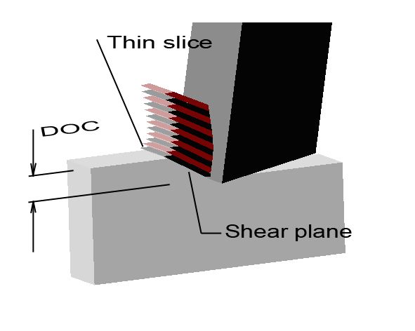

                                Further to my previous posting, I have to say that I haven’t been grocery shopping this week. That is the domain of my dear wife.
                                So, although there have been no requests for a photograph, I don’t have a fresh tub of margarine to demonstrate the action of how metals actually `cut’. Instead, I’ve cobbled up a simple diagram to show what I remember of the so called `cutting’ action.
                                My hypothetical diagram is based upon a simple cutter (tool bit) shaped like a wide parting-off tool, and placed as if it were installed in a toolroom shaping machine or indeed a planer.
                                The tool bit is tilted back at an angle of 10 degrees to provide top rake, while the underside (actually known as the front face or end relief angle) is also backed off by 10 degrees. For simplicity, the workpiece is narrower than the width of the cutter. As usual, DOC indicates depth of cut.
                                Although I have tried to explain this in my previous posting, the diagram and a few more words may help.
                                As the cutting tool first makes contact with the workpiece, the metal of the workpiece starts to be compressed locally ahead of the cutter. Suddenly, when the compressive stress exceeds the shear strength of the metal, the metal gives way at an angle to the direction of tool travel. (This angle is known as the shear plane, and is related in particular to the metal properties and the top rake of the cutting tool. There will be ME readers who can no doubt, explain the theory better than I.)
                                Driven by the advancing cutter, this thin slice of metal momentarily `slides’ over the workpiece along the shear plane. Almost immediately, the shearing action stops, and the tool tip begins once more to compress the metal of the workpiece. Again a thin slice of metal is `dislodged’ and slides over the workpiece. The process is repeated at a rapid rate, and a ribbon of swarf curls off the tool tip. It is usual to see the shark-skin appearance on the inside face of a piece of swarf.
                                For clarity in my diagram I have shown the thin layers in alternate colours. Clive has clearly indicated that there is a lot of heat energy generated during this shearing action.
                                This reminds me of the time when I was bending down near a shaper already `cutting’ metal. While searching for some bolts and clamps in a tool box, a very hot piece of swarf landed on my head. As I tried to brush it clear, it wrapped itself around my finger while still hot enough to continue to burn anything it touched. There was a strong smell of burning hair and skin, and my language was not that of a gentleman.
