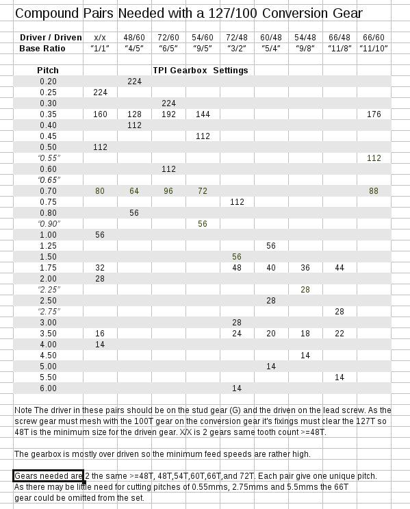

      This is the one that I use more often. All but one of the gears come with the lathe. They use one as a spacer.
      winkHowever people on the yahoo boxford group come along lusting after the 100/127 gear on the basis that it's more accurate even though lathe screw cutting is not that accurate really anyway.
      #207292
      Ajohnw
        @ajohnw51620
        I do have the 127 – 100 so if I need to set a compound train might as well use it. This works out as follows but there will be other gear pairs that will do the same thing.
        Newer machines seem to have switched to a 120 – 127 gear. I assume that's to get round the mesh problems.

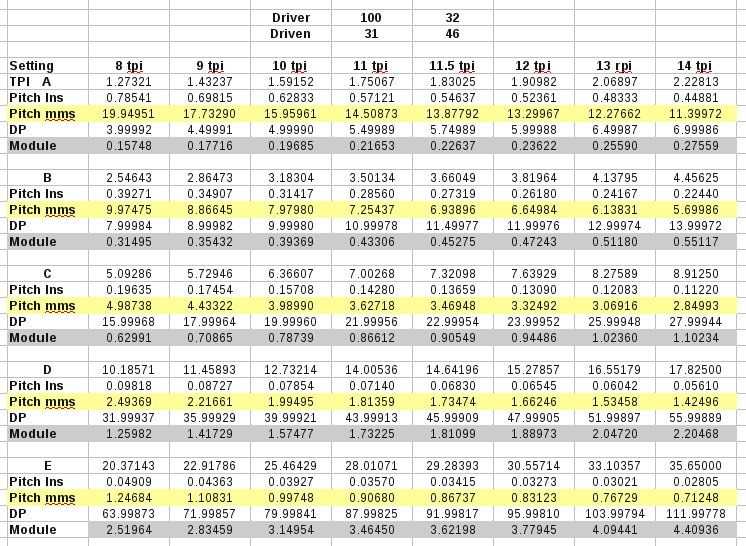

            The earliest reference to the method I have found is a letter to ME Vol 171 iss. 3955, 1993 by the Rev. David Hoskin. There is no great magic in the method (apart from the original, brilliant concept). The new pitch is just the ratio of the replacement gear to the original 24 teeth gear multiplied by the selected pitch on the gearbox. Thus 24/34=0.706. Multiply by 12=8.471 tpi. Divide this into 25.4 gives a metric pitch of 25.4/8.471=2.99mm. Since 34 or, perhaps, 35 is the largest gear that will fit it was not much effort to calculate (with the aid of a spreadsheet) the various combination for gears between 20 and 35 and find the best fit for each metric pitch.
            I must point out that there is a typo in the table above. In the Metric Fine for 12mm the box setting should be 28 not 20 – like all the other 1.25mm pitch threads. Corrected version here:

              Roderick Jenkins:
              Thanks for the helpful explanation and corrected table.
              I have the Hoskin letter and notice that you have derived a better suggestion for 2 BA pitch than his 34T/44TPI; I think the 20T is the smallest standard gear which will fit. At the other end of the scale, I have squeezed a 38T in by extending the slot in the quadrant but I don't remember what pitch this was for.
              As you say, the original idea whoever had it was simply brilliant and you have to wonder what the thinking was at Myfords when they came up with the expensive metric conversion set which I seem to remember does not quite provide an exact conversion to metric.

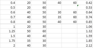

                  Useful info there from John for Boxford about the 44 option. It can also get you 0.7 (M4) using 80 on the gearbox (0.6985mm)
                  The challenge is to get the rest of the common threads by only swapping the mandrel gear as on the Myford table. Best I've managed is 3 more gears, 45,24,26 but mostly people may not need the .75mm (18DP if anyone is thinking of making them).
                  gear, gearbox, thread(mm)
                  45, 46, 1.242
                  45, 38, 1.504
                  24, 38, 0.802
                  26, 44, 0.7504
                  26, 22, 1.501

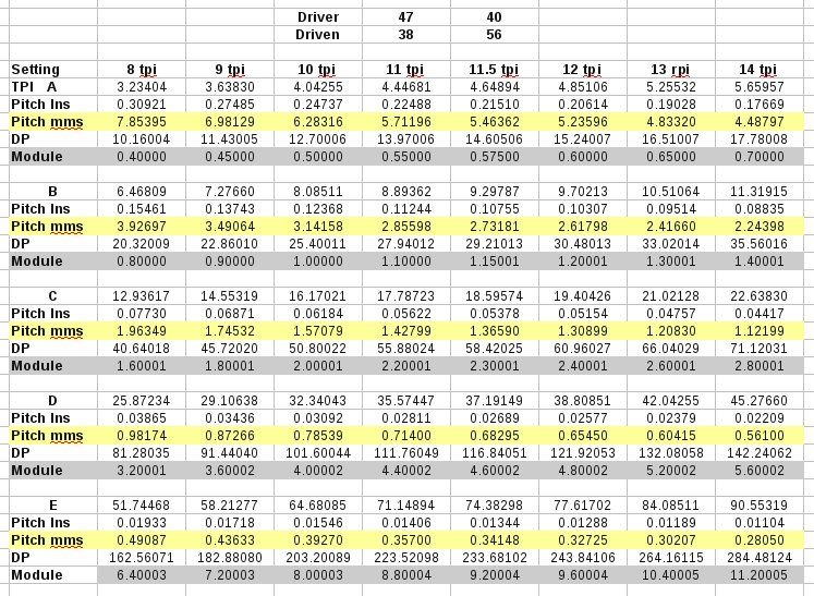

                      It depends how "exact" you want to be. These are the Myford metric threads as cut by their metric conversion set:
                      2 gears are changed, there are 60/63 and 50/45 pairs in between. The penultimate column is the gearbox selector in TPI. There are, of course many more threads here than just those required to make metric coarse and fine fastenings. For most threads you only have to change the tumbler stud gear. Quite convenient but you have lost the ease of changing from thread cutting to fine feed that is there with the imperial set up.

                          Thank you for "doing the math" and for the instructive comparison with the modern mini lathe – no need for four places of decimals there! Myfords clearly came up with a very effective solution to the problem posed by the impracticality of using a 127T gear and I feel it would have paid them to include something like your table in the QC gearbox manual.
