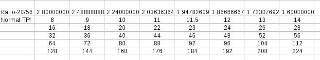

                                      Has anyone come up with some magic gears for a Boxford with gearbox ? I can post as far as I have got if anyone is interested.

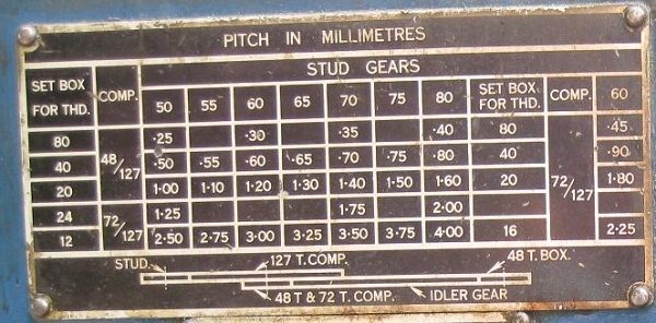

                                              Someone on the forum was working on the Boxford equivalent. Don't want to put him on the spot by naming so give him 24 hours to see the thread.

                                                This is about as far as I have gone, tending to overdrive the gearbox as the fine feed is so low with the normal gearing.
                                                Still some compounds to get rid of and I suspect I am gear short to do that but can hit 0.35mm to 3/4um. I haven't checked if the compounds will mesh. As far as I know all are with standard boxford gears. They came with the lathe when I bought it.
                                                The basic gearbox drive is 20 – 56 and setting as per this
                                                i hadn't thought about using the feed ratio as that uses the rack to move the saddle so wouldn't be so accurate. It works out at about 2.9 : 1 compared with the lead screw feed.
                                                I recently downloaded the find the gears application from lathes co but haven't set it up yet. I did these iteratively on paper Tedious.
                                                Edited By John W1 on 10/10/2015 11:12:56

                                                Bazyle
                                                  @bazyle
                                                  On the CVA I believe it is arranged such that the gear train, including 127 has a 50 and gives 1.00 mm. Then the 50 is changed to give the metric intermediates eg 60 for 1.2mm, 70 for 1.4 etc which is fairly straightforward and uses standard gear numbers, and of course the gearbox can halve or double anything easily.
                                                  Edited By Bazyle on 10/10/2015 11:54:04
