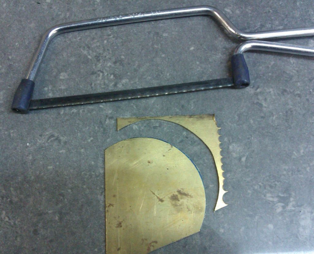

            Brian as I mentioned above a junior hacksaw which I think I have already seen on one of your photos with a new blade will cut curves. This is 1.5" radius OK its 1.2mm brass but same principal will apply to copper, bit wonky part way round as I was trying to video it but can't upload to youtube at teh moment, will try again later.
            So save your money and use what you havesmiley
