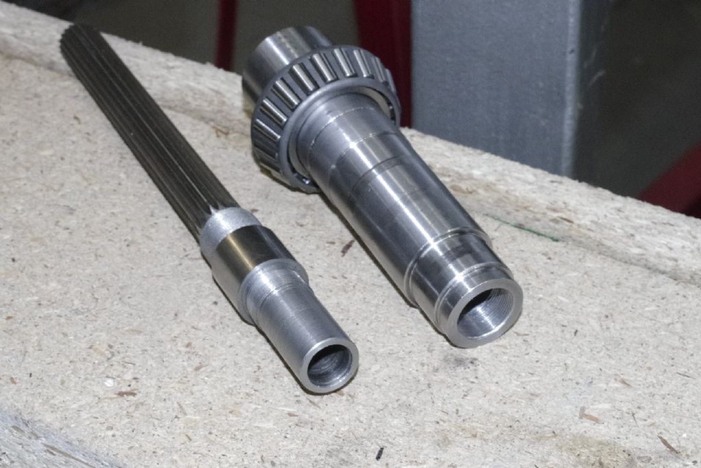

                      You have picked a fortunate size of thread to practice on, at least you can easily see what is going on. If you can produce both male and female threads yourself, they can be whatever you like. When I modified a Tom Senior mill spindle to change it from MT2 to R8, using a bottom half from Arc Eurotrade and the original top half from the mill, I screwed them together with a thread that was no particular size, but the dimensions were worked out from the thread depth according to the pitch selected.

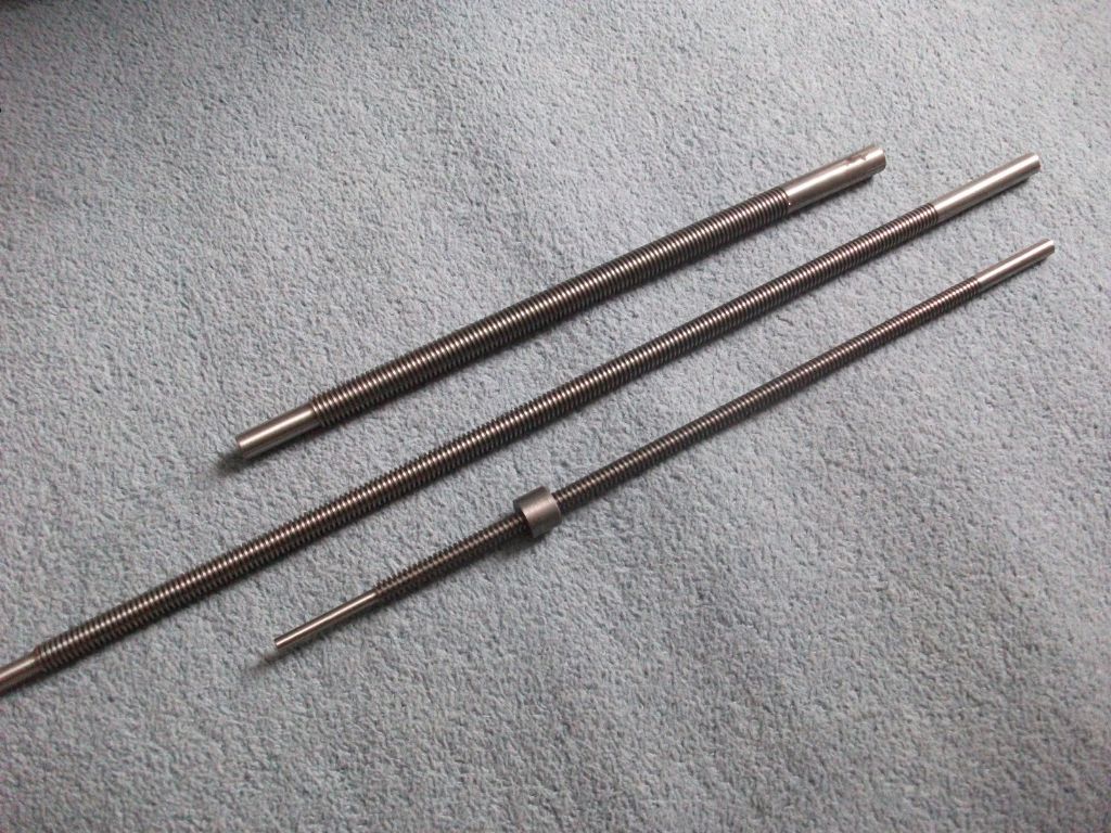

                              To avoid all of this have a look at the articles in MEW 241 to 243 Milling lead screws.
                              Cut to full depth in a single pass, left or right hand makes no difference,
                              3 off lead screws here all 10 tpi longest is 20 inches of thread 1/2" dia in EN 8.
