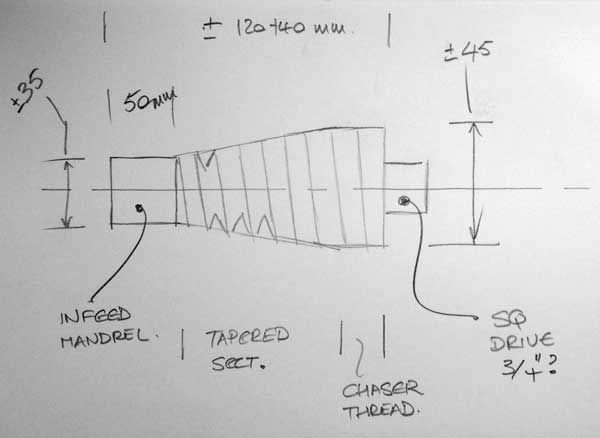

      I need to find someone who can make a big custom thread tap for me. I have an ML7 but it's beyond that I think. It's approx 45mm major dia, and around 4 – 5 tpi. It's for cutting wood threads for some vices I make, the reason for flexibility in diameter and pitch is that from a new tap I then make a thread box to match (basically the die part) so I'd need a matching female thread into ali stock to make the outfeed for the die / thread box.
      If anyone with a bigger lathe and v coarse pitch gearing will consider this I will pay of course – exact drawings etc will depend on pitch and then I need to check available Forstner bits to get minor and major diameters right – but I would provide a working drawing. Any help appreciated.

                                Thanks Martin C – I can sketch this and take a pic, but how do I upload a pic? (do I need some min no of posts?). I have to start with 2 diameters (min and major) as I must buy Forstner bits in std sizes. According to what I have at the moment and some rough sums, I think a 35mm minor diameter and 45mm major may do it. So tap hole is 35mm, die blank (turned hardwood dowel) is 45mm.
                                I took a 4.6TPI as a guess of what would be good, my current is 4TPI but I think a tads finer would be good – in a vice obviously speed and clamping force are traded. So if 4.6tpi, then my reckoning is 9.77mm diameter difference at 60 degree vee form. I can get 35mm and 45mm, and grind a 45 down to about 44.7 so that would be easy.
                                I could sketch and put it on facebook pge if that helps??

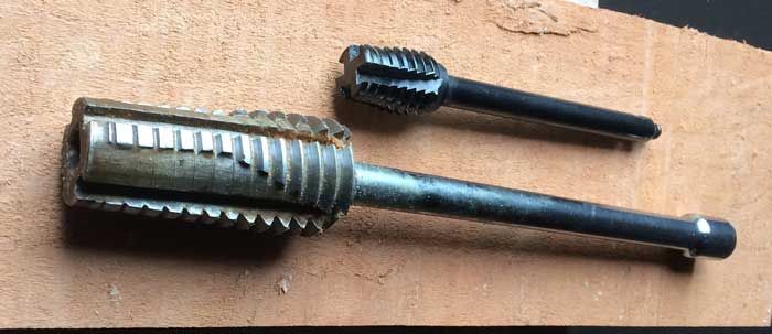

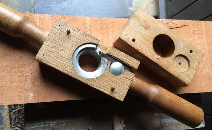

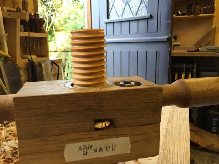

                                            Thanks Hopper – let's try this… resized small in P'shop. Top pic is my custom tap 42mm 4tpi, second tap is a commercial 1" 6tpi that works very well, next pic is the shop-made thread box with ali outfeed and O1 vee cutter. Last pic is box at work into oiled beech. I'm working out the drawing but realised it isn't so simple, if I want small flats (or rads) at the apexes the geometry becomes a bit more complex – to me anyway… drawing soon
                                            #237143
                                            douglas coates
                                              @douglascoates40572
                                              here's a rough sketch minus the calcs for precise diameters and pitch

                                                  Are those taps relieved at all, so that the leading cutting edge is contacting the cut thread but the body of the tooth behind it has some clearance, as is done with taps used for tapping metal?
                                                  Rads on the threadform for the tap should not be a problem. On a large threadform like that you can easily grind it on freehand on the threadcutting tool used to turn the thread on the tap. Rad on the tops of the threads on the tap can be put on with a file after the thread has been cut. Flats of course are easier and more commonly done for practical purposes. Just grind flat on the nose of the screwcutting tool to get the flat in the "valleys" and simply make the OD of the tap undersize to get the flats on the peaks.
                                                  It looks from your sample taps that they are made in the conventional manner as far as the thread itself it a standard parallel thread and the taper is simply applied to the OD. Looks like a bit of fancy milling on the big one to provide chip clearance with the short teeth at the lead-in end.

                                                    Douglas, 4.6TPI is very close to 5.5mm pitch. If you did 5,5mm pitch x 42mm diameter in a metric 60° thread form the difference between outside diameter and bore would be 5.5mm. This would give a bore of 36.5mm for your initial hole. I know there will be a slight difference due to the flats you require but it seems a lot different from your calculations of 30 April. To get close to the 10mm difference you have from Ø35mm to Ø45mm you would need a pitch close to 10mm or 2.5 TPI.
                                                    I printed off the picture of the thread in your post of 02 May and scaled the dimensions from the 44mm stated on the label. This gives a bore of 37.3mm diameter and a pitch of 6.4mm (approximate of course). This is close to what you would get from a metric thread with Ø44 and pitch of 6.5mm (37.5 bore). This is a little under 4TPI.
                                                    Based on these figures I think you should keep the TPI value at 4 or lower.

                                                      The threads on the wooden screw done in the thread-box look to be greater than 60 degrees, they could even be 90 degrees which would be the same as the threads on a tap for tapping wood I made some months ago.
                                                      If they are 90 deg that would explain the TPI errors found.
