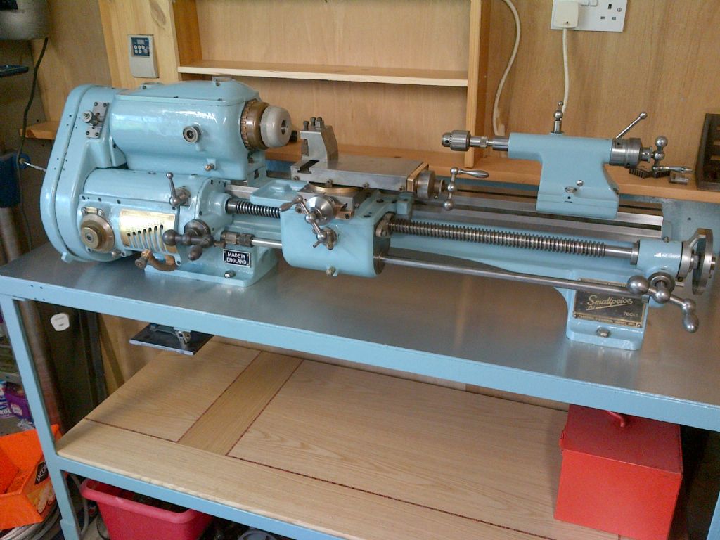

                                        Hi all,
                                        Chris Mills asked me in an earlier mail how my rebuild was progressing. After quite some time, effort and money, the S800 is usable again, probably for the first time in years! I bought the lathe as a project, and to use as a spare and to give me a chance to recondition my Smart and Brown Sabel.
                                        I stripped the S800 completely to check for wear and to enable a better paint job. What immediately strikes you is the attention to detail on this lathe, from the headstock arrangement to the tumbler reverse gears in their gunmetal oil bath! The gearbox runs in its own oil bath as do all the gears in the saddle. I had to make a metal bench for it, and a 3 phase motor is underslung and driven using a VFD running from a single phase supply.
                                        I have some pics I can post, can someone let me know how to do this, there's no obvious 'paper clip' attachment to include them in this post – or is there?
                                        Thanks for your interest.
                                        Paul

                                          Hi again, pics figured out – I think. This is my S800.
                                          regards
                                          Paul
                                          img-20150605-00152.jpgHi again, I think I figured out the pics, so attach a couple now.
                                          Regards

                                          CHRISTOPHER MILLS 1
                                            @christophermills1
                                            Westbury,
                                            When you go to post a reply, click on the camera image in the posting window, top bar second from right, and then I think you choose your image from your album and click 'upload' or similar – then click in the posting window
                                            It is easy, once you accidentally choose the right method, honest!
                                            I can see an image of your S800 in your album, blue, and a lovely job you appear to have made of it
