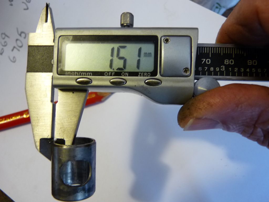

      Does anyone know if Crompton Parkinson white-metal motor bearings were line-bored on assembly? The reason for the question, the front bearing on the (new to me) Super 7 motor is a bit worn in the direction of the belt tension, and therefore a bit noisy. The bearings appear to be unobtainable, at reasonable cost, as advised by Brook.
      I've extracted a rear bearing ( Vanwall Products – in good condition being still a close fit on the shaft) from a spare motor. I made an oilite bearing as a replacement as an experiment to test longevity. The oilite bearing was first bored and then the outside turned on a mandril for accuracy, but the motor locked up until I resorted to some 'fitting' to ease the new rear bearing.
      I now have a spare bearing to hand and the fact that the shaft in the Super 7 motor is not worn, replacing the bearing might do the trick, however, I don't want to knock-out the worn bearing before being sure that the work stands half a chance of succeeding. I can't just swap the front covers because the front bearing in the spare motor is worn in a similar way.

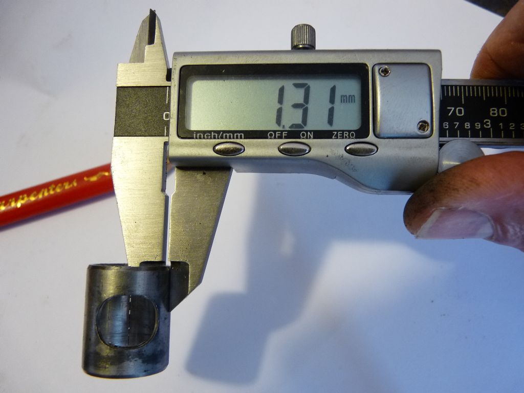

                  Hi Neil, no they are split mild steel backed about 1.5mm wall and pushed out very easily, but the white metal internal diameter is not concentric with the outer by about 0.3mm 0.012 in old money, making me think that they were sized in situ. by some method.
                  Hi Swarf,Mostly! The originals are white metal (VP Products) – I made an oilite bush as an experiment using very sharp tools to prevent rubbing, it was also soaked in oil overnight. The bush has been installed in the spare motor and so far I have not seen any bronze slush near the bearing, but time will tell. I'm not sure about the compatibility of a non hardened shaft running in an oilite bush albeit at the rear of the motor with no side load from a belt. Fortunately there is an oil passage directly to the shaft via a hole in the bearing.
                  The idea was to use an unworn rear bearing from a spare (not so good) motor to replace the worn front load bearing end of the lathe motor.

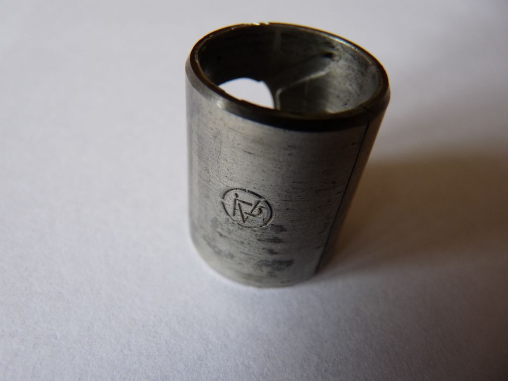

                    The bearings are Vandervell, not Vanwall, and they are still in business. although I am sure it is a long time since they made that type of bearing, you could ask them. Have you tried the new bearing in position and then rotated the motor end cap to see if the rotor frees off. Are the end caps pressed metal or cast, and what type of flange is there where the end cap meets the stator housing?They should align without any reaming, but it is possible that the end cap is distorted or the flange is damaged. I can remember that we used to bump the end caps with a rubber mallet whilst the through bolts were loose to line everything up. Is the binding in the bearing, or is it the squirrel cage touching the stator? I uset to service a lot of this type of Crompac motor which was fitted to all sorts of small industrial machinery. can you post some pics?

                        Vandervell steel backed white metal bearings are ready to fit in automotive applications, the instructions warn against scraping. I would have thought that if they can make shells that accurately, a split bush for a motor would need no further work after installing. The only precision tasks required would be the hole size and concentricity with the register. My vote goes for them being presized to give the correct clearance after fitting in a correctly toleranced hole. Your new bush may have closed up on being pressed in. Many bearings rely on the fit in the housing to bring them to their designed fit, even ball races can be ruined by too small a housing or too tight on shaft, Torrington needle rollers certainly need a tightly toleranced hole and shaft to achieve the correct running fit.

                                      The bearing as removed from the rear of the spare motor.
                                      I've taken a load of photos (they are in an album) to illustrate the problem – do have a look, it tells the whole story, no point in repeating them here, but I will include the most telling pictures here. The bearing does not appear to be worn.
                                      The other end is similar.
                                      So, I think I might have stumbled across a reworked motor which has a distorted rear cover, I remember it having a slight wobble, but no obvious play, which is why I removed the bearing in the first place. Just my luck. However, the front cover off the spare motor might do the trick, it appears to have a bit of bell-mouth wear but much less that the S7 motor which is visible when the belt is tweaked. I will try the front cover swaps tomorrow and give up on the spare bearing idea – well, I might as well put it back in the spare motor where I got it from, removing the experimental oilite I made.

                                        White metal bearings are made by passing a broach through them, possibly gang broached in one go. I think the broach was not drawn back through the bearings. Split bearing were placed in a housing which matched the finished size before broaching. Some of them were heavily copper plated before the white metal lay. This may explain why the hole is off center. I very much doubt it was done in the motor with both ends attached as that is too much work. I have always admired the excellent surface finish on white metal bearings.
                                        Clive

                                          Thanks for the sizing information, that could help explain the unworn off-centre hole in the bearing I have to hand. Could it be that the split bearings, pre-formed with oil passages, were first pressed into the end-caps and then broached with the end cap+bearing in a jig, registered on the machined rim which locates with the stator? This would correct any potential inaccuracy in the end cap die-casting. This bearing, even after 50 years, is still a nice slip fit on the motor shaft.
                                          Regards
                                          Phil H
