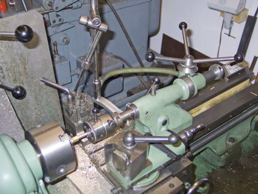

              workshop 018 24 dec.jpgJust in case anyone is wondering what we are talking about, here is mine in action with a Coventry die head.
              Phil

                Hi Phil P
                Thanks for your photo and explanation I should have included a photo with my first post – I'm new to posting on forums so am learning all the time.
                I see you have a stop collar on the end – excellent idea to stop running out of rack.
                Regards
                Phil H

                    The stop collar is there so I can set the length of thread for the die head to trip open at, without moving the tailstock on the bed.

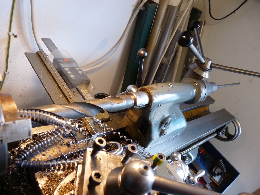

                        Hi again,
                        I had to make a collar to facilitate reassembling what had been a jammed Jacobs 1/2" Drill chuck.
                        Here is a 1" drill bit being used in the Cowell sensitive drilling attachment showing it capability.
