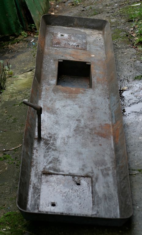

The above shot of CovMac's drip tray shows extent of this lathe – the tray is about eight feet long, and made of mild sheet steel. You can see the remains of a pumped coolant system, a collecting tank at the far end, and rising pipe in the left foreground, but those are the only signs left of it. We will likely never know its nature.
Phil – Are there any signs of a pumped coolant system on yours? I know it has the tank.
