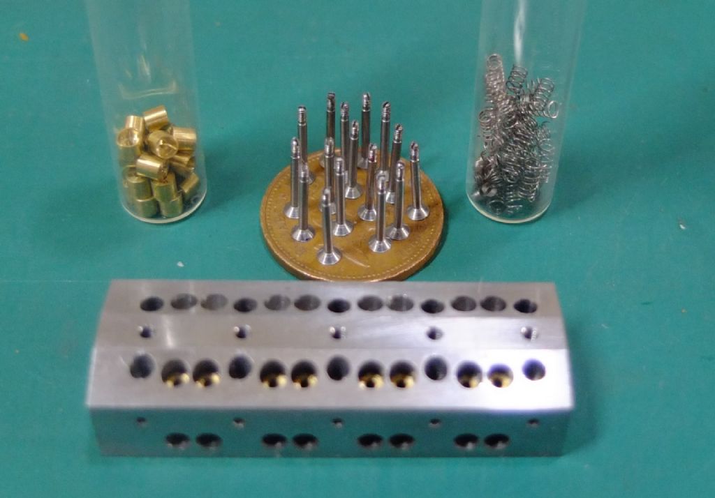

        It's time I resurrected this thread. I've had a couple of months off metalwork but I'm back into it now.
        Yesterday, two years to the day from the first idea and drawing, I finally finished making all the major components.

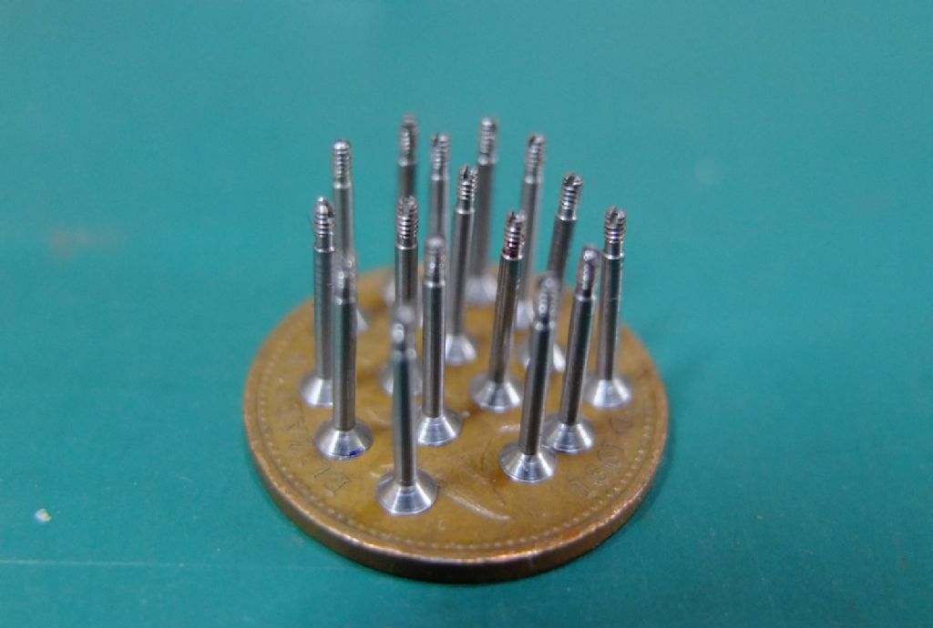

        I've completed the task I dreaded most. The valves, guides, tappets and springs – 32 of each.
        The valves took the most time as they are rather small with quite tight tolerances. Each one needs 8 machining processes.
        Here's 16 of them on a penny.

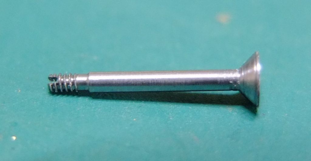

        And a close up of one so you can see the slot.
        At this magnification, you can see bits of paste from when I ground them into their seats.

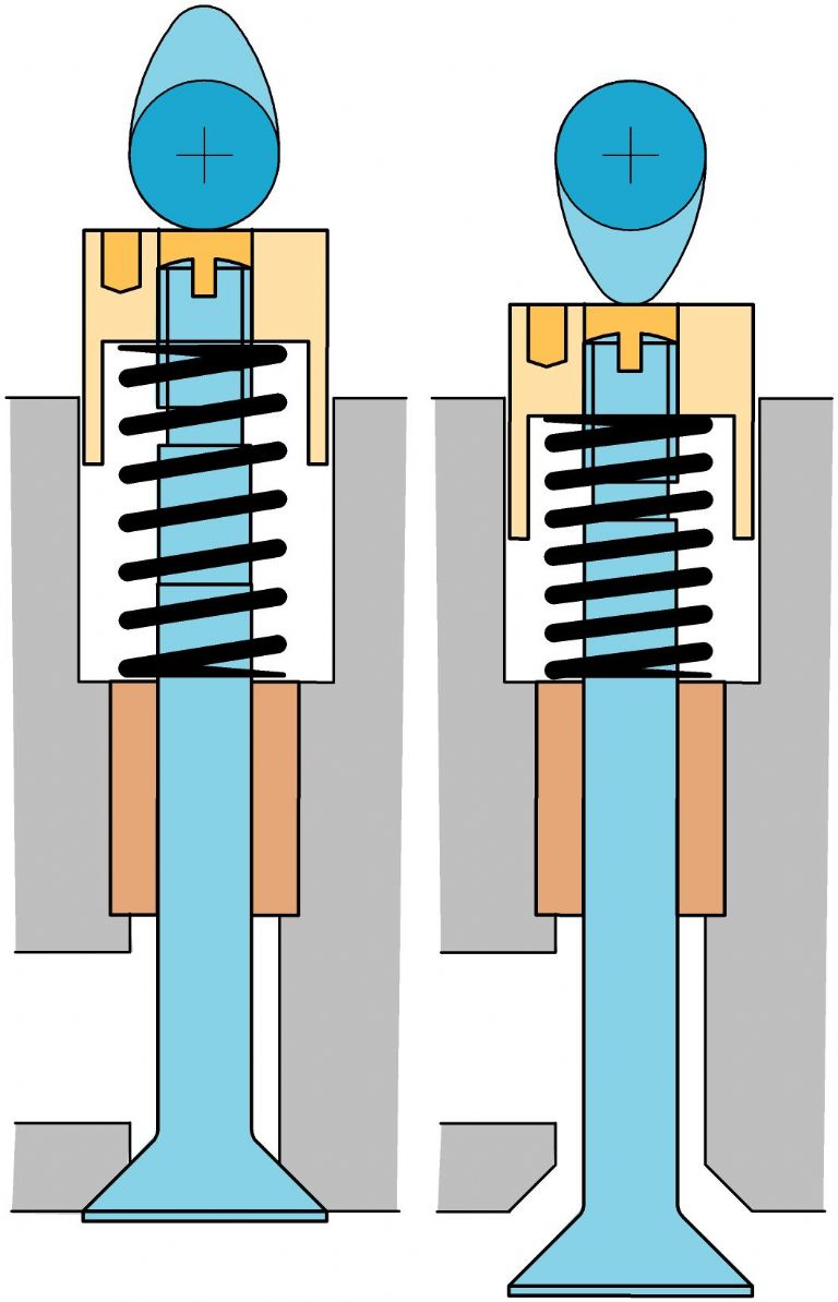

          Here's how the valve parts fit together, open and closed.

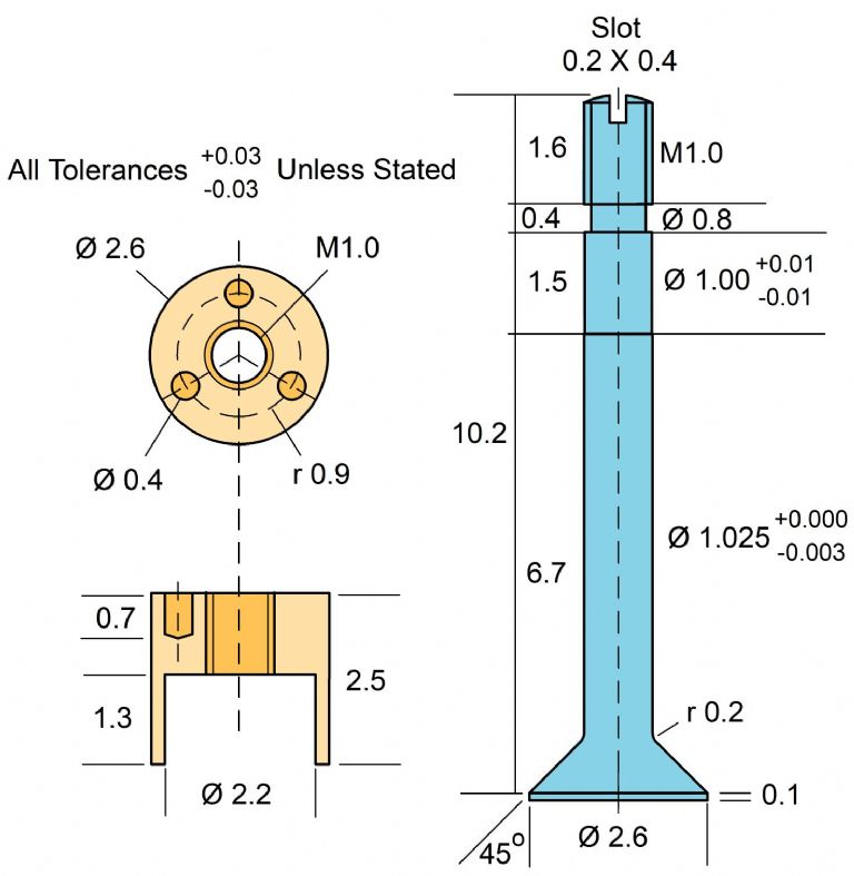

          The valve guides are brass and reamed with a 1.026mm carbide reamer (Jurassic Tools – great price). They are a friction fit in the cylinder head and the springs keep them seated.
          The tappets are adjustable using the 3 holes and the slot in the valve using a tool that I have not finished yet.

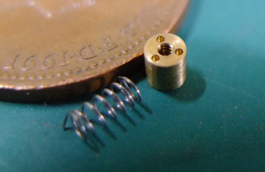

          Here is a tappet and an untrimmed spring. And a penny.
          Steve

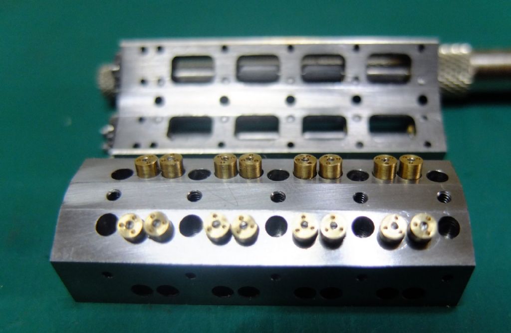

                Here is one cylinder head with valve gear installed and a cam carrier behind it.
                Valves, tappets and springs (and spares) for the other head.
