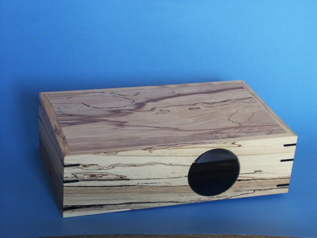

                                          A lot of the strength will depend on the quality of the ply wood you are using, cheap DIY softwood cored ply will not make up into as strong a box as one made from decent quility birch throughout ply.
                                          Finger/box/comb joint call it what you will is liekly to be the strongest, dovetails would have more strength in one direction but equal in teh other and as you say hardet to cut. Titebond II alphatic resin glue or what the yanks call yellow glue would be my choice unless its going outside.
                                          What length are the sides of the box? if you can stand them end on under your mill that makes a very effecting and easy to use comb joint cutter, this little one was done that way.
                                          If you were able to cut decent mitre joints then a splined mitre joint would be another option but would want quite a few splines to give the same strength as the comb joint
                                          J
                                          PS if you are worried that your efforts at cutting dovetail joints may not look good to the eye you could always do a mitred dovetail which will hide themsmile p
