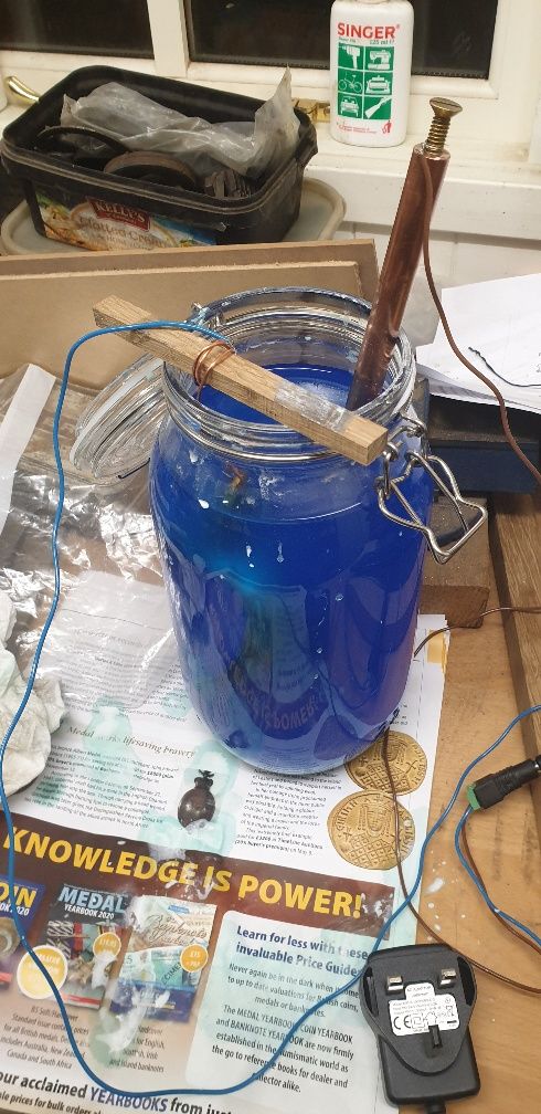

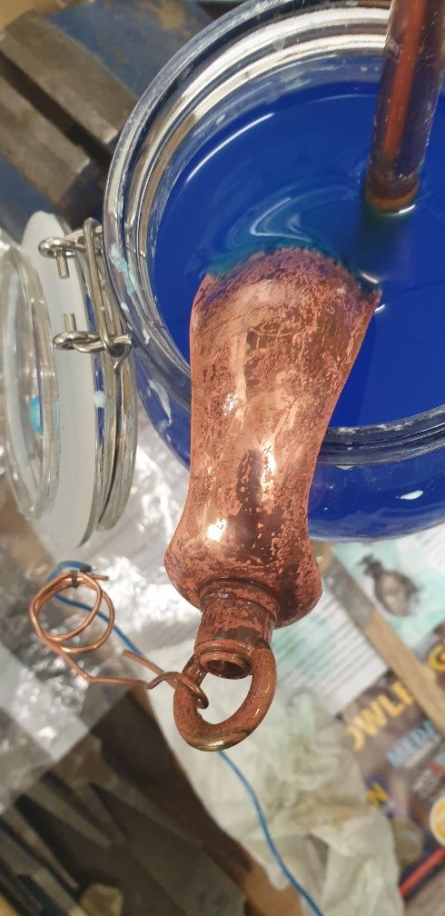

              Ok I'm getting nowhere fast with the copper plating. I have a 2lt water filled pasta jar with 12oz of crystals dissolved and a 2 amp power source. The electrode is 12" long, thick wall copper tube, 1/2" dia with 3/16" centre hole.
              + connected onto the electrode, – onto the part to be plated.
              Part is suspended in the solution via copper wire and not touching electrode. There is tiny progress in that the copper part I'm trying to overplate (to cover a soldered repair) has areas covered in what looks like copper filings but from the clips Ive seen on the web it should be plated by now? Its been in about 5 hours today, after an attempt yesterday with a weaker solution.
              Any suggestions please?

                I wonder if the current is too high or the concentration is. If you have what looks like crystals, then that is what I would suspect. Simply leaving the work in the solution without any electricity should cause the copper to plate out.
                Have you any method for measuring the current ? Or any means of adjusting it !

                    At the worse you will only have to clean it and start plating again. The crystals should just rub off and can be re-dissolved.
                    Re-reading your post, I assume that you had thoroughly cleaned the work before you started plating ! Finger prints or any oil or grease will cause the plating to be patchy.
                    One other thing that you could try is a single battery, which would be 1.5 volts and would have a very limited current available.

                      Previously I had fumed (with ammonia) the copper I'm trying to plate to age it (they are parts for an antique light). Thinking this might hinder the plating process I stripped the fumed surface by submerging in clock cleaner,
                      a kind of diluted ammonia. After that I didn't touch with bare hands only with rubber gloves.
                      Do you think that might be the issue?
                      Last night I tried removing the crystals from one part finding it was relatively tough going, having to resort to Autosol.
                      Ive turned the power off now but left one submerged for overnight success (-;

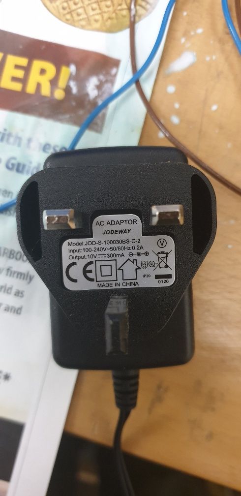

                                Yes I can confirm 240 volts hurts as i found out a couple of weeks ago. Hence my nervousness and asking the question! I will be happier and no doubt safer if I can get away with domestic batteries.
                                Cheers
                                Chris.

                                    That looks like a switch mode power supply, and it's only rated at 300 mA. If you don't have enough resistance in the circuit it might either switch off, or expire. I don't suppose you've got an ammeter?
                                    #454331
                                    Chris V
                                      @chrisv
                                      Hi Duncan, no I don't have one of those.
                                      Turning in for tonight now
                                      Cheers
                                      Chris.

                                        You need greater distance between electrode and work, the solution looks very strong, make sure the object to be plated is negative.
                                        I would degrease then pickle in vinegar or any weak acid until pink, then rinse well in clean water before plating.

                                                Posted by V8Eng on 26/02/2020 14:51:08:
                                                Gateros Plating have a good problem help and tips page here:-
                                                Gateros
                                                +1 to the Gateros advice. As Chris has discovered electo-plating isn't quite as easy as it seems.
                                                To answer Chris's questions:
                                                1. Household Ammonia is an excellent degreaser, but it risks reacting undesirably with the Copper. It might leave a chemical layer capable of spoiling the plating. Instead, I'd try cleaning with very hot water with a dash of washing up liquid in it. Go over it first with a new stiff toothbrush and then rub well with a new Washup (sponge thingy with plastic scouring back) in a clean bowl. The water should be as hot as you can comfortably cope with whilst wearing thick washing up gloves – Marigold's. Then rinse with Methylated Spirits. Don't use turpentine, it's oily. Getting the metal thoroughly clean is really important, any suspicion repeat. I suppose being metal it could be boiled for half an hour!
                                                2. A plastic container is OK unless it gets hot.
                                                3. Sheet copper is an alternative, but Copper Pipe is easier to source. I'd use pipe.
                                                4. Don't buy Distilled Water – it's expensive. Instead buy De-ionized Water for topping up Car Batteries from Halfords or similar. Also sold somewhat more expensively by most super-markets for steam-irons, but don't buy the perfumed variety beloved by ladies. Plain water only. Rainwater is often recommended as pure, but beware! How was it collected? If off a roof, then don't use it. Water from a dehumidifier is good but only if the dehumidifier is clean.
                                                Comments.
                                                • Don't bin the Copper Sulphate solution, if you want to dilute it just add water. No reason why it shouldn't be used good and strong though.
                                                • The solution should be slightly acid, Copper Sulphate needing Sulphuric Acid. Sulphuric Acid is controlled because it's an Explosives Precursor and is used in Acid Attacks, but I see it's sold as part of the Gateros Kit Copper Plating Kit. You might try Sodium BiSulphate instead. Lack of acid may be why you've not had good results so far.
                                                • The power supply may need attention:
                                                  • Plating is an electrochemical process needing just enough volts (about 2v) to get the amps flowing. If too many volts are applied, the excess will produce Hydrogen and Oxygen as a by-product. The bubbles are unwanted – they cause intermittent plating as they form, leaving a spongy copper deposit that falls off.
                                                  • Too few amps means the process will take a long time – be patient.
                                                  • Too many amps may damage the copper deposit due to heating, causing bits to fall off.
                                                  • Duncan's warning about Switch-mode supplies is important. Being intelligent devices they're likely to shutdown or reduce output if they detect an abnormal load – like a jar fill of Copper Sulphate Solution! Older wall-warts contain a transformer and are much less fussy. Transformer wall-warts are distinctly heavy so look for one of them.
                                                  • One way of losing excess volts if needed is to pass the current through a second jar of Copper Sulphate solution with two copper electrode. The current can also be controlled by altering how deep one of the electrodes is in this jar (to reduce bubbles).
                                                • Other factor is the need to agitate the object being plated to remove bubbles and keep the electrolyte near the object fresh by stirring it.
                                                • Sorry to rain on the parade, but the idea may not work. Plating depends in part on the metal being plated, in this case a mix of copper and a soldered joint. I don't know how well, or not, Copper will stick to solder. It's worth a try though!
                                                Don't give up.
