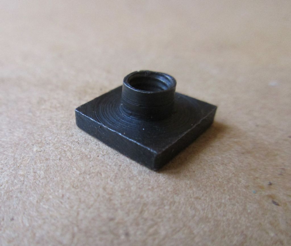

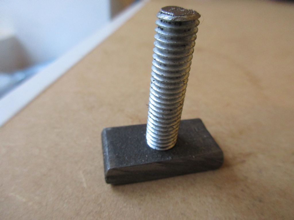

                          Hi Kevin, you can knock off about 1mm of your t1 measurements and about 3mm off the height at the bottom of your h1 measurements, these need to be a good clearance and your s1 measurements will need a easy fit, so you could knock off 0.2mm of these measurements. You can make T nuts on your lathe like the one below from a piece of square or rectangular bar or even a larger piece of round bar and then cut two flats on the bottom to suite your slots. It is also a good idea to make your a1 measurement a little less, say about 0.3mm, so that they are below the surface of your table.
                          You could also use a suitable piece of flat bar and drill and tap a hole for a piece of threaded rod.
                          A few of these will get you going to be able to hold things, to make the more conventional T nuts to suite your purposes.

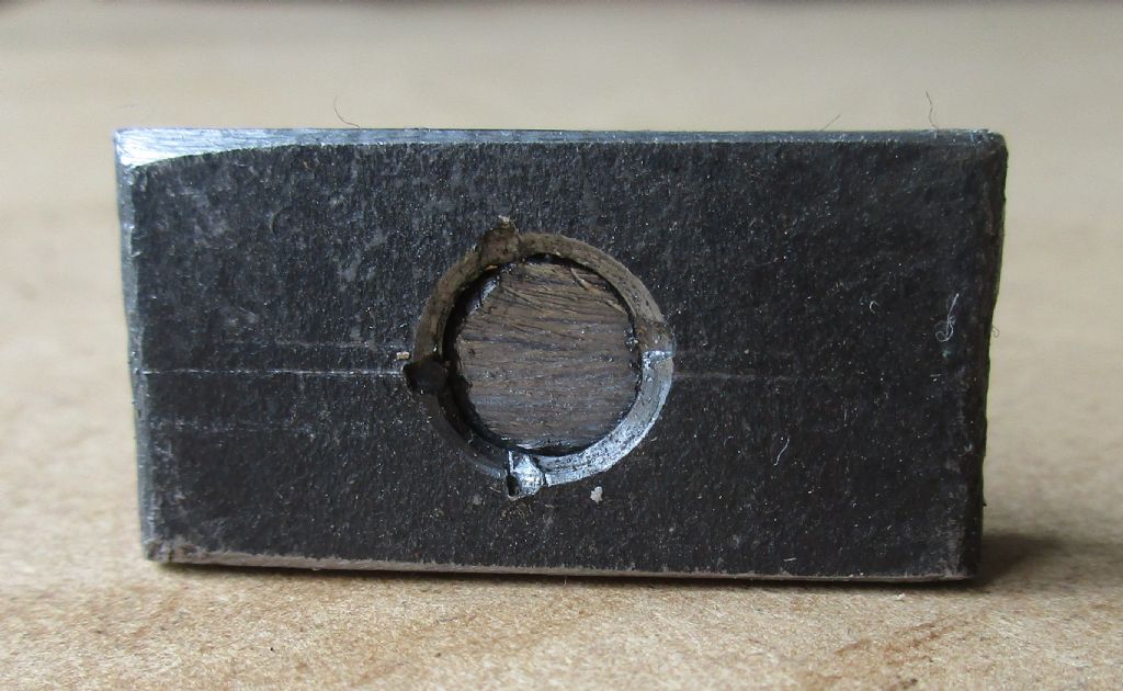

                                    Hi Kevin, don't go overboard with the length of any T nuts, the threaded flat bar ratio of the length / diameter of the threaded rod is about right, but you must get the hole drilled and tapped as square to the top of the bar as reasonable as possible. I should have said that the thickness of the flat bar one is only about 0.5mm shallower than the slot, in order to get the maximum amount of threads tapped into it and I also staked the bottom of the threads with a dot punch, to stop the threaded rod screwing through and acting like a jack on the bottom of the slot, as it is something you really don't want to happen. Most commercially made T nuts are either staked in a similar fashion or the threads a left a little tapered in the bottom of the hole, or even not tapped completely through.

                                      … I also staked the bottom of the threads with a dot punch, to stop the threaded rod screwing through and acting like a jack on the bottom of the slot, as it is something you really don't want to happen…
                                      Absolutely! A previous owner has done this to the cross-slide on my ML7, and the edges of the T-slot are broken out.

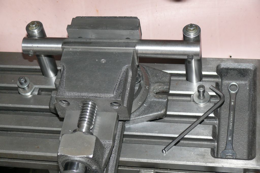

                                          Make two Tee nuts, with as little effort as possible, to secure the vice to the table of one machine. Then first job is to make two "proper" nuts for thet machine, and fit them.
                                          After than you can produce Tee nuts for any other machine, as and when the need arises.
                                          To make aligning the vice(s ) as easy as possible, my suggestion would be to make a "goalpost" fixture for each machine and vice. The only precision bit is to turn the "dowel" at the bottom end of each post.
                                          There may be a picture in my album. But If I go to check, I shall lose this. Hopefully the Forum upgrade will remove that danger.

                                            Second Image All we need to do is to enlarge it! All that I seem to do is to call up the image and a whole load of Latin!
                                            881331.jpg HTH

                                                      One thing to add for anyone going to make one.
                                                      Having made up the goalpost and clamped it in place on the T slot, take a skim along each side.
                                                      In that way, the surface to which the vice clamps before being bolted to the table will be in the plane in which the cutter moves.
                                                      Based on the occasional check, it will align the vice to about 0.001" (0.254 mm )
                                                      I even made one for my 3 way tilting vice!
