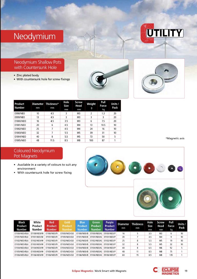

              Well, they are described as a "Shallow Pot" (with countersunk hole) on P 19 of the Eclipse catalogue, so I hope that's what you receive.
              P17 lists plain "Neodymium Rings" (with a countersunk hole), which I assume to be the plain unpotted ones.I have some of the latter from a different source, but have found the holes to be a bit too shallow for most countersunk screws.
              It looks to me as though the coloured pots at the foot of P19 are just as described; i.e. coloured pots containing a zinc plated countersunk button magnet.

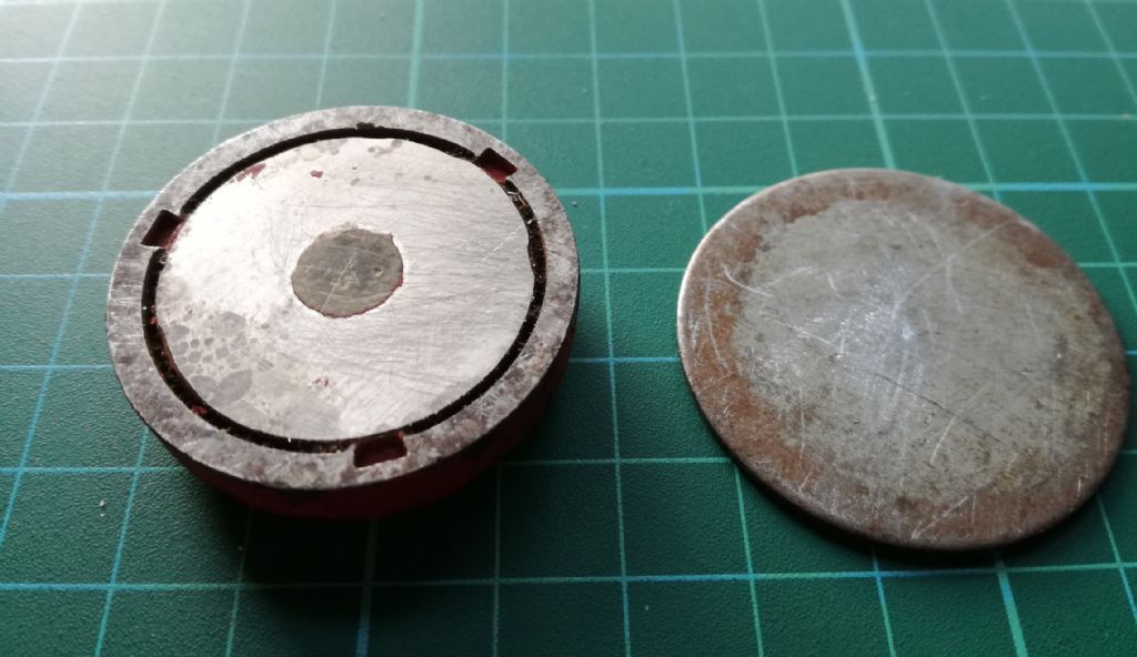

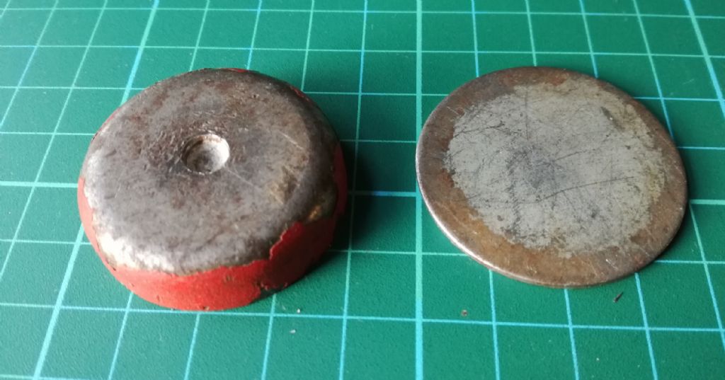

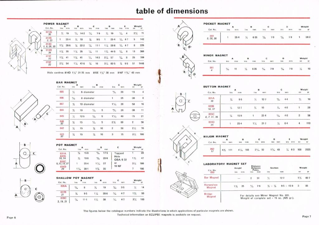

                Hi, although mine is an earlier version of an Eclipse shallow pot magnet, which is a 828C in the Table of Dimensions below, it is of much the same design and has a keeper disc for when it isn't in use, and there is a photo, No.19, of one attached to a glove and some in photo 21, attached to the underside of a shelf for holding cooking pot lids, also below. The magnet is only slightly below the pot by a few thou, maybe about five at the most.
                Regards Nick.

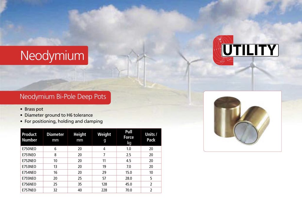

                    Indeed, Martin … and I would take the distinction a little further; in that this [on p25] is what I would consider ‘potted’ in the sense of being embedded in resin:
                    The problem I have with Eclipse is that they don’t appear to explicitly tell us what they mean.
                    [ memories of Humpty Dumpty ]

                      As I read this, the difference is that this type above is described as BiPole pot; note that it is a brass case which won't form part of the magnetic circuit.; it's a button magnet in a brass pot, rather than a disc magnet in a steel/iron pot.
                      Half of the front face will be North, with the other half South poles, just like a button or horseshoe magnet.
                      This means that in one position, two magnets will be strongly attracted to each other, whereas if you twist one by 180° along the axis, they will repel each other. You could maybe use them for holding a door closed, but force it open when the handle is rotated 180°, (as well as its conventional use against a steel plate etc.)
                      I suspect potted magnets with an iron/steel pot have south in the centre, with north concentrically in the outer of the pot.
                      i.e. they are conventional disk magnets with the pot to complete the circuit and bring both poles to the front, but concentrically.
                      It could of course be the opposite polarity, depending on the maker/purpose.
                      I've just been out for a quick play in the workshop.
                      My countersunk, non-potted magnets have the south pole on the countersunk side, as evidenced by deflection of a conventional magnetic compass; this is just like a disc magnet
                      A magnetic car aerial base is effectively a larger potted magnet, with an air rather than resin/brass gap, which in the case of the two I tried had South in the middle, and North concentrically around the outside in the steel casing.
                      It's not helped that many sellers on eBay etc describe their disc/flat magnets, featuring one pole each side/end, as "Button" magnets, which should really present both poles on one face. (as per Page 11)

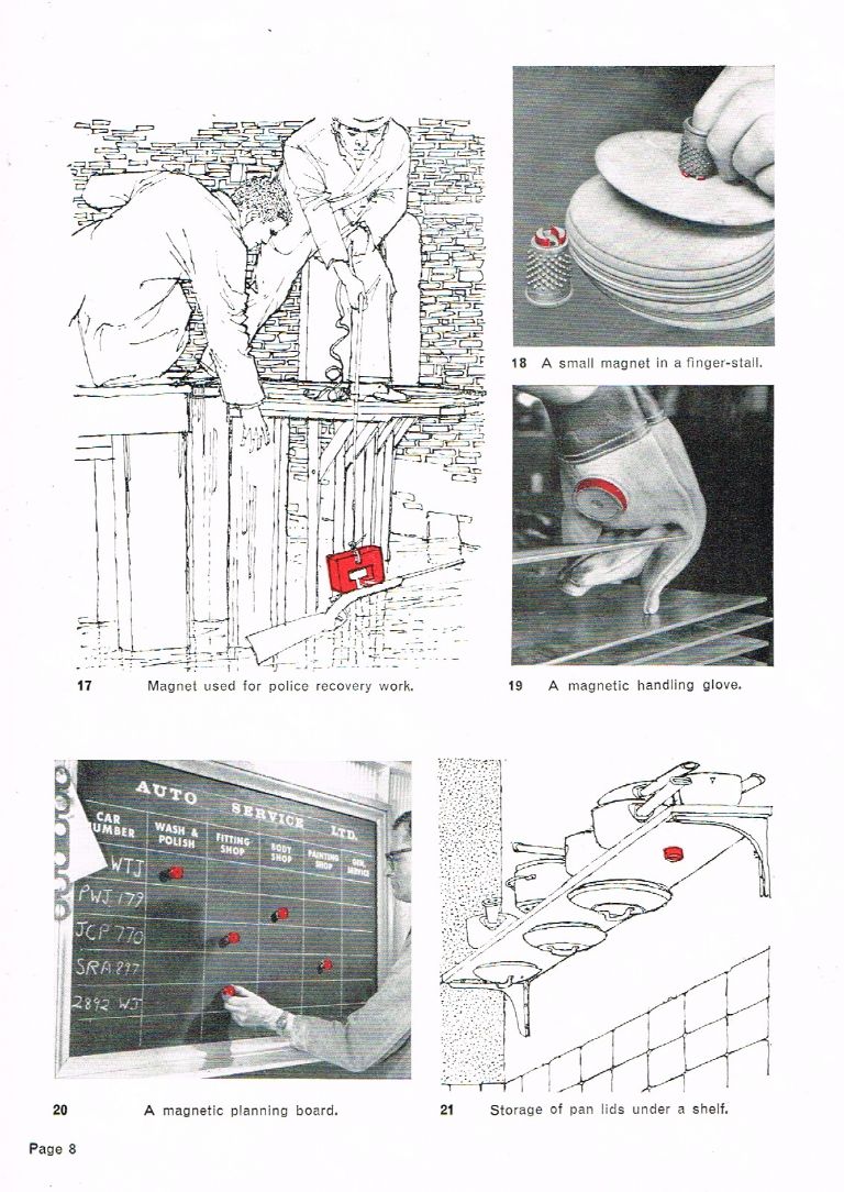

                                    No… pot magnets are the ones used for storing saucepans…

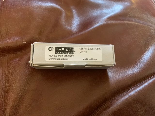

                                        Ian Parkin
                                          @ianparkin39383
                                          Michael
                                          i ordered some from zoro and had the email this morning saying its being posted and surprise Parcelforce has just turned up with the magnets

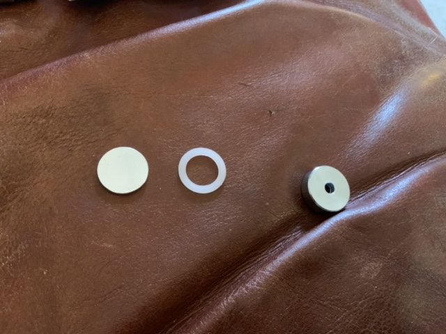

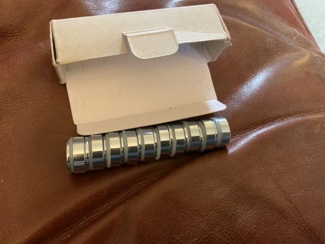

                                            Ian Parkin
                                              @ianparkin39383
                                              3 boxes of 10 arrived in a much oversized plastic bag
                                              each magnet has a nylon washer between it and the keeper
                                              #625775
                                                Thanks for the info, Ian
                                                … looks promising.
