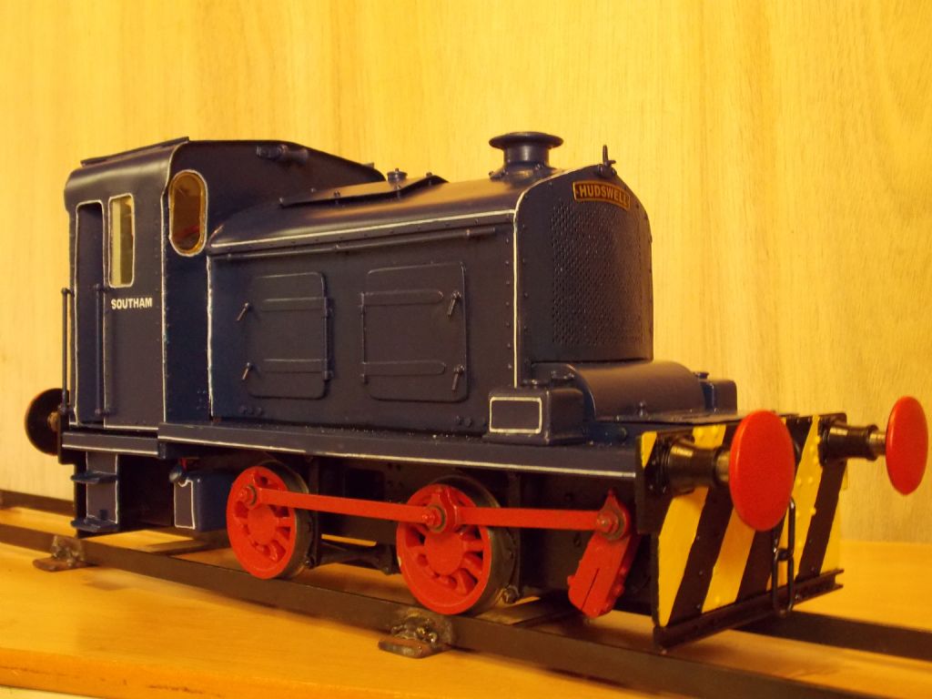

        Following adding windows, doors and lining out, the shunter still looked toy-like.
        After seeing Ray MacMahon's Harlandic I refinished it all over with matt varnish and it looks much better. Desite the wierd lighting effects the finish is much the colour in the photos.
        I now have an 0-6-0 in 7 1/4" in mind…
        Finished!
        Still Finished

        Jeff Dayman
          @jeffdayman43397
          Looks great Neil, well done!
          JD

          Bazyle
            @bazyle
            I like the detailed photos in your album. Takes one right through the build.

              Sub Mandrel
                @submandrel
                Thanks Guys,
                If anyone is interested in having a go, I have part-finished drawings and instructions – enough for someone determined to make their own, and I would greatly value comments and feedback. Let me know if you are interested.
                There are several variants it could be made as Google for 'hudswell clarke" and add one of "Mary", "Carroll" or "Mighty Atom", "Southam" or "Southam 2".
                For the record it weighs 23lbs, about 16" long is powered by a shower motor with a stall current of 7A and is powered by a 7Ah lead acid battery from a fire alarm. It pulled an 18 stone chap on a big driving trolley happily and after much slipping pulled me and another chap on the same trolley (just).
                In terms of size , weight and performance it is about the equivalent of Tich.

                                The only bought in parts were four Tich horrnblocks and some heavy duty 6mm x1" springs from Reeves. I also used a bevel wheel pair from a bust angle grinder (cheap from ebay), as 12V burglar alarm battery and the 12V motor from a Shurflo shower pump.
                                If you don't want to cut your own gears you will need an assortment of medium size ones, though actual size is not critical – I'm going to add notes on using a poly-v belt drive instead.
