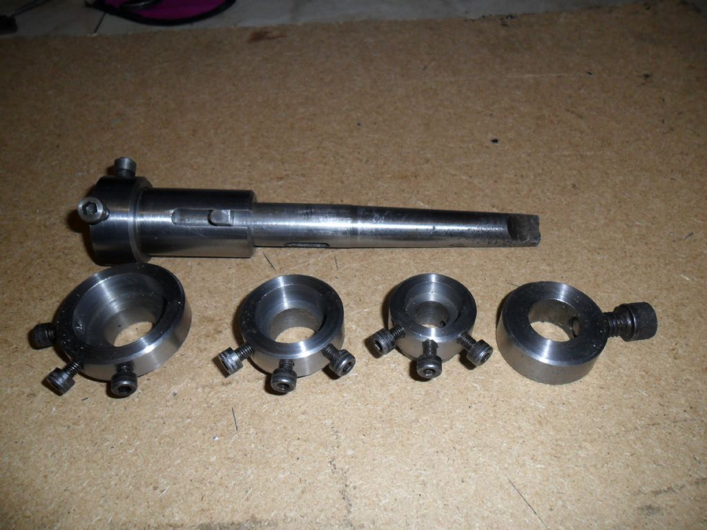

                              Hi
                              When you get your lathe. for a start you could make a tailstock sliding die holder like this . some turning drilling marking out etc for cutting metric threads BA whit ect various sizes . this would help you in future projects
                              Regards Nobby.

                                  Posted by Nobby on 09/10/2013 23:12:31:When you get your lathe. for a start you could make a tailstock sliding die holder like this .
                                  Funny, that was my first project when I bought my first lathe (an Edgar ) and still using it 40 years later.
                                  Russell
